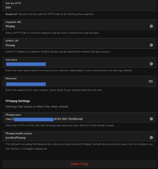

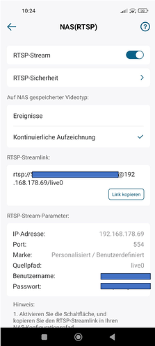

I have a problem with the binding “IPCamera Binding”. Everything works great, I set up my camera using the RTSP Stream Link but as soon as I save it toggles between online and offline with the error message “FFmpeg Snapshots Stopped: Check your camera can be reached.”
It’s the brand eufy, I’m really a little desperate and hope someone here can help me
On the openHAB side of things it’s much better to post the contents of the Code tab (where available) than screen shots.
When the camera is offline can you bring up the URL in a browser? When ever the binding loses a connection with the camera it goes offline and then attempts to connect again resulting in the Thing jumping between ONLINE and OFFLINE even though the stream itself is OFFLINE. I see this behavior when my WyzeBridge loses connection to the camera. It’s still able to respond to the requests from the IP Camera but it doesn’t have a video stream to serve.
The problem here is most likely that the eufy cameras are not providing a 24/7 stream. These cameras are event triggered so the stream is just starting when there is motion detected.
