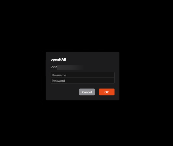

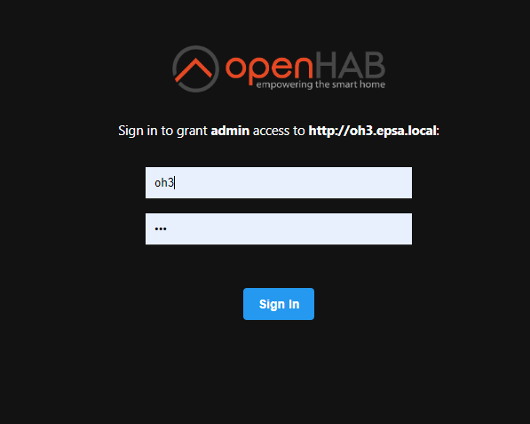

OpenHab shows me its beautiful window with a suggestion to log in
After successful login, when I click on the login icon (shield), it shows me a built-in browser window (Basic Auth) with a suggestion to log in again … after that, a new offer arrives to enter OpenHab through a regular authorization page, after a successful login, throws it out to the main page as an unauthorized user. But now, if I go to the section of the site through the address bar of the browser, I see that on some I am an Administrator, on some I am not an authorized user.

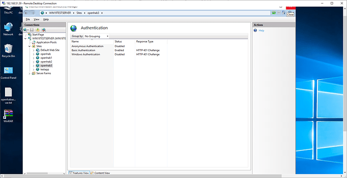

For testing:
  1. Created a Hyper-V virtual machine based on Windows Server 2022, turned off the firewall
  2. Deployed a clean OpenHab
  3. Added a user to Windows (user) and OpenHab (admin)
  4. Configured DNS (local network)
  5. Installed IIS (select all components + URLRewrite and requestrouter)

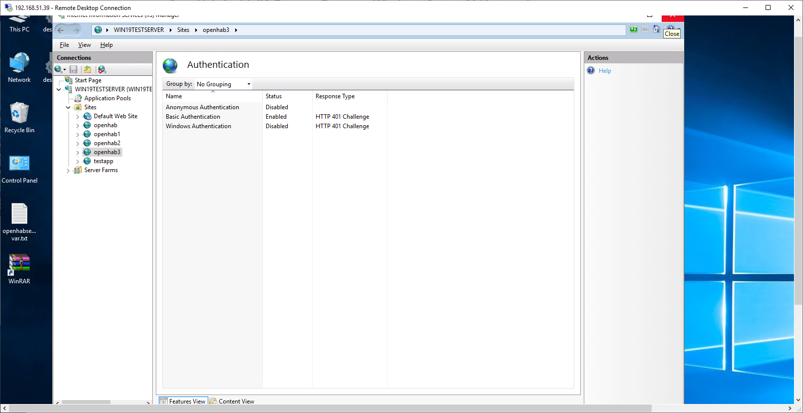

  6. Created a site (not SSL), Enable Basic Auth
  7. Enable ARP Proxy, made a reverse proxy for OpenHab (the config is specified)

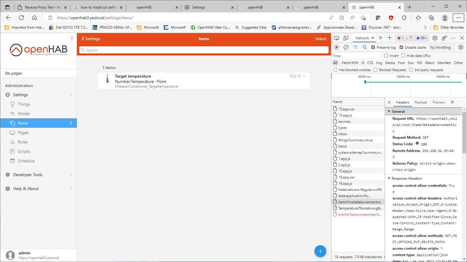

It allows me to enter the site through basic authentication…
But I still can’t log in to OpenHab (through the shield). The hub allows me to enter a name and password…
…and in response to login, it shows its main interface and the user is not authorized :frowning:
I’ve looked in wireshark and openhab logs and found nothing suspicious…

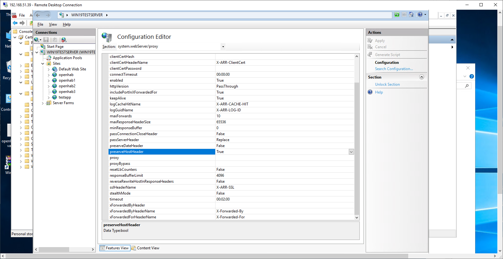

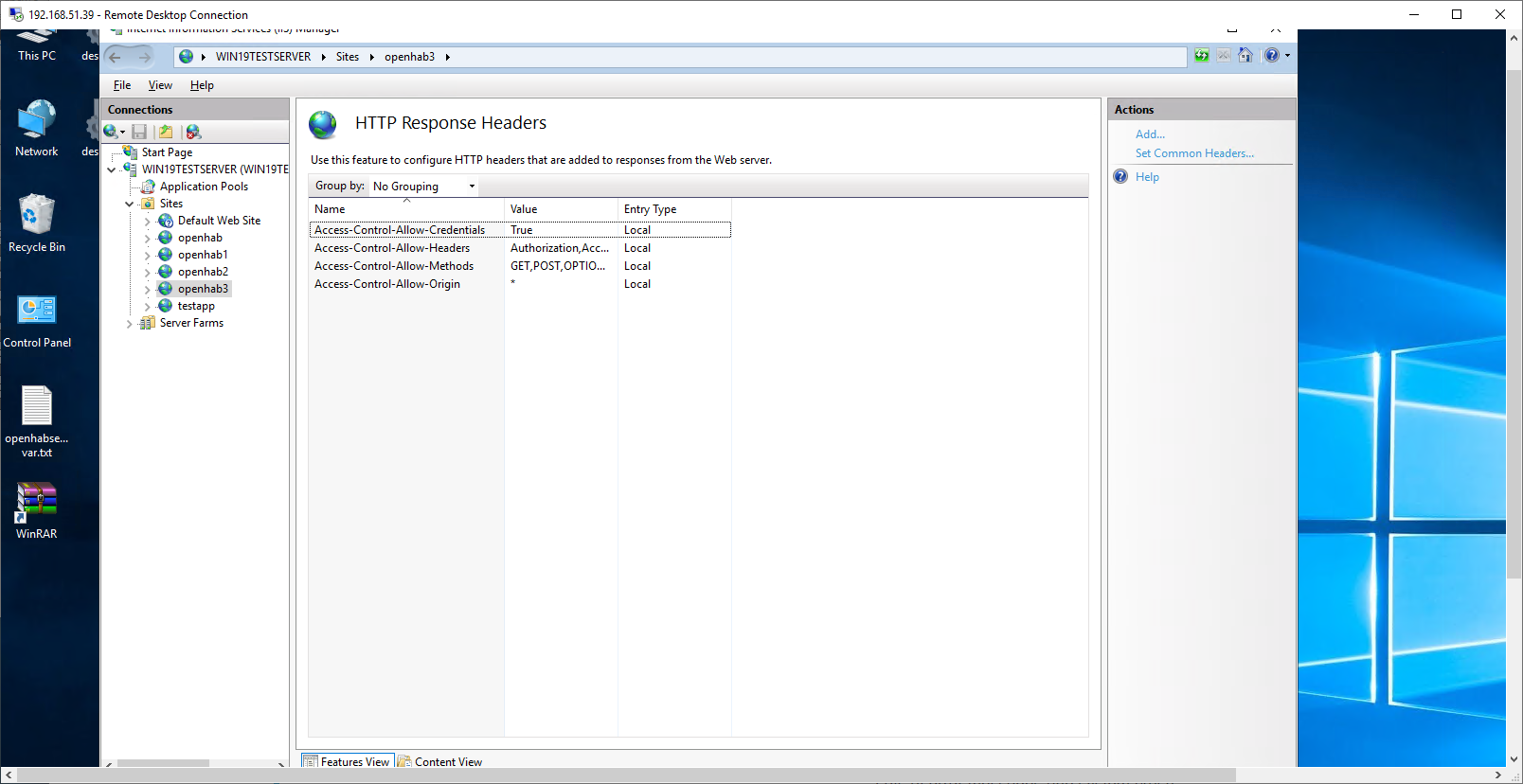

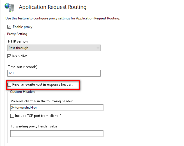

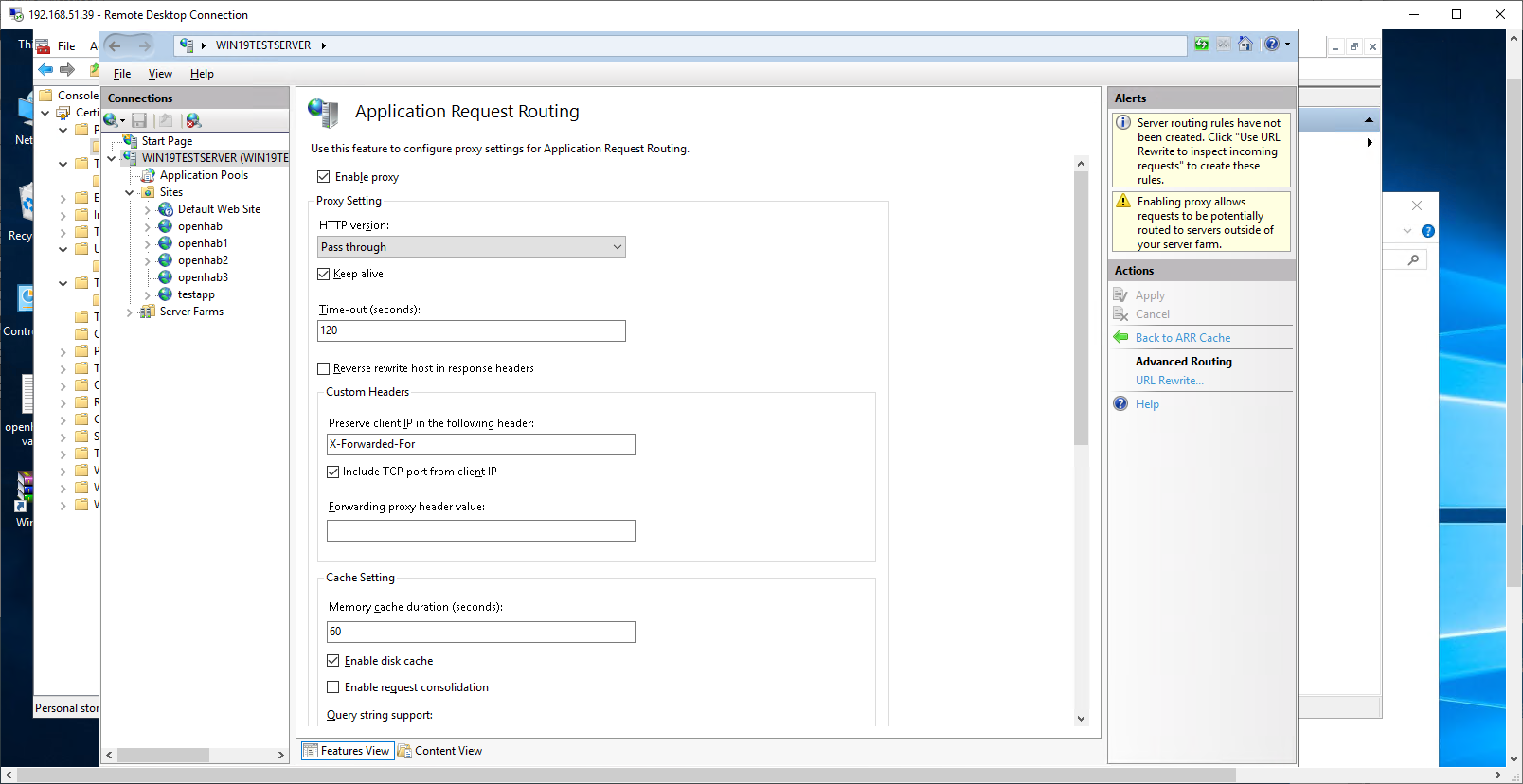

HI Max,
under server setting ARR Server Proxy settings did you uncheck Reverse rewrite host in response headers check box?
May also want to run this too.
%windir%\system32\inetsrv\appcmd.exe set config -section:system.webServer/proxy -preserveHostHeader:true /commit:apphost
BTW it is also Referenced in this stackoverflow discussion.
https://serverfault.com/questions/849064/prevent-arr-with-urlrewrite-from-re-writing-location-header-for-a-302-redirect

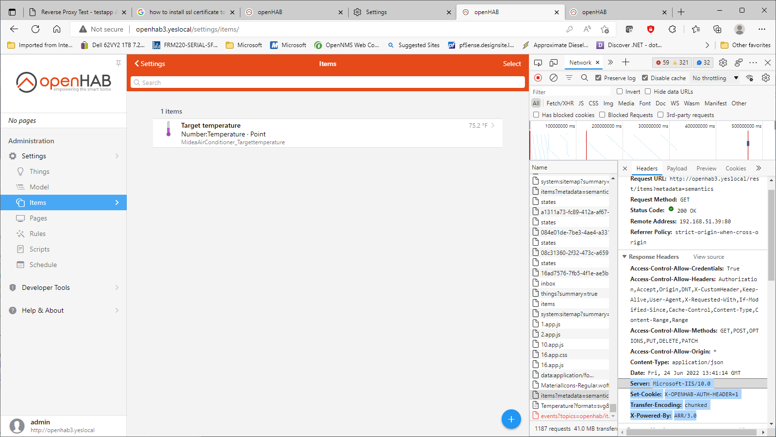

I checked my server 2019 and I have that unchecked and in my main config I do see where I had the value that this command line modified also set.
The only other one off settings that I had were these if that helps.
<system.web>
  • <customErrors mode="Off" />
  •  <httpRuntime requestPathInvalidCharacters="" />
  •  <authentication mode="Windows" />
    </system.web>
    I really could not recall why I added them so I did not mention them as they may have been tossed in during some of my initial playing around …
    so I did not want to imply they are really needed..

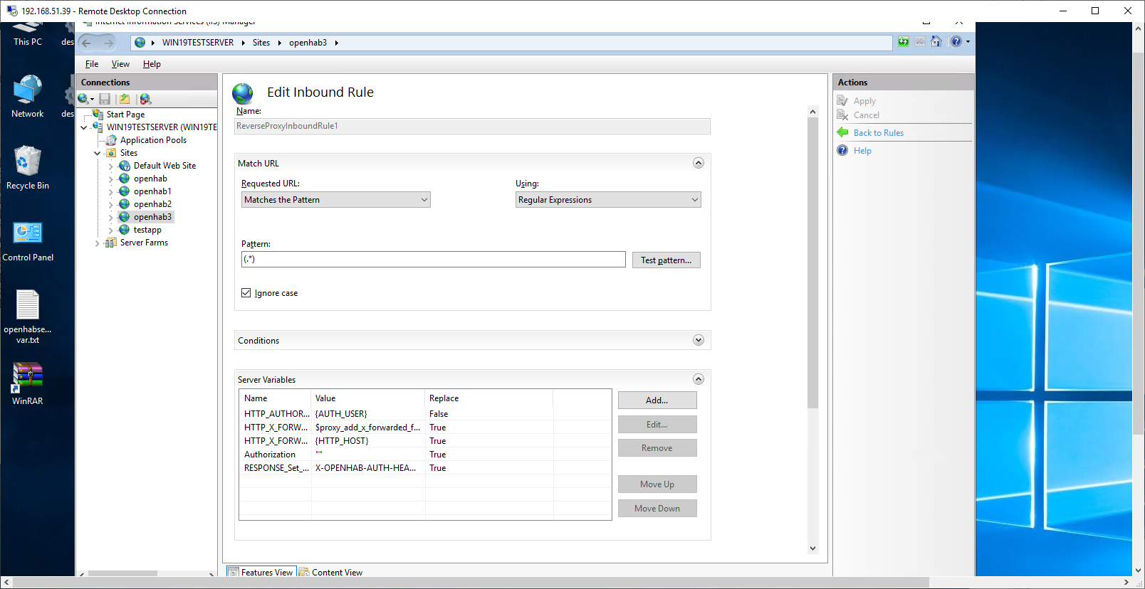

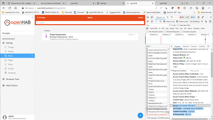

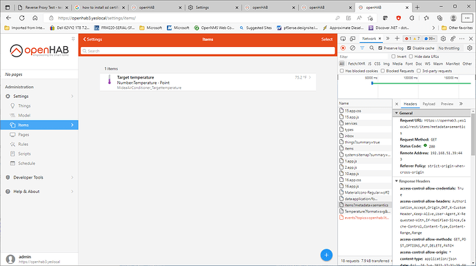

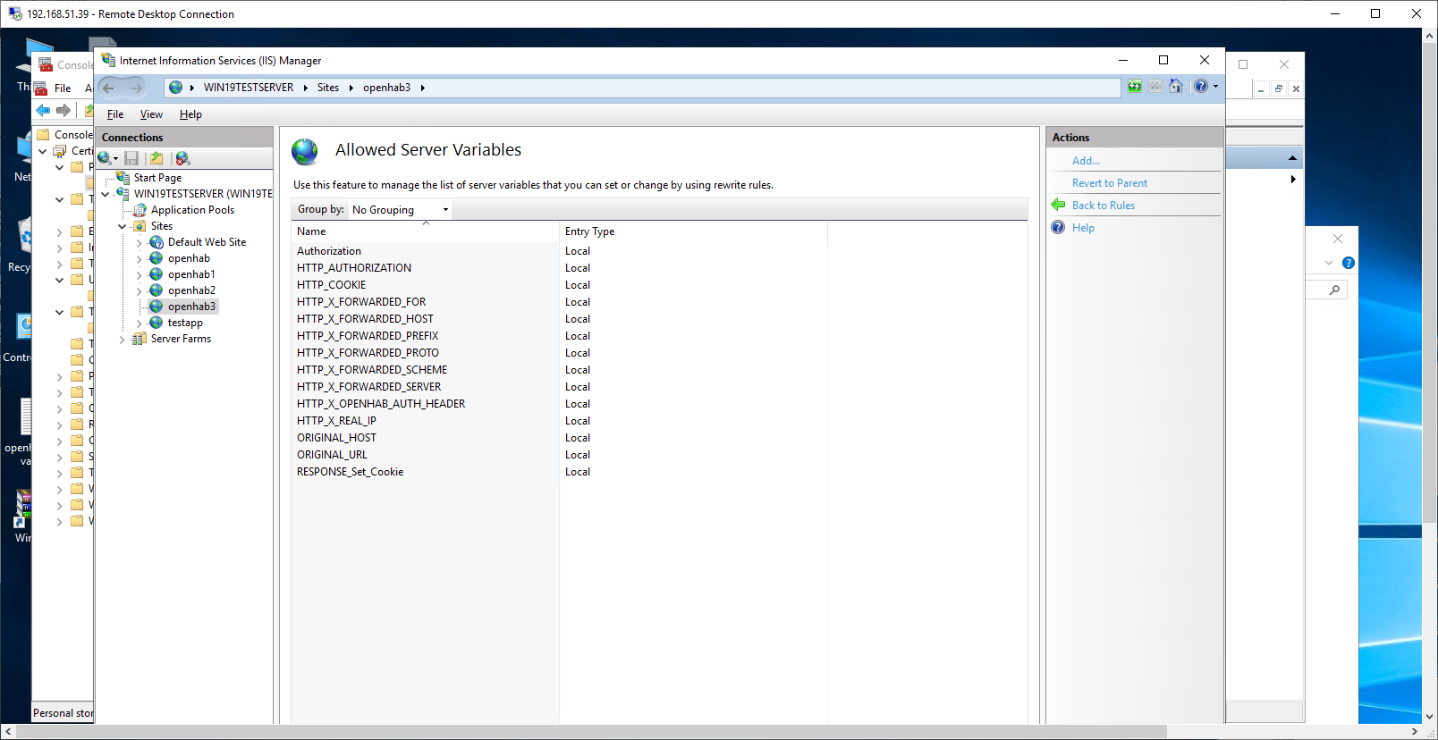

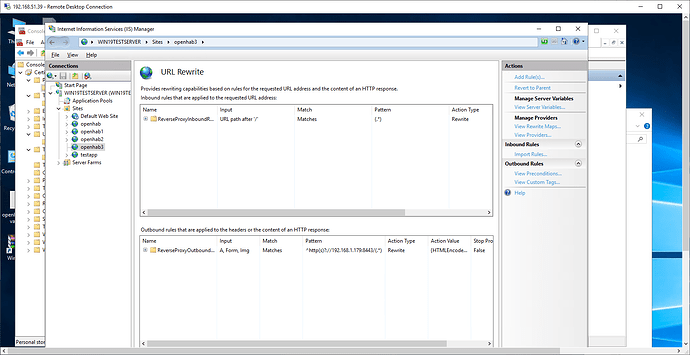

Hi Max,
after you change the ARR settings try adding these steps
in the inbound rule add this
<set name="RESPONSE_Set_Cookie" value="X-OPENHAB-AUTH-HEADER=1" />
in the server variables add this
<add name="RESPONSE_Set_Cookie" />

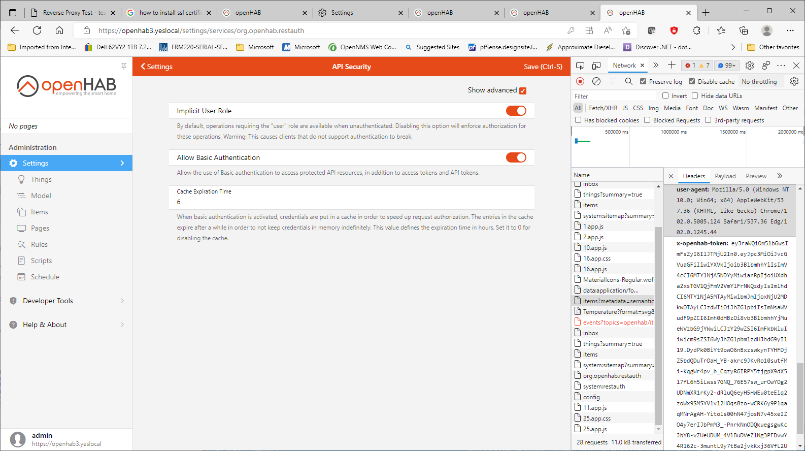

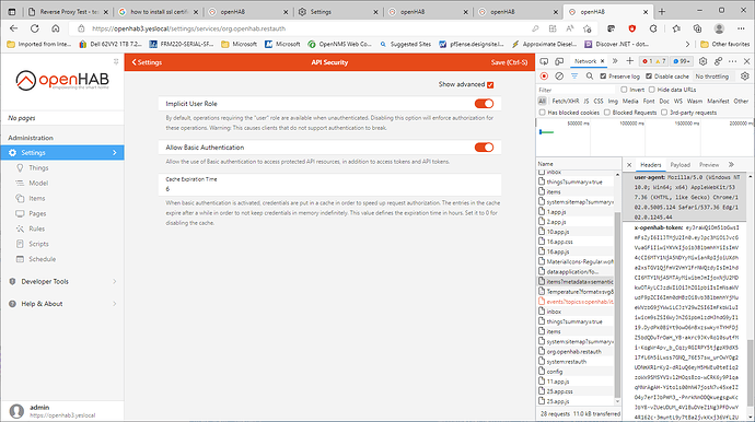

In Openhab under your settings and then API security
check advanced and then enable Allow basic authentication and save!
with those settings and the added steps I have mentioned I think you will get the behavior you want.
I have included this full web config as a reference not all is required but I think it gives you a better idea.

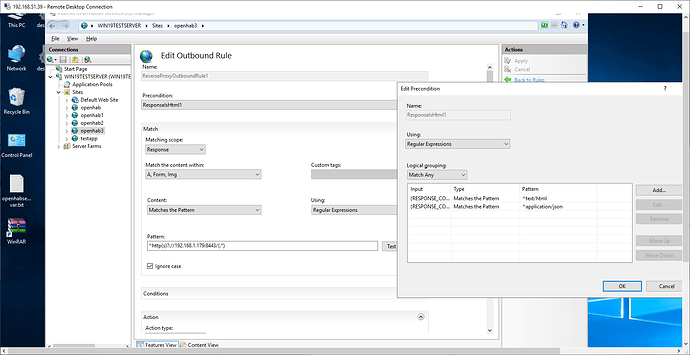

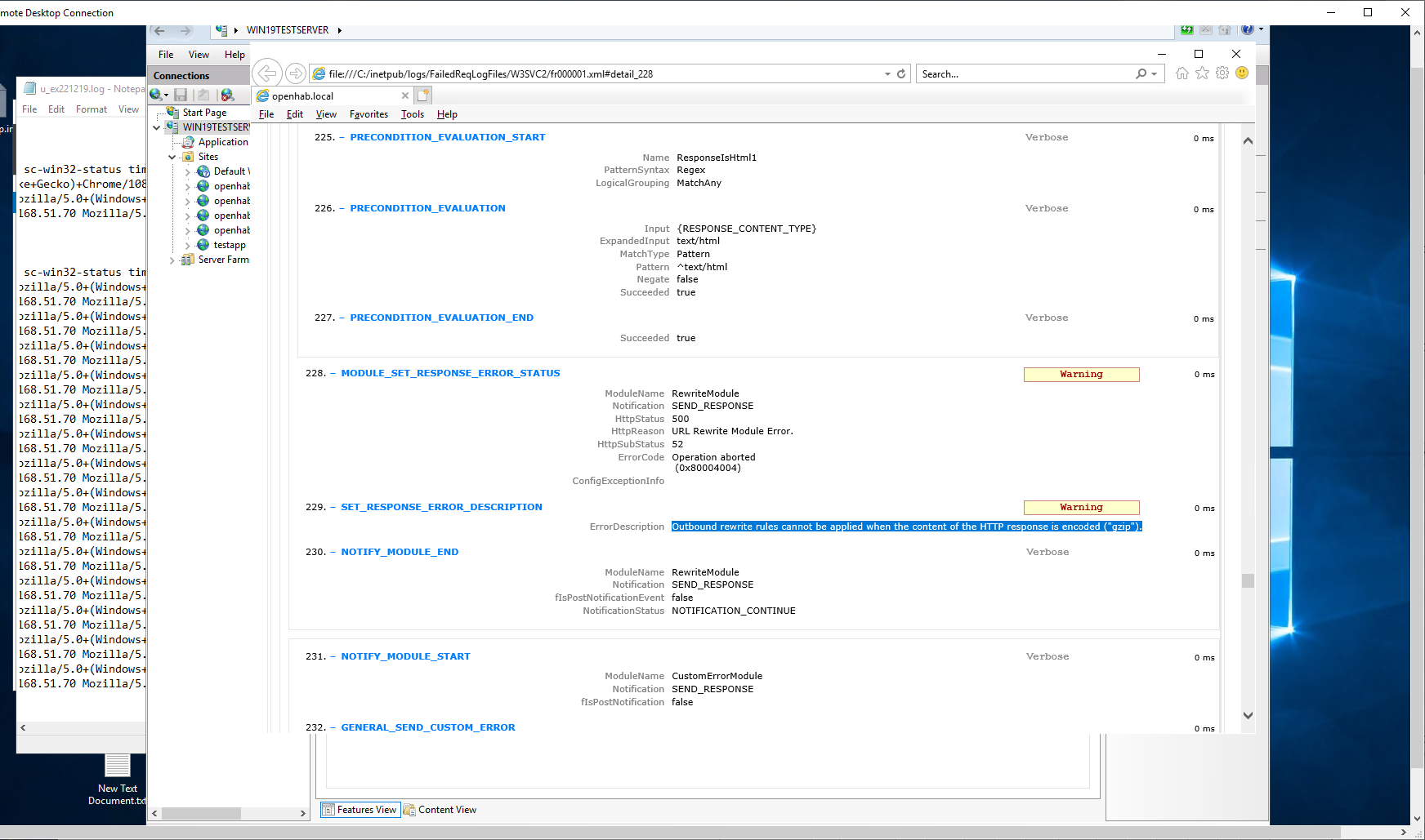

            <outboundRules>
                <rule name="ReverseProxyOutboundRule1" preCondition="ResponseIsHtml1" enabled="true">
                    <match filterByTags="A, Form, Img" pattern="^http(s)?://win19testserver.openhab2.nolocal:8080/(.*)" />
                    <action type="Rewrite" value="{HTMLEncode:{HTTP_REFERER}}" />
                </rule>
                <preConditions>
                    <preCondition name="ResponseIsHtml1" logicalGrouping="MatchAny">
                        <add input="{RESPONSE_CONTENT_TYPE}" pattern="^text/html" />
                        <add input="{RESPONSE_CONTENT_TYPE}" pattern="^application/json" />
                    </preCondition>
                </preConditions>
            </outboundRules>

Hi Max, sorry you are still having issues.
please review below
Request URL: http://openhab3.yeslocal/rest/items?metadata=semantics
Request Method: GET
Status Code: 200 OK
Remote Address: 192.168.51.39:80
Referrer Policy: strict-origin-when-cross-origin
Access-Control-Allow-Credentials: True
Access-Control-Allow-Headers: Authorization,Accept,Origin,DNT,X-CustomHeader,Keep-Alive,User-Agent,X-Requested-With,If-Modified-Since,Cache-Control,Content-Type,Content-Range,Range
Access-Control-Allow-Methods: GET,POST,OPTIONS,PUT,DELETE,PATCH
Access-Control-Allow-Origin: *
Content-Type: application/json
Date: Fri, 24 Jun 2022 13:41:14 GMT
Server: Microsoft-IIS/10.0
Set-Cookie: X-OPENHAB-AUTH-HEADER=1
Transfer-Encoding: chunked
X-Powered-By: ARR/3.0
Accept: application/json
Accept-Encoding: gzip, deflate
Accept-Language: en-US,en;q=0.9
Authorization: Basic YWRtaW46VGhpc2lzb3BlbmhhYg==
Cache-Control: no-cache
Connection: keep-alive
Cookie: X-OPENHAB-AUTH-HEADER=1; X-OPENHAB-AUTH-HEADER=1; X-OPENHAB-SESSIONID=06e693d0-2e78-416b-b226-09a60532aa2e
Host: openhab3.yeslocal
Pragma: no-cache
Referer: http://openhab3.yeslocal/settings/items/
User-Agent: Mozilla/5.0 (Windows NT 10.0; Win64; x64) AppleWebKit/537.36 (KHTML, like Gecko) Chrome/102.0.5005.124 Safari/537.36 Edg/102.0.1245.44
X-OPENHAB-TOKEN: eyJraWQiOm51bGwsImFsZyI6IlJTMjU2In0.eyJpc3MiOiJvcGVuaGFiIiwiYXVkIjoib3BlbmhhYiIsImV4cCI6MTY1NjA4MTE3NSwianRpIjoiMUNvcEp4RTlWalRXWjYyUHdSa0ViQSIsImlhdCI6MTY1NjA3NzU3NSwibmJmIjoxNjU2MDc3NDU1LCJzdWIiOiJhZG1pbiIsImNsaWVudF9pZCI6Imh0dHA6Ly9vcGVuaGFiMy55ZXNsb2NhbCIsInNjb3BlIjoiYWRtaW4iLCJyb2xlIjpbImFkbWluaXN0cmF0b3IiXX0.W5A2RF49Hv6mXBV9t4jXSGSws9jmCR62DtCpu44p6MBWDsrZLfUhcCPAZjgaROhJuSAo0gAQEVn0kOO7GJ8BeKNgKR3RUNGTg4kDh4g6owTy2JwU_uG4k7h4ezV2XO8cFiNPDS7bzhoG3OWTKmgMoHkepDpPRDzVCUjM3mki0ZyJtkOhM7vtE1xZ-RS821R1tv1brESxVxbYmo0XcfKDuk2bpFSsXyyKb3kon5ZICoJIy2vi6xpoKhBDszCLg2h2PMt3P5KX91t5rlthGXHxc3rD09Y7scxVJZenEh-eRmYkFbuURQTu9oPm8d3DKgYoYpq6wlAEk_he-JxPxsP8KA
X-Requested-With: XMLHttpRequest
and the config
<?xml version="1.0" encoding="UTF-8"?>
<configuration>
    <system.web>
       <httpRuntime requestPathInvalidCharacters="&lt;,>,%,&amp;,\,?" />
    </system.web>
    <system.webServer>
        <rewrite>
            <rules>
                <rule name="ReverseProxyInboundRule1" stopProcessing="true">
                    <match url="(.*)" />
                    <action type="Rewrite" url="https://192.168.1.179:8443/{R:1}" />

            <outboundRules>
                    <match filterByTags="A, Form, Img" pattern="^http(s)?://192.168.1.179:8443/(.*)" />
                </rule>
                <preConditions>
                    </preCondition>
                </preConditions>
            </outboundRules>

and here is the basic authorization settings
and the response headers

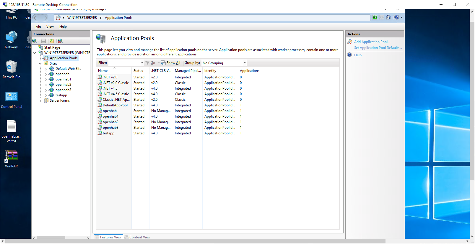

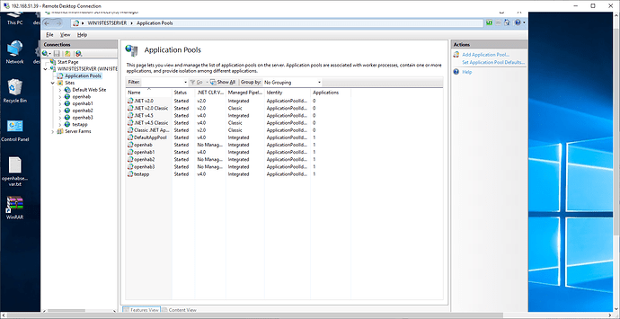

and the application pools
and of course the windows version.

Oh and in case your wondering here it is as a SSL connection.
and here is the header info
Request URL: https://openhab3.yeslocal/rest/items?metadata=semantics
Request Method: GET
Status Code: 200
Remote Address: 192.168.51.39:443
access-control-allow-credentials: True
access-control-allow-headers: Authorization,Accept,Origin,DNT,X-CustomHeader,Keep-Alive,User-Agent,X-Requested-With,If-Modified-Since,Cache-Control,Content-Type,Content-Range,Range
access-control-allow-methods: GET,POST,OPTIONS,PUT,DELETE,PATCH
access-control-allow-origin: *
content-type: application/json
date: Fri, 24 Jun 2022 17:31:35 GMT
server: Microsoft-IIS/10.0
set-cookie: X-OPENHAB-AUTH-HEADER=1
x-powered-by: ARR/3.0
:authority: openhab3.yeslocal
:method: GET
:path: /rest/items?metadata=semantics
:scheme: https
accept: application/json
accept-encoding: gzip, deflate, br
accept-language: en-US,en;q=0.9
authorization: Basic YWRtaW46VGhpc2lzb3BlbmhhYg==
cache-control: no-cache
cookie: X-OPENHAB-AUTH-HEADER=1; X-OPENHAB-AUTH-HEADER=1; X-OPENHAB-SESSIONID=c8691a6e-adf9-493d-b7d6-a039d0c856df
pragma: no-cache
referer: https://openhab3.yeslocal/settings/items/
sec-ch-ua: " Not A;Brand";v="99", "Chromium";v="102", "Microsoft Edge";v="102"
sec-ch-ua-mobile: ?0
sec-ch-ua-platform: "Windows"
sec-fetch-dest: empty
sec-fetch-mode: cors
sec-fetch-site: same-origin
user-agent: Mozilla/5.0 (Windows NT 10.0; Win64; x64) AppleWebKit/537.36 (KHTML, like Gecko) Chrome/102.0.5005.124 Safari/537.36 Edg/102.0.1245.44
x-openhab-token: eyJraWQiOm51bGwsImFsZyI6IlJTMjU2In0.eyJpc3MiOiJvcGVuaGFiIiwiYXVkIjoib3BlbmhhYiIsImV4cCI6MTY1NjA5NDYyMiwianRpIjoiUXdha2xsTGV1QjFmV2VmYlFrNWQzdyIsImlhdCI6MTY1NjA5MTAyMiwibmJmIjoxNjU2MDkwOTAyLCJzdWIiOiJhZG1pbiIsImNsaWVudF9pZCI6Imh0dHBzOi8vb3BlbmhhYjMueWVzbG9jYWwiLCJzY29wZSI6ImFkbWluIiwicm9sZSI6WyJhZG1pbmlzdHJhdG9yIl19.DydPk0BiYt9owO6nBxzswkynTYHFDjZ5bdQDuTrOaH_YB-akrc9JKvRo10sutfMi-KqgWr4pv_b_CqzyRGIRPY5tjgpX9dX5l7fL6h5iLwss7GNQ_76E57sw_urOwYOg2UDNmXR1rKy2-dRluQ6eyH5HWEu0teEiq2zoWx9SMSYV1vl2HOqs8zo-wCRK6y9P1qaqMNrAgAH-Yitols00hN47josN7v45xeIZO4y7erIJbPmM3_-PnrkNnODQkuegsgwKcJbY8-vZUeUDUM_4VlBuDVeZ1Ng3PFDvwY4R162c-3muntL9y7tBa2jvkKxj36VfL2Ukw2p6Yu4G08l95g
x-requested-with: XMLHttpRequest

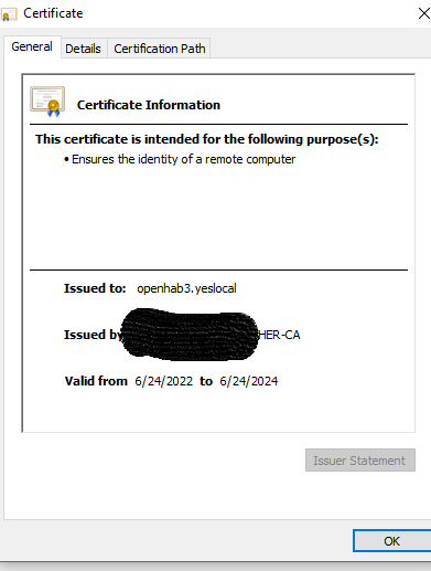

And here is the cert issued from a standalone windows CA

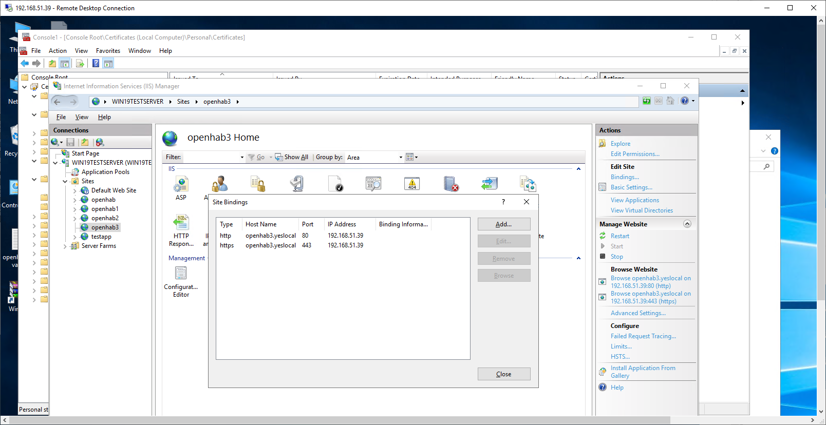

and here is the bindings in the windows 19 server
and here is the settings for urlrewrite
inbound rules
outbound rules
and here are the server variables
and here is ARR
and here is of the appconfig after running the command
So hopefully you can now clearly see it does work
And I am not really sure what you would want a dev to fix???
update: For completeness
Here is the setting change in Openhab

So as we not so quietly cussed at winders and IIS hopped into the IIS Mangler and turned on some tracing.

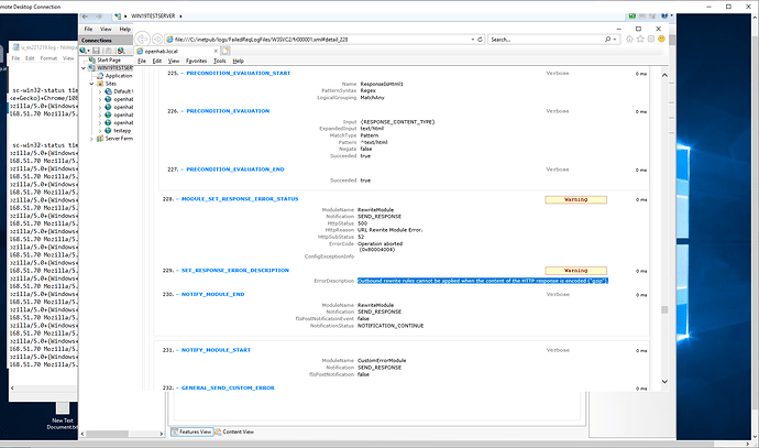

Quick hit and short review later we see it is a http 500.52
fast google and we hit the old Microsoft page and here it the fix.
Seems that the new version of 3.4 is using compression “gzip” and ARR 2.0 does not like that at all!.
So follow the link above to address the compression issue and you should be good to go.
