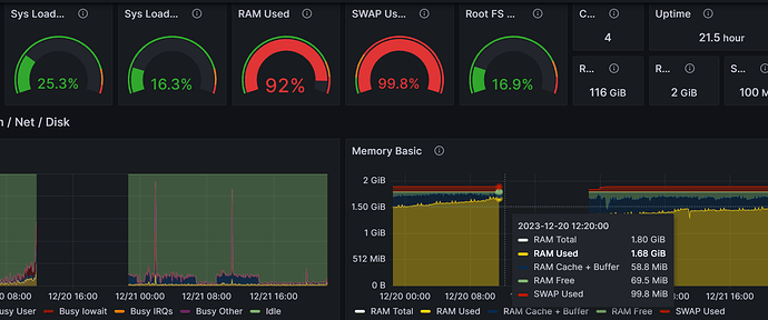

  • Issue of the topic: Openhab container crashes daily, i guess since the update to 4.0.4. I guess its starting with health check timeouts but dont know why.
Hello together,
for a long time im running openhab within a docker container. Since update 4.0.4 the container crashes daily (already mentioned in another post regarding how to get more log informations). For weeks im struggling how to solve this issue.
Whats happening:
After one or two days openhab stops working. When I try to ssh by hostname its not working anymore, after short time also ssh over IP is dead (could be another DNS issue regarting host/IP). At least ping the IP is still working (tested only once), but i cant access anything else of the web services like grafana, node-red … so I just unplug the pi and its keeps running for another day
Any ideas to this?
What i tried already:
I replaced the microSD card by a SSD storage and also tested another Pi4 without success.
As i now have quite a lot logging information I tried to understand whats going on but i cant as i dont understand some content / dont know where to start.
The Pi CPU statistics (CPU, memory, network traffic) looking quite normal when it crashes.

When i check the pi stats i also got a gap put before that gab it looks like ram slowly rises until around 12:20 crashed
and of cause in general the ram / swap are running out
Yes your dashboard shows it runs out of memory. If it starts killing processes due to lack of memory it will show up as “killed process” in the logging see also:
