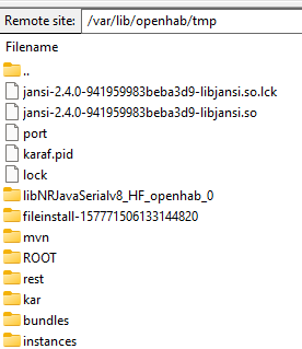

I had a look at the old thread where a problem was reported related to libjansi, too.
Rechecking it based on the message it indeed is different - I am sorry for that.
Nevertheless while in the old thread libjansi ( copy ) resp. it’s lock file couldn’t be created. The error message was about the lock file while this time it is about the lib.
Looking into the /var/lib/openhab/tmp folder during runtime of “openhab-cli console” a copy of libjansi should be created in the folder and the lock file.
Do you see these files ?
Running “ps -ef | grep jansi” you should see the path where libjansi is taken from ( source of copy ).
Is that the case ?
yes
openhabian@openhabian:/var/lib/openhab/tmp $ ls -lsh | grep jansi
 24K -rwxr--r-- 1 root    root     22K May  6 11:01 jansi-2.4.0-6a213f869437973-libjansi.so
   0 -rw-r--r-- 1 root    root       0 May  6 11:01 jansi-2.4.0-6a213f869437973-libjansi.so.lck

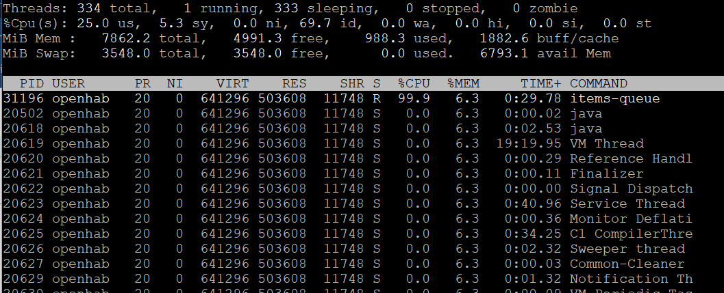

Have you checked your CPU usage? Those are usually the sorts of issues I see when OpenHAB has the CPU pegged for one reason or another.
as i wrote, every ~30h I have a restart of openhab.
and ~2h after restart I have a high CPU usage.
I already tried, what is written here:
But I’ve still a high CPU Usage after ~2-3h:
I have found the work around in Cody’s post here does NOT survive a restart of the host computer. Since you said:
I’m guessing you restart and the setting in the above post are lost and same thing happens. I’ve found that if I reset the safeCall to 100, openHAB runs for weeks without running away. Typical CPU usage is in the single digits.
When it pins the CPU, follow Cody’s advise in this post above and run top in the terminal, get the pid of openHAB then run
top -H -p <pid of openHAB >
with the pid you got from top where it says pid of openHAB above
Anyhow, having to log into the openHAB console and running the commands every time you restart the host is a pain. Cody mentioned that you could probably write a rule to reset the safeCall setting on a restart automatically but I don’t know how.

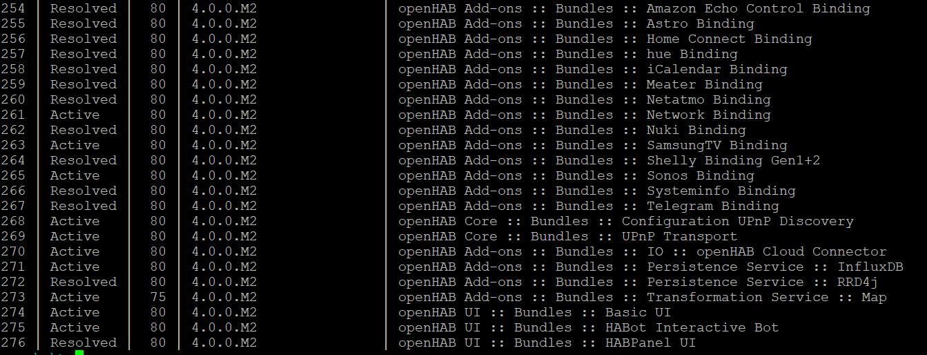

I have three startup errors that may be related to the “CPU usage and restart bug”.
Ignoring invalid configuration for pool 'felix.fileinstall.filename': file:/var/lib/openhab/etc/org.openhab.threadpool.cfg - value must be an integer
The transformation add-on 'javascript' does not exist - ignoring it.
I’ve have to restart this bundles after each restart of OH manually:
You should fix 1 and can ignore 2.
