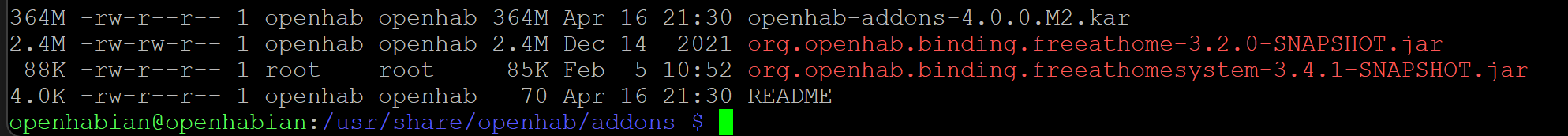

I’ve just updated to Openhab 4.0 M2 from Openhab 3.
But I can’t get the Samsung binding to work.
have a look at the last line of the logs …org.openhab.binding.samsungtv_3.3.0.202112301538…
was the binding installed correctly? Because the version is still 3.3.x

Now I’ve removed the Samsung Binding Beta before upgrading to 4.0 M2.
After upgrading, I installed the Samsung Binding (not Beta, but the official) and now everthing concerning Samsung works.

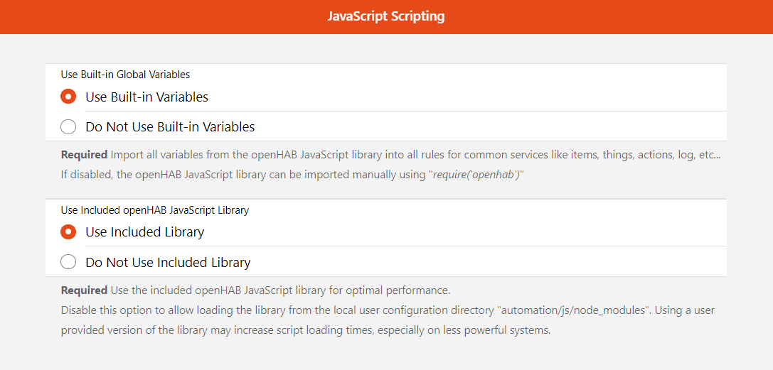

I have one question regarding the removal of NashornJS, just to make sure I undestand it correctly.
I have several ECMA-2021 Edition 11 Scripts. (type: application/javascript;version=ECMAScript-2021)
For this scripts, do I have to switch the type to 5.1 and install the Nashorn Addon or should they run without issues after upgrade to OH4?
As part of the upgrade to OH 4 it should change the mime type accordingly. If not, you can manually change the type to application/javascript. It is now Nashorn that will have the non-standard mime type. I believe those should be application/javascript;version=ECMAScript-5.1 or something like that.
FWIW I have most of my rules of type application/javascript;version=ECMAScript-2021 from 3.x and they all seemed to continue to work without changing the type to remove the explicit version so I’m not sure if there’s a downside from leaving it but new java 11 rules should probably just be application/javascript
