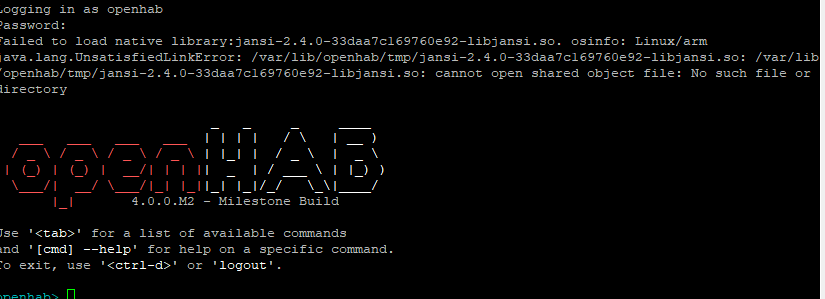

I get a message when I access openhab-cli console on 4.0M2 (upgraded today from 3.4.2).
Failed to load native library:jansi-2.4.0-33daa7c169760e92-libjansi.so. osinfo: Linux/arm
java.lang.UnsatisfiedLinkError: /var/lib/openhab/tmp/jansi-2.4.0-33daa7c169760e92-libjansi.so: /var/lib/openhab/tmp/jansi-2.4.0-33daa7c169760e92-libjansi.so: cannot open shared object file: No such file or directory
It happens right after I enter “habopen”
I think this is just a timing issue because everything works ok and I can see that the files referenced are created. They also go away neatly when the session is closed.

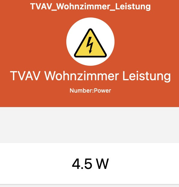

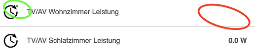

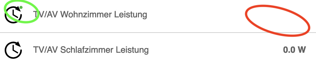

Using AVM Dect devices, most of them type 200, in BasicUI some power values are shown, some not although identical defined:
Two outlets, one is active (green dot within the green circle) not showing any power consumption, although it should. The other one showing correctly a value of 0 W.
The item works correct as shown in the item definition panel:
I can’t find any error in the definition, and all worked fine on the last OH 3 release.
Now running on
