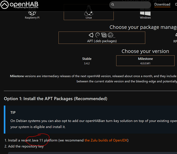

openHAB 4.0 Milestone discussion
https://www.openhab.org/download/
The same for all other OS version, with Milestone 4.0.0M1 it says: install Java 11!
Yepp, that’s wrong. For snapshot, though, it’s correct.
I’ve opened an issue Downloads Page for OH 4 Milestone still say to install Java 11 · Issue #400 · openhab/openhab-website · GitHub but don’t know enough about how the website is built to figure out where to make the change. So I need to await instructions or hope someone who knows Vue can figure out what to change where.
I figured out where the change needs to be made but need to study the code a bit to figure out what to change so it shows the right thing for milestones.

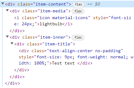

I think there was change within 4.0.0.M2 for custom widgets if you are using the component “f7-list-item”
Before the relevant “slots” where “media” and “text”, but “text” has to be “title” now.
Everything else can be kept as before.
Further investigations later I think that there is a bug in OH4. The slot “text” should work but doesn’t. It seems that it is thrown away during parsing.
Following widget code for a f7-list-item
                - component: f7-list-item
                    class: no-padding
                    noChevron: true
                    media:
                      - component: oh-icon
                          icon: =props.icon1
                          style:
                            font-size: "=(props.size1 === undefined) ? '24px' : '24px'"
                    text:
                      - component: Label
                          class: text-align-center no-padding
                          style:
                            font-size: "=(props.size1 === undefined) ? '24px' : props.size1"
                            font-weight: normal
                            width: 100%
                          text: =@props.item1
results in following HTML code:
But I think it should like this snippet for “title” which gets transferred to “item-title” class.
Seems that the “text” option is not tranferred to HTML.

There was a change to now correctly pass the slot names down to the component. You can consider the old implementation as a bug, the new implementation is correct.
The text slot is „thrown away“ during parsing because it is only supported for media list, see the Framework7 docs: List Item Vue Component | Framework7 Vue Documentation.
