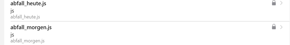

Im using javascript transformations in my OH 3.4.4 environment:
Will they still work?
You have to install one of the JS Scripting add-ons. I recommend not installing the Nashorn one and instead install the GraalVM one.
I searched for GraalVM, but didn’t find a addon:
How can I install GraalVM?
If I look for “java” i find:
I currently have javascript transformations:
e.g.
will they work “automatically” after I install GraalVM or do I have to change something?
Thanks for your help!
