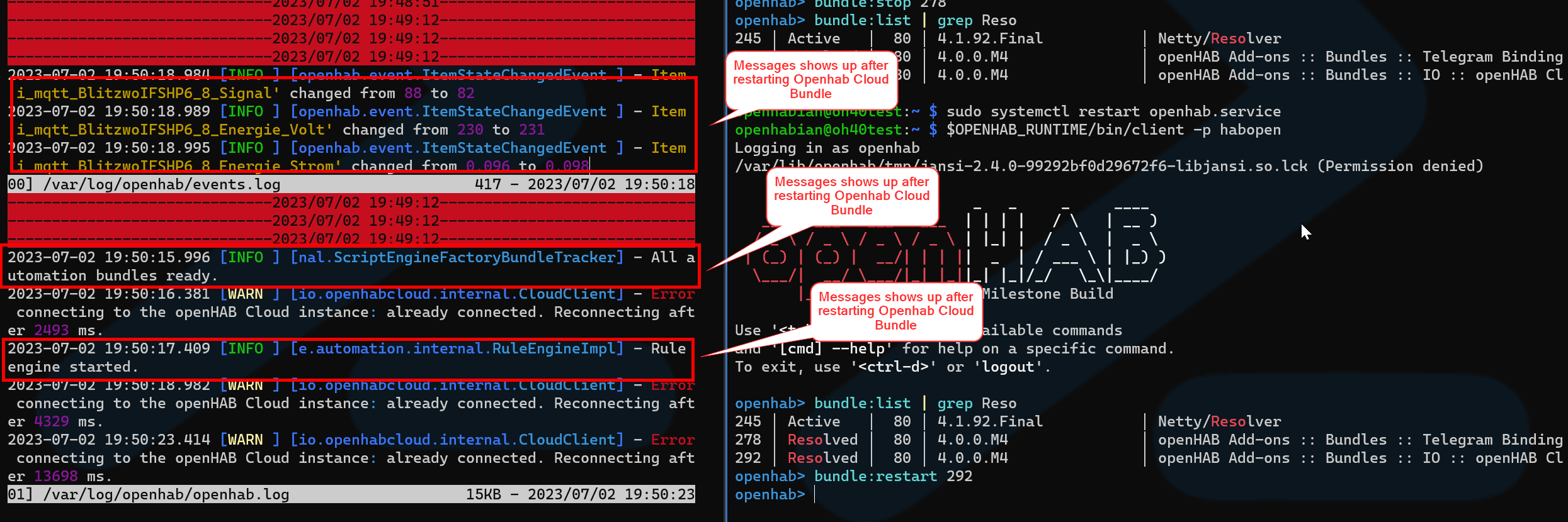

I figured out more.
I stopped the Telegram and Openhab Cloud Bundle, as it is causing trouble with my production system.
openhab> bundle:list | grep Reso
245 │ Active   │  80 │ 4.1.92.Final           │ Netty/Resolver
278 │ Resolved │  80 │ 4.0.0.M4               │ openHAB Add-ons :: Bundles :: Telegram Binding
292 │ Resolved │  80 │ 4.0.0.M4               │ openHAB Add-ons :: Bundles :: IO :: openHAB Cl
openhab>
If I restart Openhab Cloud bundles in console, the system remains startup and start’s correctly.
That’s really a strange behaviour.
Screenshot after restarting OH 4.0.0M4:
Restarting Openhab Cloud Bundle:
Afterwards it looks like OH 4.0.0M4 is operating normal.
(Rule engine is working and status updates for items are received.)
