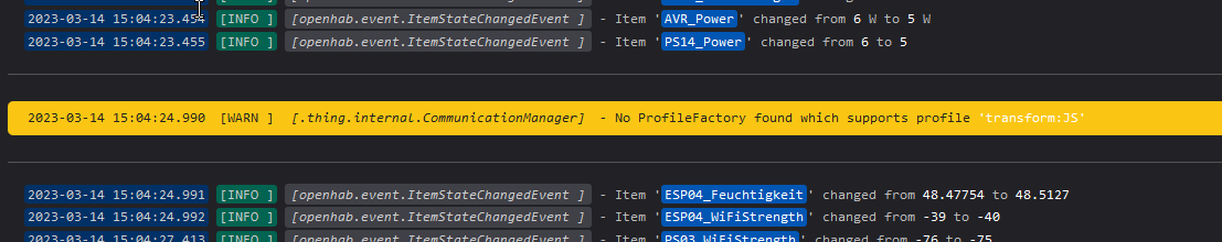

Since the update i get the following Warning every ~3seconds in my Logs:
2023-03-14 15:15:50.186 [WARN ] [.thing.internal.CommunicationManager] - No ProfileFactory found which supports profile ‘transform:JS’
Restarted, cleaned cache.. how do i find the source of that warning?
I dont even know, where i probably use the “transform:JS” mapping (?)
The JS transformation is no longer supported. You have a Profile defined on at least one Item (maybe PS14_Power or ESP04_Feuchigkeit given the logs, or maybe some other Item that isn’t updating because of this problem) and this Profile is using the JS transformation. You’ll need to find it (in a pinch you can search through $OH_USERDATA/jsondb/org.openhab.core.thing.link.ItemChannelLink.json for “transform:JS”).
