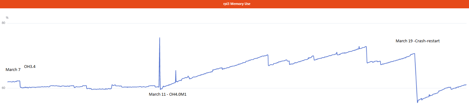

A little concerned about the memory use of OH4.0M1. I’m probably going to have to revert back because this is way beyond my skills, but thought I should report. I have very basic Rpi3b with zwave, mail and astro bindings. 29 things, 84 items, 1 page, 25 rules (DSL). Zram is installed. It is a remote system for my Rpi4 that has all the rules and additional bindings, pages, etc. I use this system_sensors tool to report. It was very stable prior to OH4.0M1 (only last 4 days on OH3.4 shown), then shows a steady rise over time with OH4M1 and then crashed 8 days later. The crash report is attached (it is too much information for me).
hs_err_pid7310.log (217.1 KB)
Only zwave, astro and mail? No rules?
I’ll add that (25 rules), most are on the Rpi4.
But no rules on the system that runs OH4.M1?
