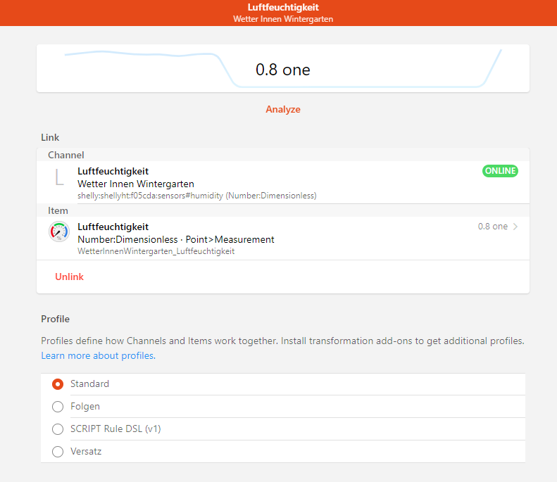

I have the same units problem, with my Shelly HT’s. (HT and HT Plus). The temperature value is shown currect with e.g. 25.0 degrees. But the humidity is shown in “0.6 one” and not in 60% as in the 3.4.4 Openhabian version it was in past.
Is this now a principle problem, or only one in the Shelly binding?
For humidity or more generally for all Number:dimensionless items, you need to set a unit to your item, that is adding unit=“%”.

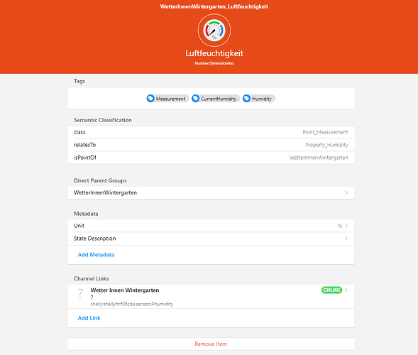

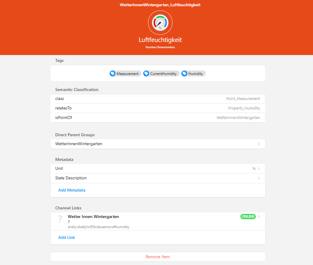

When adding now the “%” to the metadata under unit, I get this error:
Can you show us your item definition?
