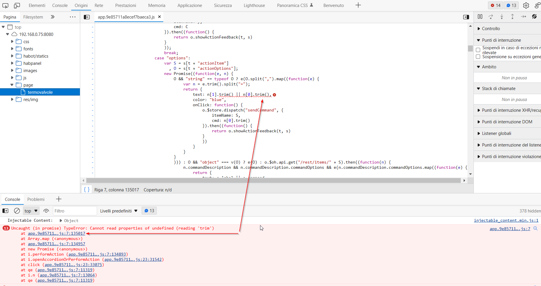

Dear All
are there any issues concerning options items?

this line actionOptions: off,heat doesn’t work anymore, when clicked the options aren’t shown;
on stable version there are no issue
I try also inserting a option item manually in design mode in a new page (no widget) and it doesn’t work.
Maybe I miss some reccomanded configurations?

Option actions should continue to work. Are there any errors shown on the browser console when you click on the widget?
JustinG
this one
OK, that’s a newly introduced regression from this PR:
Edit:
Here’s the issue
