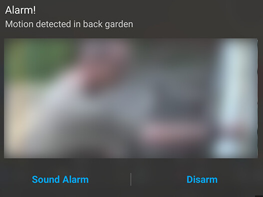

I’m sorry, maybe I did not express myself clearly enough. I’m not using integrated notifications of the openhab app as the functionality is limited. I am using telegram right now.
I’m proposing to extend the basic notification functionality of the openhab mobile app notifications to allow something like this:
So basically an image and response action as part of the same notification.
If that is possible and I’m not aware, please point me to the right resource as I was not able to find it in documentation or examples showing how this works.
You’re making us victim to your personal XY problem here: you want others to implement a specific solution to a problem that easier and quicker can be solved with a different approach.
It does not have to be a single notfication.
There’s nothing wrong with replacing a single notification with a multi-step dialogue process, and single steps are not necessarily client-server communication messages.
I already did: implement this on the server side, inside a widget.
You can implement any sort of dialogue there.
The initial openhab app notification can contain the URL to point at the widget for further processing.
And no, there’s no specific tutorial or other resource I know of other than all those on widgets on the forum and yes, it ain’t plug’n’play. But the prerequisites are all there in OH3, including docs.
So start now yourself and share your solution when you’ve managed to get it working.
I’m sorry you feel this way. I just gave a recommendation for improvement of the solution. If you feel that this is not beneficial to openhab that is alright.
So you are saying its possible but it is not documented. That makes it rather difficult for users to integrate.
I’m not sure if I even know what type of widget you are talking about, mainui widget, habpanel widget, or something completely else. In any case, this would require development effort by the user and cannot be considered a ready to use Feature of the solution.
