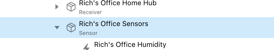

But look at the semantic model view:
Having a NULL value here is really bad looking, and I don’t understand why it shouldn’t be possible to have that “Equipment” group get a value that is the copy of one of its members.

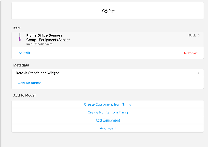

If your concern is entirely the visual effect, then it is possible to make that equipment look however you want. That is what the standalone widget metadata does. You can make a widget that shows the state of any item from within the equipment, or any two, or makes each item’s state dance across the screen one at a time (note: not an actual recommendation). Once you create that widget you can add it to each equipment group with just about the smae amount of effort as adding an aggregation function (possibly even less). Bonus: if you add it to the marketplace it becomes a nearly 0 code option for you and everyone else!
The best part is, once you create the standalone widget that you want, you can then put that anywhere else too. Not only will it show up on the model view, you can add it to any user created page with just a few clicks.
But it is, in the end, just an appearance change it doesn’t in any way involve changing the state of the group.
I think this may be where the philosophical disagreement is. We can’t fault your opinion, it’s your opinion after all. That model page you are showing, however, really is a very deep level. That is not intended to be a user UI page, it won’t ever work well as a user UI page. It is a system administration page. For that reason, most users aren’t concerned about if the null is ugly, but want the most accurate information.
One of the amazing things about MainUI though, is that you have enough control to pretty easily change that for yourself so that it matches what you want to see, and no major change in the underlying group code is required. This isn’t saying that your wish-list item isn’t worthy; this is saying that you can have you wish right now! No wishing necessary, you can just go out and do it.
OK, so set the State Description Pattern on that Item to ' ' and the NULL goes away. I could see how setting that pattern by default when creating Location and Equipment would be a good idea. But note, the state shown for any Item on that page represents the state when the page was loaded. Neither the Model nor the Items page gets updated with Item events.
Or set a default stand alone widget metadata that represents the entire equipment (or just one member, what ever you want).

  1. If you don’t want to see anything at all, set the State Description pattern to an empty string or space which suppresses the state in MainUI in the Model and Items page (the state isn’t rendered for these Items anywhere else anyway)
    a. I could see an issue to have this created/set by default for all Locations and Groups created through MainUI. I’d support that though I’m not sure it’s feasible.

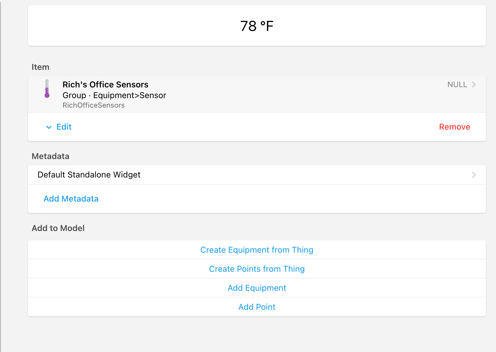

  2. If you want to see something add a “default stand alone widget” to the Location/Equipment where you can show as much or as little of the states and controls as you want. So if you want to just show the temperature for the equipment, it’s very simple.
First navigate to the Equipment Item
Then choose “Add metadata” and “Default Stand Alone Widget”
Change the Item to the temperature Item that’s a member of that Group.
Done.
Like @JustinG says, that’s as easy if not easier than setting a Group aggregation function. Only it’s even more flexible because you can configure that widget to be as much or as little as you want it to be.
