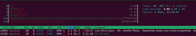

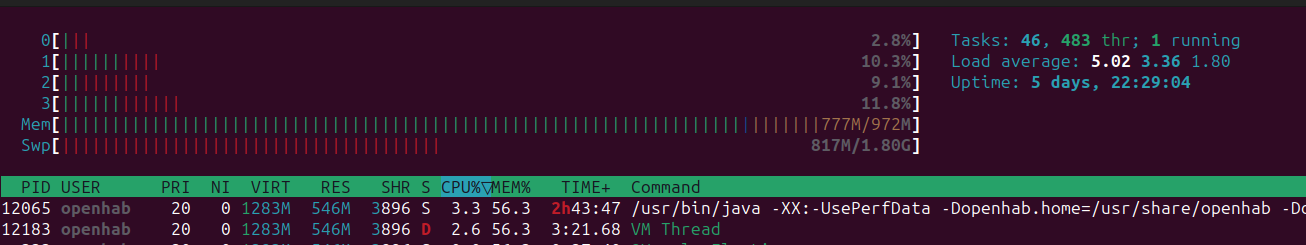

OK this say htop and i don’t have access to UI. Website doesn’t open.

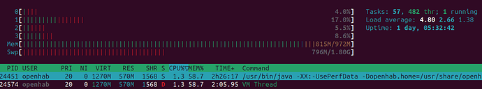

Before this happens:
grafik
VM Thread is gone from htop list and everything works fine… After 5 to 10 min…
But don’t have access to ui and get a blank white page.

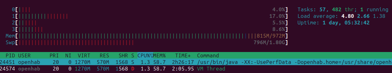

VM Thread stay at second position and nothing is working. CPU is low. But I can’t access UI. That happens if I develop a blockly rule or at this moment where I had uninstalled a binding and try to add a new binding. That takes 5-10min and then everything is fine. So why blocked VM Thread other processes?

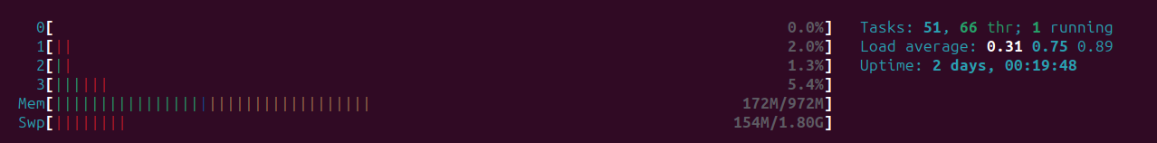

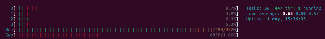

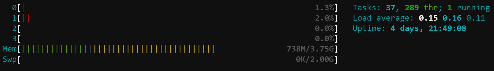

One thing I notice in all your htop screenshots is that your memory usage is really high and, more importantly, your swap usage is pretty high as well. I wonder if you simply do not have enough resources.
I’m guessing this an an RPi 3? With the additional memory requirement for Java 17 maybe an RPi 3 is no longer sufficient to run openHAB.
All things considered, you shouldn’t be seeing any swap in use, let along almost half. When ever a process starts using swap, you can expect your machine to slow down to a crawl.
That is what I’m thinking, the little Pi is just getting swamped

I just like to add my memory consumption which is almost the same than your system:
16.2% of 4GB =~600MB
Your system: 56% of 1GB = ~600MB
At least we can say that you and me have no problem or we have the same problem :slight_smile:
Would be interesting to know how much memory OH3.4 consumed.

Yes sure. After update to 4.0.2-1 it looks more stable as before. But it would be nice to find the hick up also when I remove bindings and reinstall them. The DenonMarantz problem is yet fixed also what I get via SYSlog, but Openhab do the same issue after time.
No Openhab is running:
Openhab starts:
2023-08-18 15:48:45.958 [WARN ] [core.karaf.internal.FeatureInstaller] - The transformation add-on 'javascript' does not exist - ignoring it.
Openhab without Rule engine started:
Openhab with Rule engine started:
How it is when it’s normal you can see above.
The UI is working after start without issue and running very fast.
