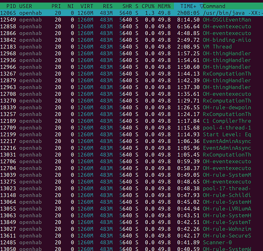

I must reopen this thread… After hours of running, openhab get slower and slower. All http request will stop after a while and openhab itself isn’t really crashing, but stop to handle all requests. Logs will be filled with that what you can see above. I removed MIIO and SYKQ Binding at the moment, to keep clear that there isn’t any issues with that bindings. For me they look not stable, but they can’t!
What i observed is that many rules stay on running. Rules will be run slow and some rules will go to false or i get a message that the rule is running.
I changed the header to unstable, 'cause it isn’t really crashing.

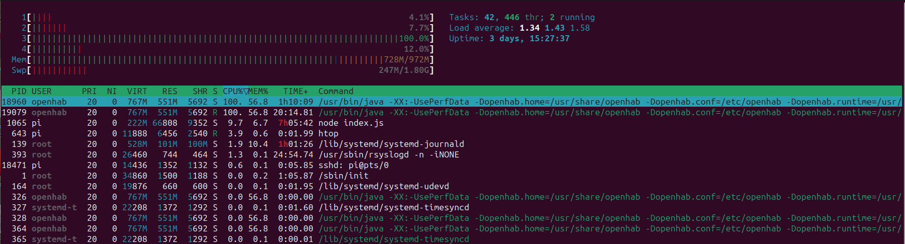

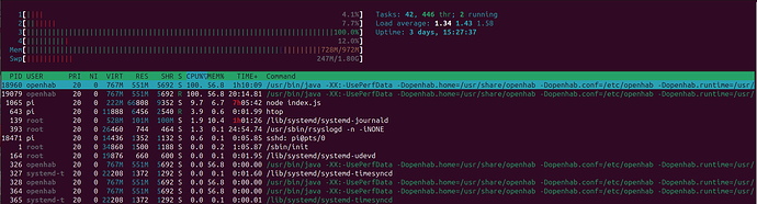

How do CPU load and memory usage behave over time ?
How does your system configuration look like ( hardware, OS, memory ) ?
Raspberry Pi 3 with SSD

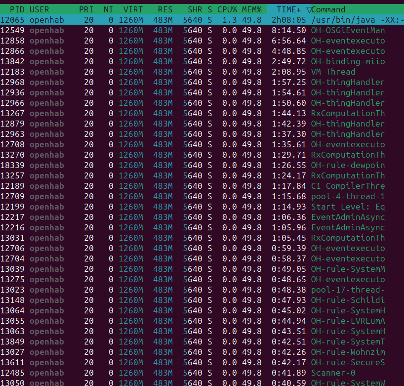

At the moment I can show you only the normal working state:

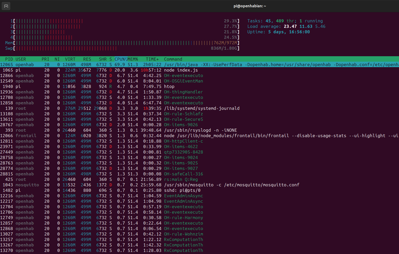

After installing SKYQ and MIIO Binding i get this problem back:
CPU load is extrem high on one CPU. And it’s hopping from one to other CPU. I will install now the CPU fix.
Duno if the fix is working, but Openhab is restarting by itself. Sometimes I got hick ups like this:

If you still have CPU issues with the fix, configure htop to show custom thread names so it is more clear what is consuming your CPU, see:
https://stackoverflow.com/a/21511530
You can also do this with top as described in the FAQ:
That’s strange… OH stuck i don’t get acces via http to basic ui and so many different process are open and CPU isn’t really high…
Edit: Wondering that there so many rules will be showed with htop but not running… But the running time of some rules confuses me really. If a rule runs 25-50 sec so what happens if you have 2,3 or more rules they are running in same time.
Each rule has it’s very own thread. That thread will only be shown as running when the rule is actively executing. If you have 2+ rules running at the same time, each thread should be shown running independently.
