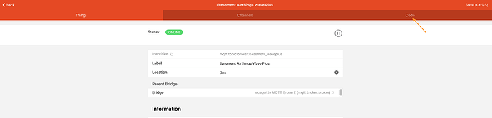

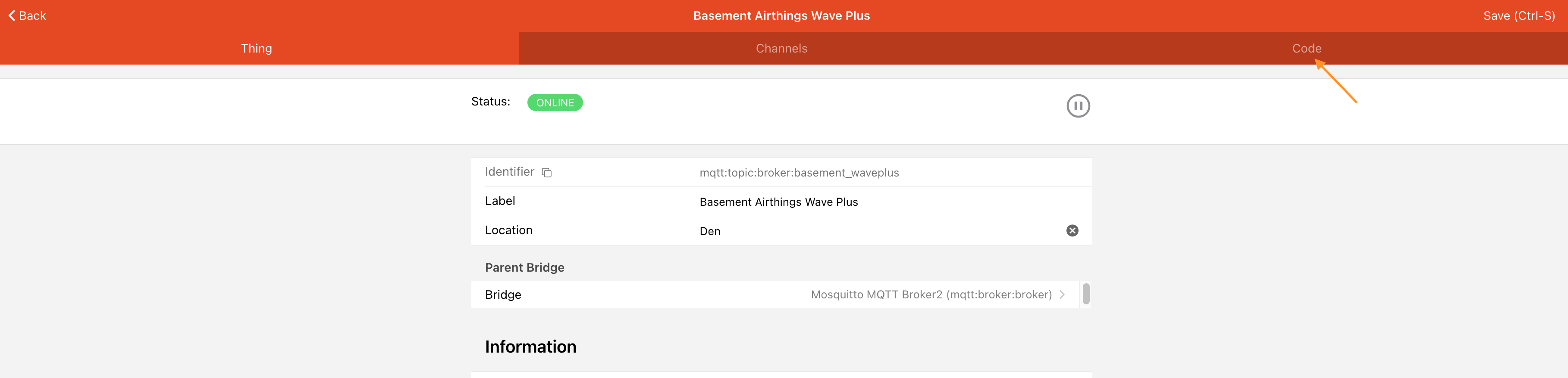

The general process using the UI is:
  1. Open the “Code” tab for the Thing
  2. Copy the YAML you find there to the clipboard after “label” (the second line)
  3. Create a new Generic MQTT Thing
  4. Open the “Code” tab for the newly configured Thing and paste the contents over everything after “label”.
  5. Modify what ever needs to be modified.
