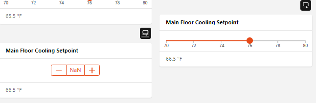

I’ll give it a test in a minute. Do I need to stop the existing UI bundle before adding the new one to the addons? I have a personal rule (learned from experience) to not have two of the same bundles running?
Also this sounds promising. Before I saw your message I thought to create a stepper card when everything running. (I had deleted them). It was still a problem.
        - component: oh-stepper-card
            item: MainThermostat14_SetpointCooling
            min: 70
            max: 80
            step: 1
            label: true
            scale: true
            title: Main Floor Cooling Setpoint
            footer: =items.MainThermostat14_SensorTemperature.state

Lastly, (if I read the PR correctly) I do not really like the idea of setting an Item value in the widget to the minimum or maximum. I do not want the AC or furnace to start with an OH restart. If the previous value can’t be loaded, I would prefer NaN.

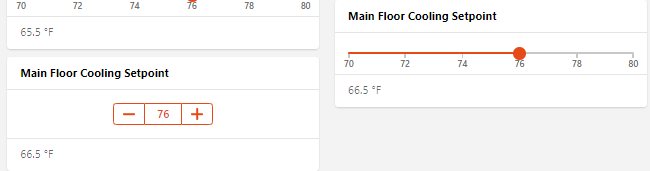

The new one works on a running system. Same screenshot with updated jar.

The fix also worked for me.
I can also confirm that the fix resolves the problem! Thank you!
