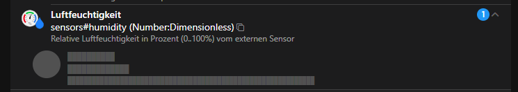

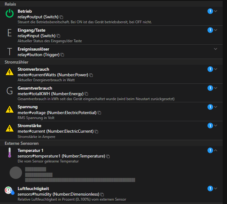

After upgrade today my testsystem from 4.1.3 to 4.2 some of my shelly’s will not work anymore:
@markus7017 : Please see, that the Shelly’s which have a extentation Module attached will NOT work:
Screenshot 2024-07-09 162035
Everything has been work file with the DEV binding from shelly 4.2 for some month. So not very nice, that the DEV binding has worked, and now the official has an issue.
Please have a look on it @markus7017
Thanks in advanced.
**UPDATE: **
by deleteting the things an recreate on my dev system the issue was gone.
the upgrade from the testsystem this issue was not seen itself.
now let’s see, how it works with the production system.
