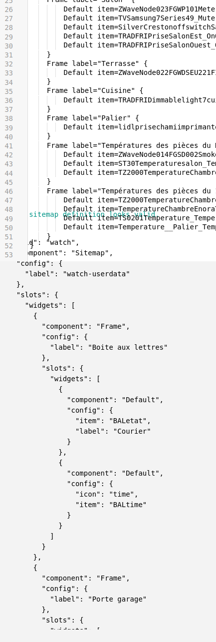

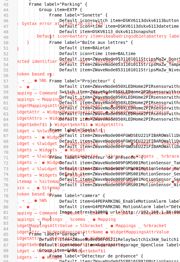

Minor issue with the UI:
After I upgraded my openhab system with the 4.2 version, I found some problems when displaying the code of my sitemap:
An error message in red is mixed with the source code. In addition, I cannot scrolled the source code of the sitemap. I did the test with Firefox and Chrome: same issue.
Concerning the error: I do not know why I have this error now. I did not see it with the previous version.
I tried with another more simple sitemap (the one for my Apple Watch):
No error this time, but the 5 first lines of the JSON code is mixed with the source code of the sitemap.

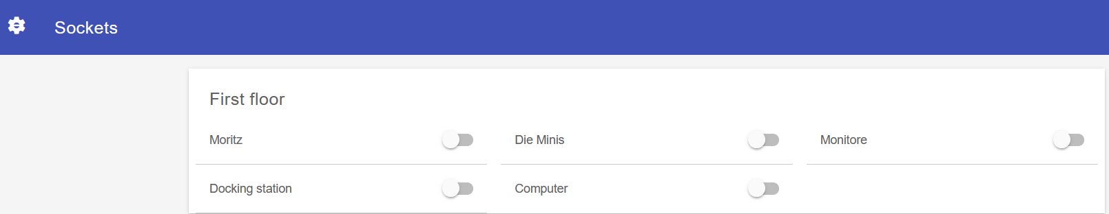

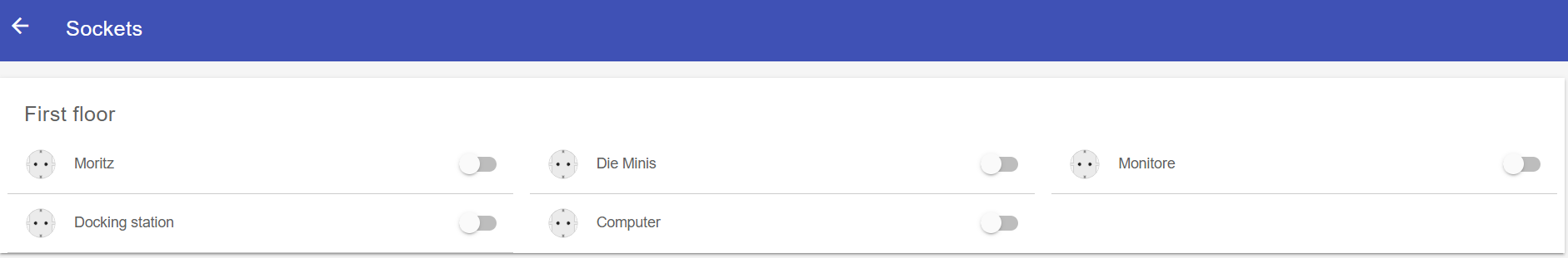

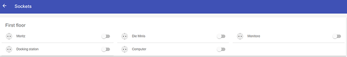

Hej all…
Sitemap is displayed incorrectly with Firefox since the upgrade to 4.2, in Chrome it is displayed as before.
Firefox
Chrome
I have created a fix for that and will backport it to 4.2.x, so the next patch release will include it:
https://github.com/openhab/openhab-webui/pull/2655
