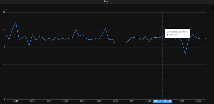

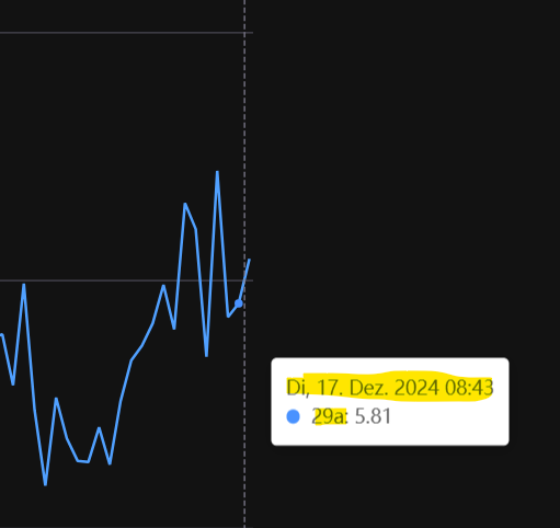

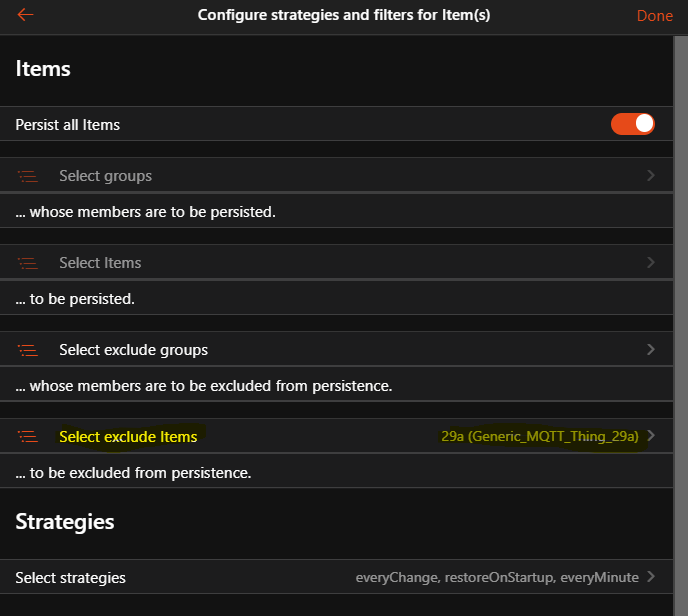

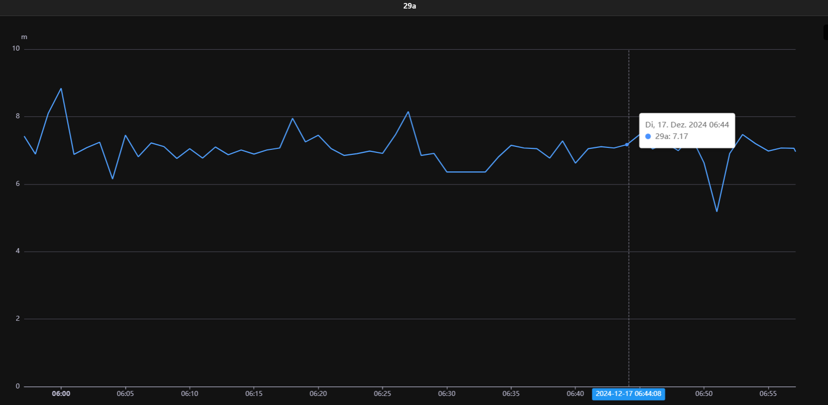

Ha! :slight_smile: This is not possible to do because I only can select existing items in MainUI. And with default persistence RRD4j it immediately starts with persisting the values for e.g. a number item like this.
Can I remove it manually?
@michaeljoos I meant, what is already persisted will not be removed. There should be no new values persisted.
Here is no way in OH to remove persisted values from rrd4j. I don’t know if it would be possible in another way.
Ah now I got it. I still see new values persisted. From now:
I can delete the file in this folder:
/var/lib/openhab/persistence/rrd4j
But openHAB immediatly creates a new file and continues with persisting.
You can delete through the REST API, use the API explorer in Main UI to do that β€žvisuallyβ€œ.
But I’m not sure if RRD4j supports deletion.
RRD4j is not a modifiable persistence service so, no, it wouldn’t support deletion (or any persisting outside of the current time).
I have updated the docs: Set nginx proxy HTTP version to 1.1 in reverse proxy config by florian-h05 Β· Pull Request #2429 Β· openhab/openhab-docs Β· GitHub
If you want to define a custom behavior, you will need to create a rrd4j.persist file in the persistence configuration folder.
That means: if you don’t want to persist all items, you need to create a rrd4j.persist file and only configure items to be persisted there.
I’m a bit confused now. So that means this new introduced feature in 4.3 does not work for RRD4j? Even it is possible to configure it in MainUI? Not critical for me, but was trying to test new features :slight_smile:
It should work. I don’t know yet why it doesn’t for you. Configuring in a .persist file or in the UI should be equivalent. This may be a bug. Could you try configuring it in a .persist file? If it works from there, the issue may be in the UI configuration.
