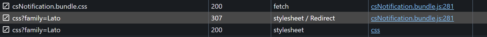

Ok, it seems some kind of incompatibility with NORD VPN extension (is that ever a thing?). I don’t know if there is something you can do to solve this, but definitively not related to openHAB.

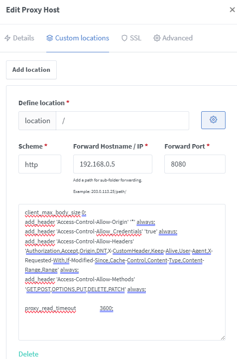

Turns out for me it was user error. It seems NGINX Proxy Manager already does that by default, I just had my headers in the wrong area. Needed to put them in a custom location like this instead of under advanced.
These lines get auto added by NPM so if you have them in, the proxy won’t start.
proxy_http_version                    1.1;
proxy_pass                            http://localhost:8080/;
proxy_set_header Host                 $http_host;
proxy_set_header X-Real-IP            $remote_addr;
proxy_set_header X-Forwarded-For      $proxy_add_x_forwarded_for;
proxy_set_header X-Forwarded-Proto    $scheme;
