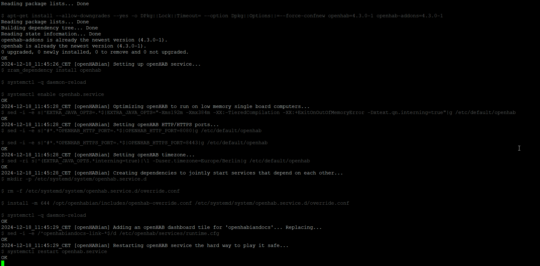

I upgraded today from OH 4.0.2 directly to 4.3 using the update mechanism from openhabian. Update run through without any problem, however the Webinterface on Port 8080 is not coming up. I checked in the logs and got the following error messages:
2024-12-18 10:17:36.155 [WARN ] [org.apache.felix.fileinstall        ] - /openhab/addons does not exist, please create it.
2024-12-18 10:17:36.254 [ERROR] [org.apache.felix.fileinstall        ] - Cannot create folder /openhab/userdata/tmp/bundles. Is the folder write-protected?
2024-12-18 10:17:36.261 [ERROR] [org.apache.felix.configadmin        ] - [org.osgi.service.cm.ManagedServiceFactory, id=48, bundle=18/mvn:org.apache.felix/org.apache.felix.fileinstall/3.7.4]: Unexpected problem updating configuration org.apache.felix.fileinstall.af6d4b0a-c87f-448f-9a15-52aa522243d1

I’m guessing this is a Docker install. Double check the file permissions on the files/folders mounted as a volume to /openhab/userdata. Make sure the user OH is running as (what ever you pass into the USER_ID environment variable or uid 9001 if you are not setting your own user ID).
Thank you Rich your answer. It is not a docker installation. It is an openhabian installation on a rasperry pi. I even used the openhabian configuration tool to do the upgrade as shown in the screenshot.
Any other ideas?
Unless something has really changed, there is no reason for OH to be writing to /openhab/userdata. That folder is /var/lib/openhab. Maybe these are the samba folders?
Note that it’s also complaining about /openhab/addons which shouldn’t be there either but in /uisr/share/openhab/addons.
OH apparently doesn’t know where and how it’s installed. Beyond that I can’t help too much. Maybe open a new thread and someone who’s an expert in openHABian can help.

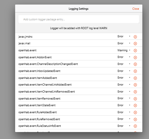

Just a question from a unknowingly user. I found the place in the UI, where to configure the new logger
but I do not understand what to do know. As I understand, what one can see in the picture above, is what is set in the karaf-console
Is there a tutorial for silly users as me to understand ?
Thx in advance
Cheers Peter

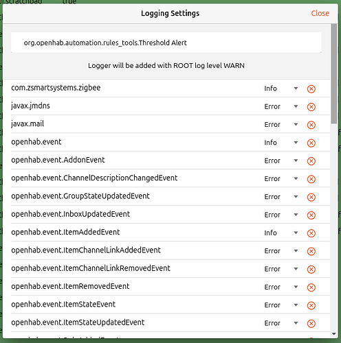

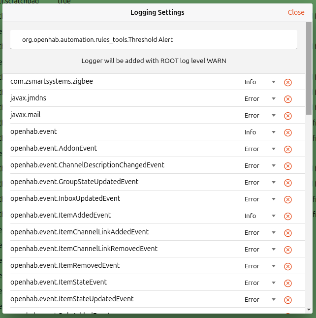

There is a new Log Viewer built into MainUI. This new viewer can be accessed via Developer Tools → Log Viewer.
This log viewer will show all the logging events currently configured to be generated based on your logging configuration. You can filter what’s being shown.
If you need to change the logging level of a specific logger, click the gear icon at the bottom right and you will get a list of all the loggers currently configured. Find the one you want to change the level for, click the level (e.g. Error) and select the new level. This will change the level for that logger everywhere including your log files and the karaf console.
For example, if you want to see in events.log and in the log viewer when your rules are running, find the openhab.event.RuleStatusInfoEvent, click ā€œErrorā€ and select ā€œINFOā€.
tl;dr, this isn’t a new logger, it’s just a viewer with the ability to adjust your logging levels all in one place. It is going to reflect exactly what you see in the Karaf console as well as in log4j2.xml because it’s all the same config.
As far as I can tell there is no way to create a new logger through the UI yet.
Never mind. If you enter the name of the logger you want to add it looks like it will add it. Clicking the X will remove it.
It looks like the docs for it haven’t been merged but when they are you’ll find them under Developer Tools - Overview | openHAB
