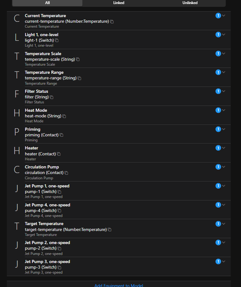

Thank you @Larsen , that worked, slightly different hottub, but it automatically rebuilt the array with the values I need to match my system (e.g. 4 pumps).
I’m not familiar with Java, but if I get time I’ll see if I can figure out why it didn’t work as expected. Hopefully there are some OH3->OH4 upgrade notes somewhere that might point to the issue.

All the channels will show up correctly after a little delay.
