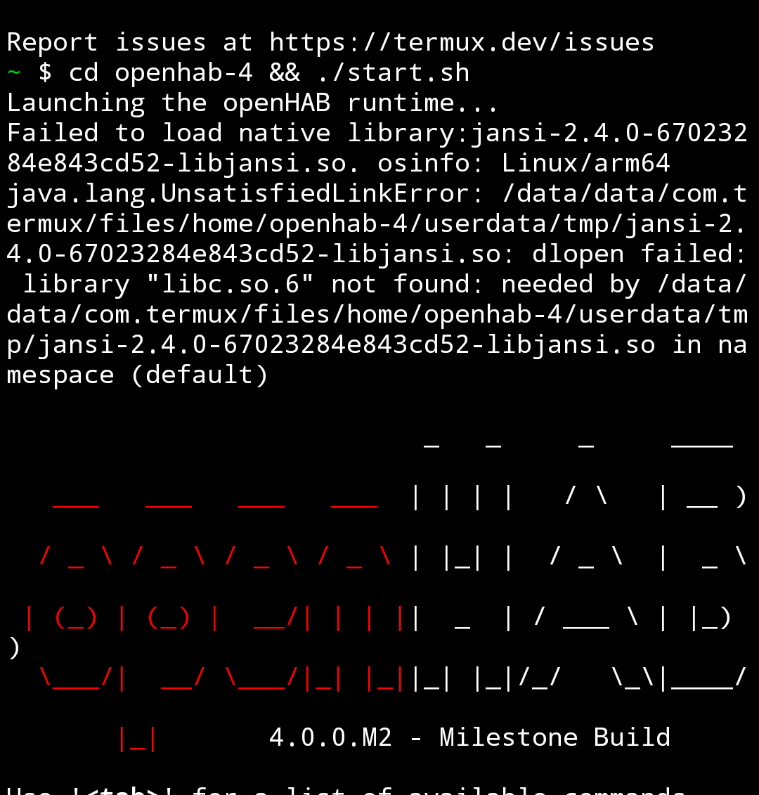

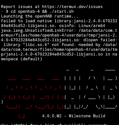

my problems
ssh login problems
login - connection refused
http://localhost:8080 or 127.0.0.1:8080
ok administration panel
does java -version work and give 17 ?
You should try openhab 4.0.2
for ssh see Making sure you're not a bot!
Mind that the ssh port is 8022

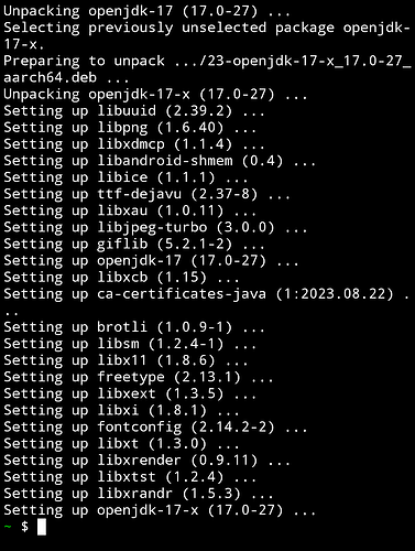

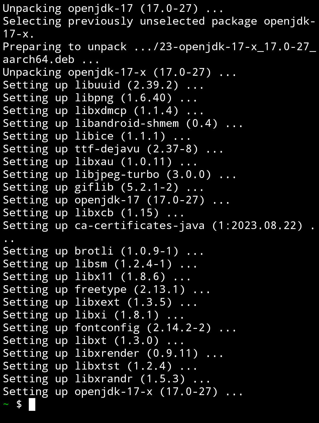

Stable version?
xxxxxxxxxxxxxxxxxxxxxxxxxxxxxxxxxxxxxxx
wget https://github.com/openhab/openhab-distro/releases/download/4.0.3/openhab-4.0.3.zip -not work (permission deined problem)
Yes install openjdk-17 termux (version 17.0.???)
termux not openjdk 17.0.5 to openhab required
