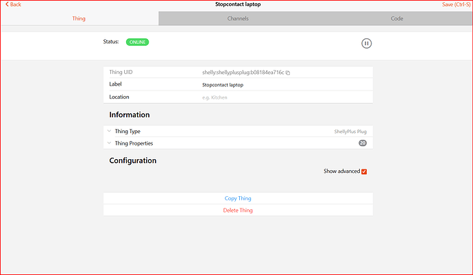

I finally upgraded to 5.0.1 (from 4.3.5).

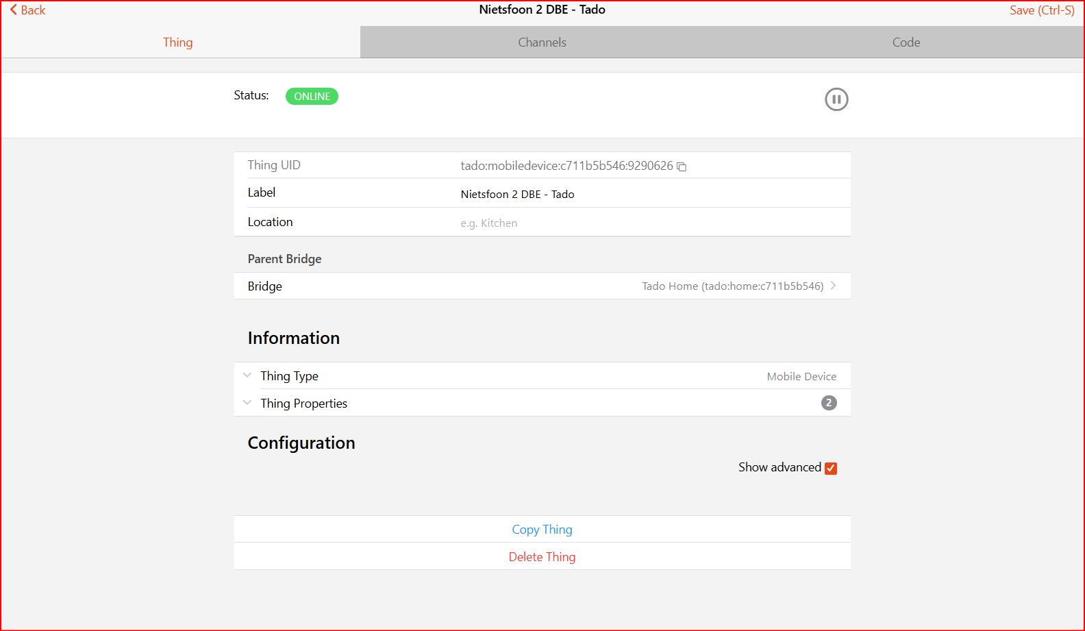

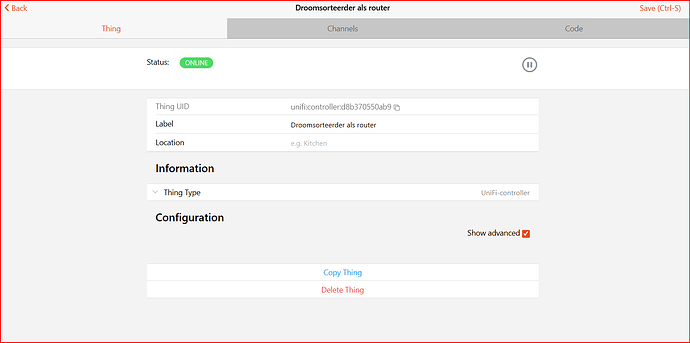

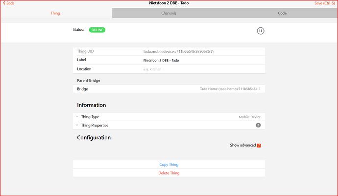

I now seem unable to make ā€œShow advancedā€ work in thing configuration. In fact, none of the configurations appear:

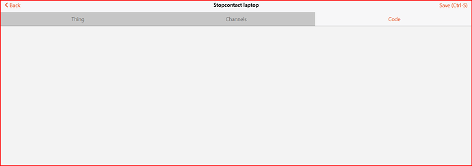

The ā€œcodeā€ tab also doesn’t show (in any thing):
I’ve cleared the cache (sudo openhab-cli clean-cache), but to no avail… Stopcontact laptop was a newly created thing, and I again deleted it and recreated it. Also no effect.

I’ve also had some trouble with ā€œadvancedā€, it used to show any ā€œadvancedā€ value that wasn’t default (aka changed ones), that seems to no longer be the case, and I think I’ve had to reload to get the ā€œadvancedā€ entries to show up (not sure what exactly solved it, didn’t keep at record when it happened). I’m also seeing the vertical scrollbars mysterically disappear now, where a reload might or might not bring them back.
A reload now made all configuration options visible. Did I try that earlier today…? I can’t recall :grimacing:

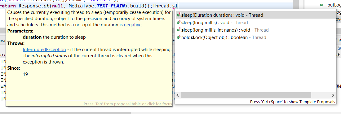

This might be something new in Java 21 perhaps? I’ve not heard about this changing at all but something is going on.
The error is saying that sleep() is expecting a java.time.Duration but you are passing it a Number.
But reading the javadocs, it never should have worked with a Number either as sleep() expects a long, not a Number. But maybe the ability to accept a Duration is new in Java 21 and now Rules DSL can no longer properly convert the Number to a long.
