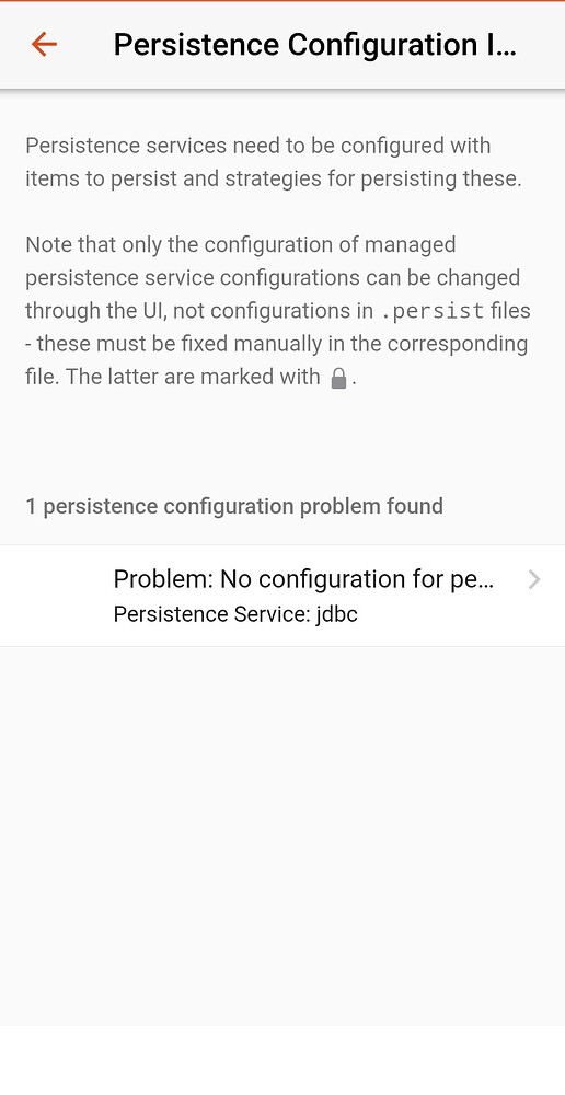

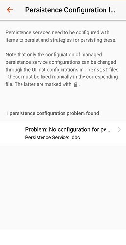

Yes I read it even earlier an the result was
After reinstalling the add-on and deleting the file, several reloading openhab and recreating the file it disappeared , this was not written down :slight_smile:
This bug is open since oh 4.3.1 Reloading of rules files doesn't work properly in openHAB 4.3.1 路 Issue #4529 路 openhab/openhab-core 路 GitHub that the file loading is sometimes not working properly
