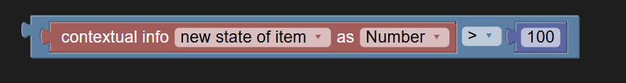

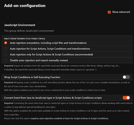

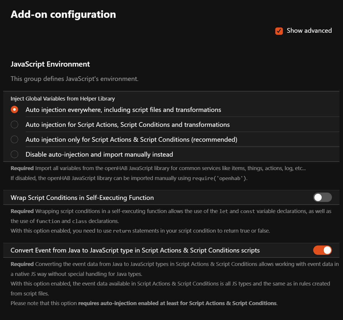

On question on rules’ conditions:
I used to have that
working fine in OH 5.0.2 as a condition for a rule to trigger. Now I get this error:
2025-12-23 12:55:37.823 [ERROR] [ernal.handler.ScriptConditionHandler] - Script of rule with UID 'NotifyPrisesInstantPowerAnormal' did not return a boolean value, but '[object Object]'
I tried adding a return statement but got an error…
I have this as JS scripting configuration…
Any recommendation on the way to proceed?
Thank you.

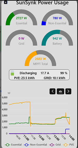

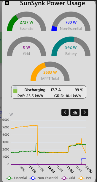

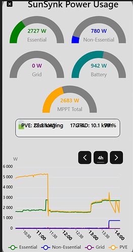

Hi All
Thanks for all the hard work that has gone into this release.
Prior to loading on my live system I have done a quick test on my test machine.
I noticed 2 things
The Upgrade Tool reported taht it had corrected the inlflux.persist config (removed the DEFAULT). Thsi however ended up not being the case - I think this may be rekated to me uisng a Windows setup?
Manually removing the line resolved any warning etc, so have gone with that route.
The second issue is that one of my widgets is no longer displayng correctly:
Was - Prior to 5.1.0 Relase:
Now - with 5.1.0 Release
The relevant code is:

I have not looked at fixing yet as I assume this is related to the changes made for this release?
Thanks for any assistance.
Mark
Please share the code that Blockly generates.
