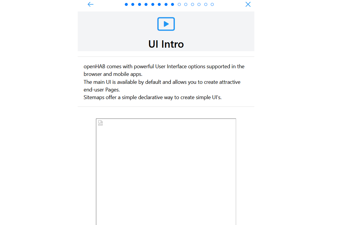

I just went through the new startup wizard, and it looks nice :+1:
But, there’s one thing: It’s just a narrow column on my screen, leading to a lot of scrolling because lines are wrapped. I guess this works fine on a mobile screen, but it feels a bit “odd” on a proper screen.
Also, there’s a broken image link here:

It’s a narrow column deliberately — it might be a bit wider, but too wide is difficult to use as content is spread too wide across the screen.
