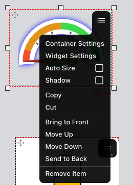

when I am editing a Main UI Page Layout in “Fixed Canvas” mode i do not see the “Edit Yaml” but its there in the “Fixed Grid” mode
I have refreshed the app on both systems and tried both HTTP and HTTPS
I have tried both Chrome and Safari on Mac OS

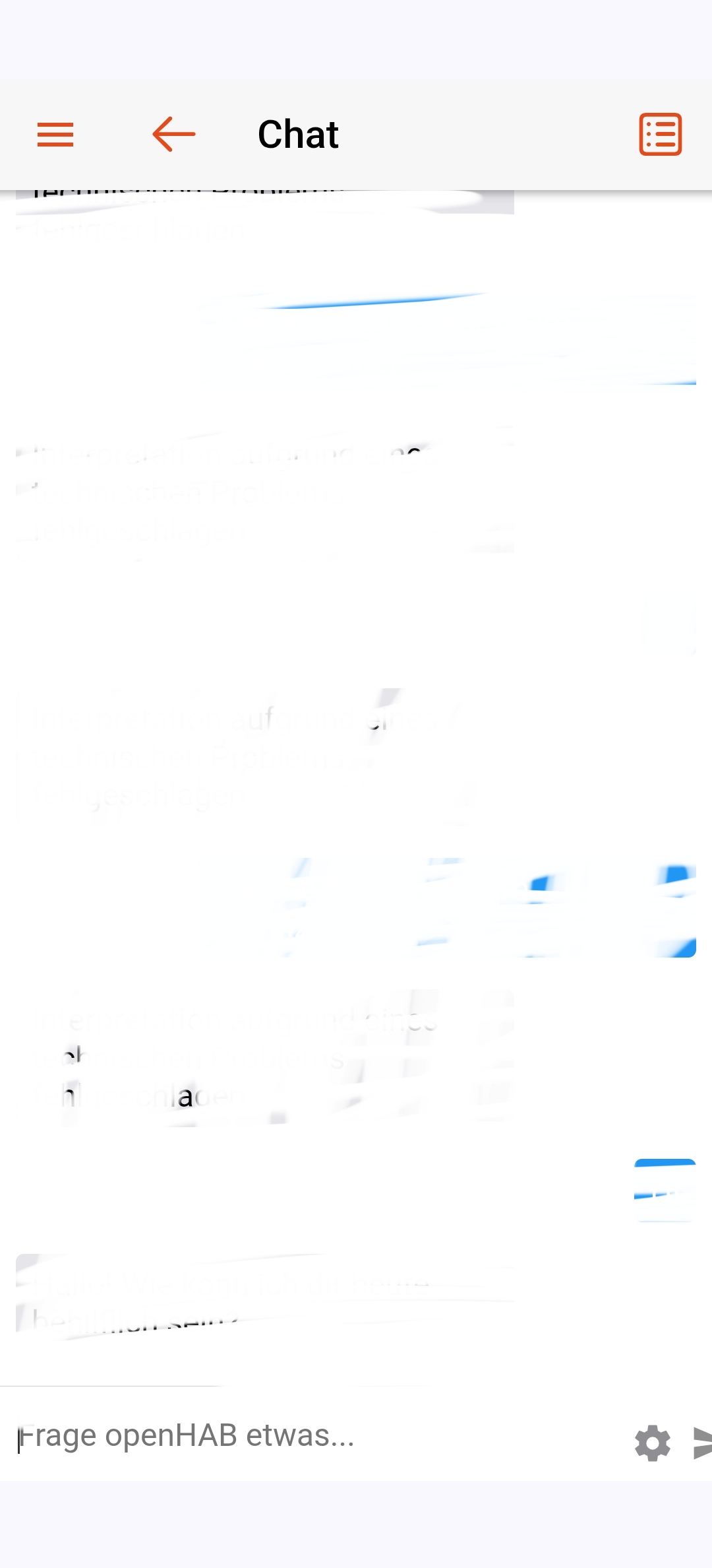

In the app I can’t touch the send button on my phone
