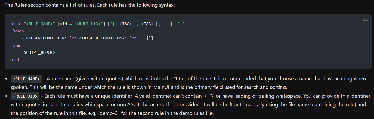

According to docs for openHAB 5.2, one can specify the UID for a DSL rule.
However, VS Code complains about no viable alternative at input 'uid'
rule "test2" [uid = "test_rule"]

try without the brackets
rule "test2" uid = "test_rule"
The brackets are a syntactic way to tell you that the elements inside them are optional, but in actual use you don’t include the brackets.
When they need to be literally used, you’d see them quoted like '['. In which case you don’t actually type the quotes, just the brackets :grinning_cat: and to add to the confusion
 when you see “test_rules” you do have to type the quotes :man_facepalming:

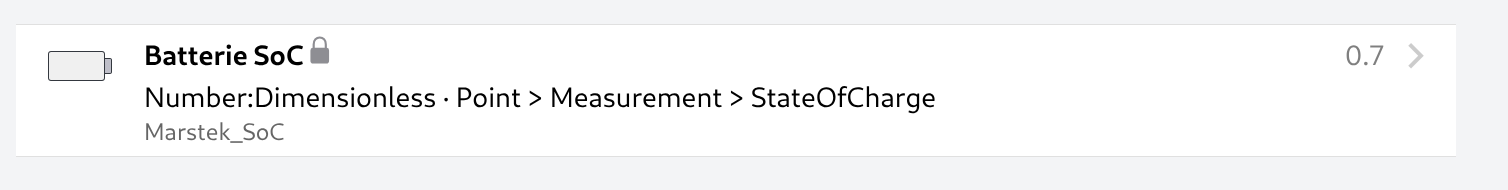

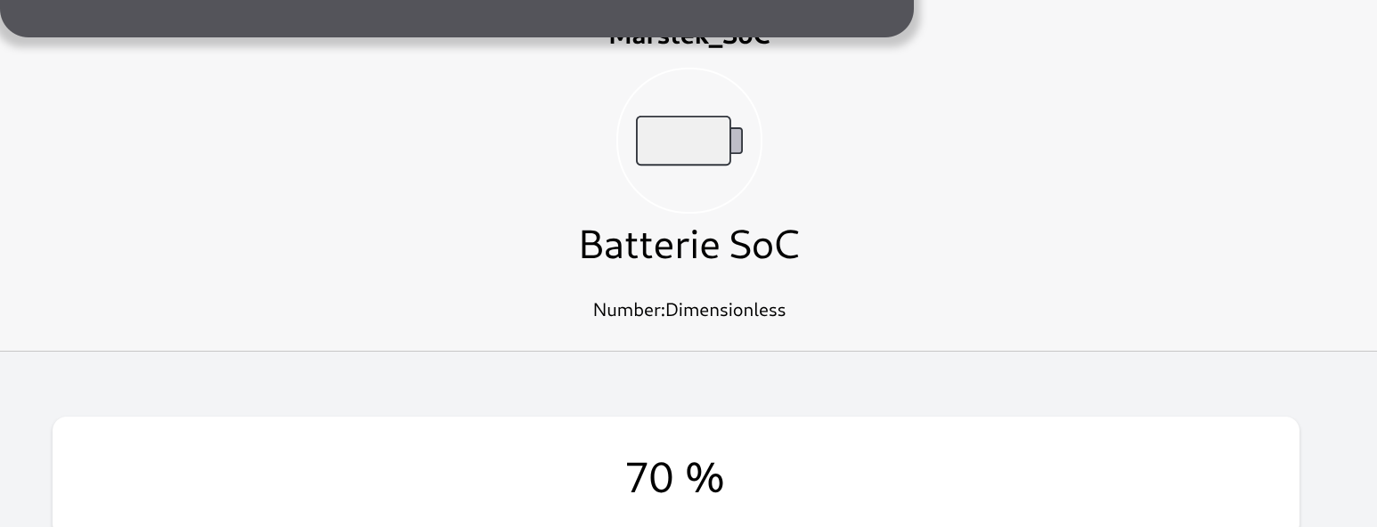

I have a question why I see in the Items overview 0.7
but if i click on it I see 70%

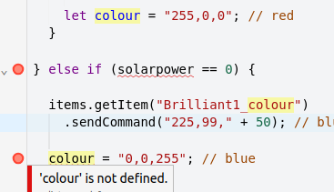

Is anyone else seeing variables not defined in ECMAScript?
I have defined colour but then I see red dots everywhere saying they are not defined but yet it still runs and I get no errors in the logs?
afaik these do not apply your state description / formatting.
Is that the mainui code tab? Can you paste the full code so we can try to reproduce it?

I think it is because I have declared them inside if statements and not at the start of the code. BUT it used to work before going to 5.2. Maybe it is stricter?
AFAIK it has been like that since the beginning. Try firing up OH 3 or OH4 and see!
Can it be improved? Probably. Or probably not worth it if it involves additional REST queries for every single item on the list.
I put this at the start and it is now fine:

Strange I never saw that in 5.1

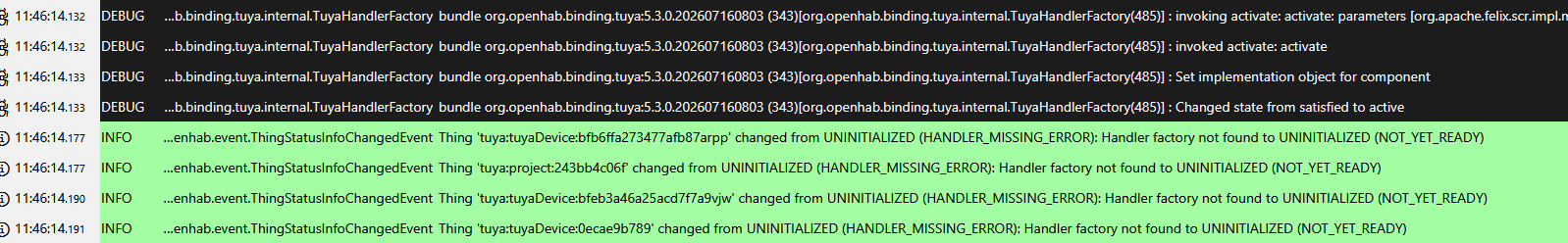

Espresso

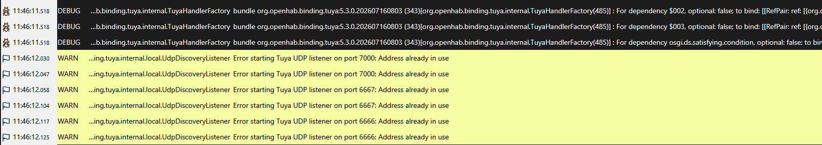

It is possible that it’s trying to listen on a port that’s already in use. Ideally it should’ve logged an error to ease troubleshooting.
If you are referring to the container ports, they are unique (I did a manual check again on all the containers).

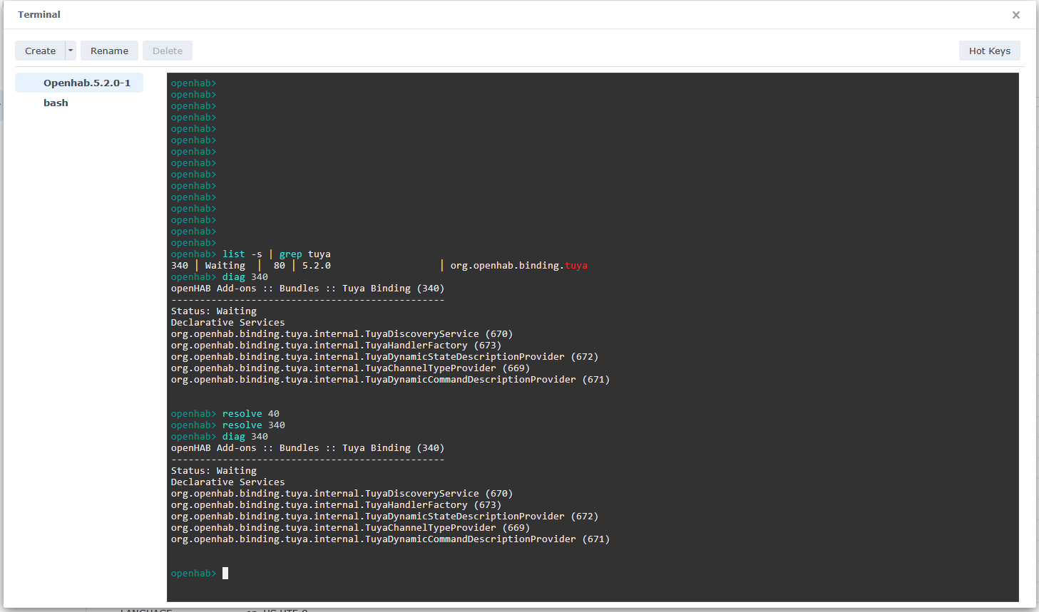

I have as well Tuya Binding working on my “production” on 5.1.1. I had done a test to disable that binding on 5.1.1 and see if 5.2.0 tuya binding comes up. It did not.
I know it is a separate binding, but the Sonoff binding is acting up as well. The connector is always online. The item sometimes disconnects (when i check the next day), giving Hander_Missing_Error, but then goes online again. (i run another scan, disable, re-enable, it then decides to come online) (Not related but thought worth mentioning)
Edit I did the steps shared in the link here is the result the binding is in waiting state, resolve command did not do anything
I see a problem in Tuya binding’s error handling. Give me a moment I’ll build a test jar for you that should handle it more gracefully.
Uninstall the official binding and drop this jar into your addons folder https://github.com/jimtng/openhab-addons/releases/download/tuya-v0.0.1/org.openhab.binding.tuya-5.3.0-SNAPSHOT.jar
It isn’t going to fix anything - just a quick “fix”. It will:
  • Issue a warning log telling you which port it is unable to listen on
  • Let the bundle status continue to be Active
  • To make it retry the listening port, you’ll need to restart the bundle.

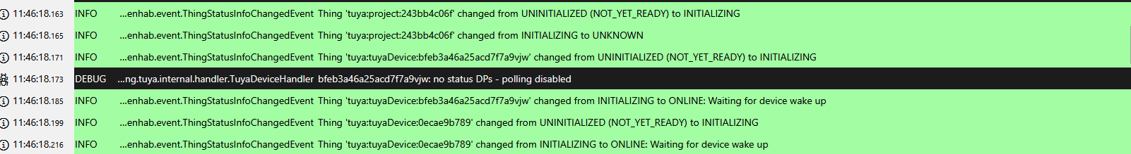

Hi @jimtng
Applying your jar worked!
The project and different sensors came online! almost immediately.
Port-related warning
(Not sure where to change those)
additional logs for your reference
Thank you again for your time and, more importantly, patience :slight_smile:
Let me know if you need to debug or share any logs.
Cheers,
Espresso
Something within your container (or on the host computer - depending on how the container networking is configured?) is also listening on those ports. You’d need to find it. Ask google for help in identifying it.
I have zero knowledge how the Tuya binding works. I don’t know how important those UDP listeners are and whether you can just ignore this issue or try to resolve it. I “suspect” it’s for new device discovery but once again I have no idea.
I will submit my changes as a PR anyway - hopefully someone else will improve it, but I think it at least fixes this particular issue letting you get your things to come online(?) :see_no_evil_monkey:
