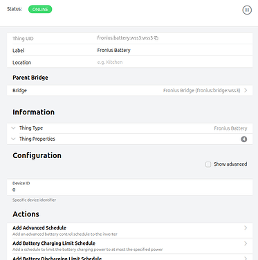

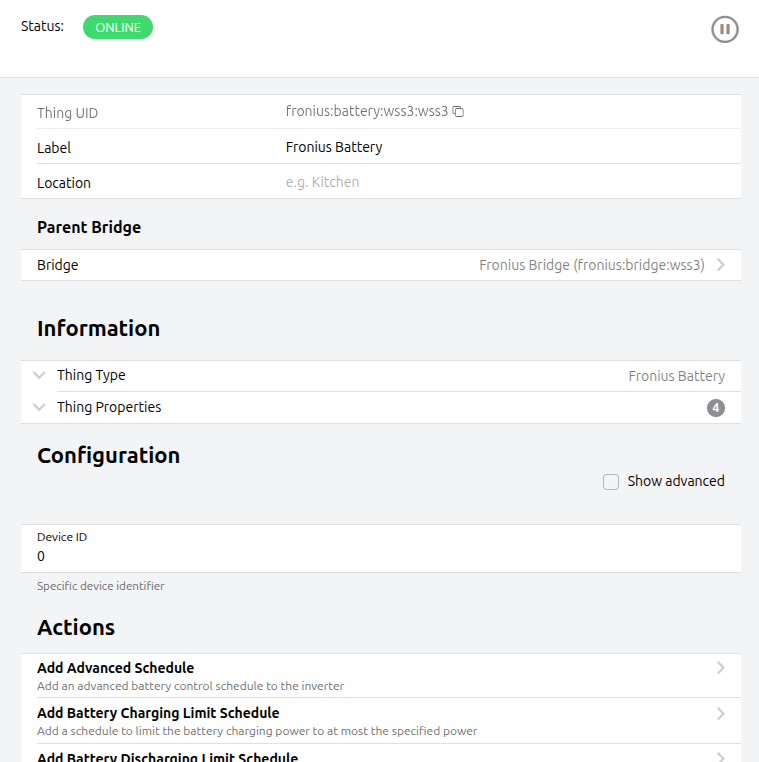

If anyone else (like me) is looking for the missing Fronius Inverter Thing Actions:
you have to create a Fronius Battery Thing now, and voila, all (and additional) Thing Actions are back:
We forgot to add a breaking change alert for that … will take care.
