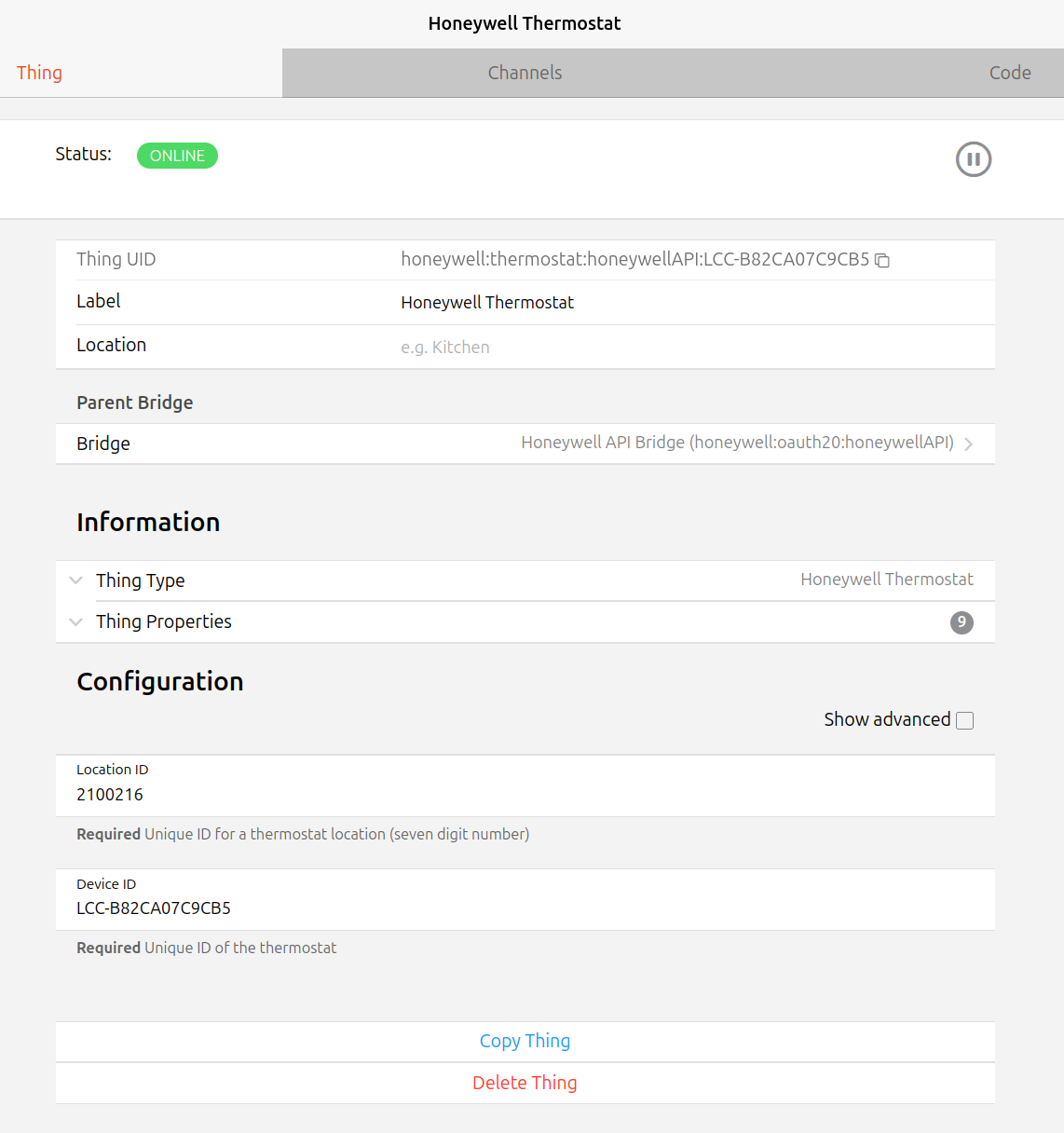

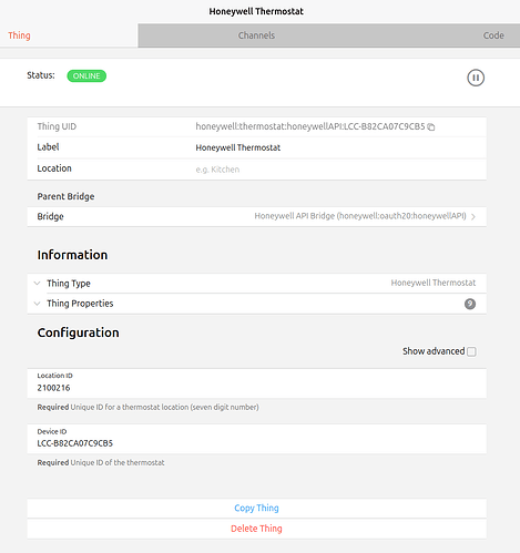

Let’s walk through the process with screen shots. Let’s pretend I just accepted a new Thermostat Thing in the Inbox. With another change @jimtng just added to OH 5 this will now take you straight to that Thing’s page so we start with:
Potential Improvement 1: Maybe have thge “add equipment to model” option on the main Thing’s page and not just the Channels.

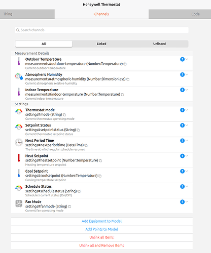

Click Channels and we see all the stuff this Thing supports. We also have “Add equipment to model” at the bottom.
Potential Improvement 2: Maybe these should be at the top instead of the bottom.
Click “Add equipment to model” since we want to add this “new” thermostat to the model. I put “new” in quotes because you can clearly see I’ve already added it.

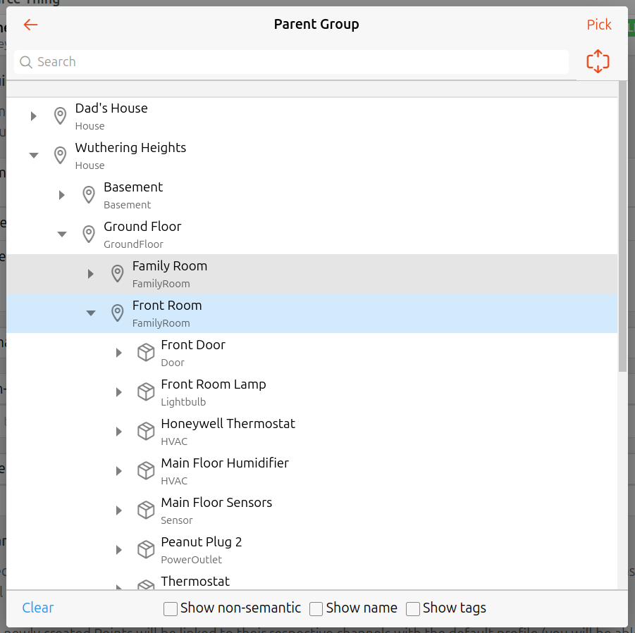

From here I select the Location where I want the equipment to appear on the Model.
Potential Improvement 3: Only show the Location Items.
Potential Improvement 4: Let one create a new Location from here.

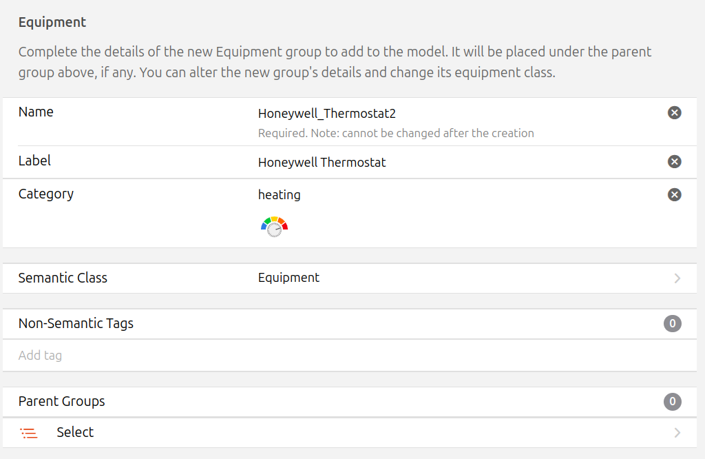

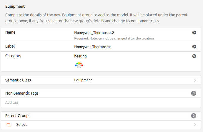

Next we configure the Equipment.
Potential Improvement 5: Have the binding recommend an appropriate semantic tag for the Equipment.
Note the name of the Equipment is used in the names of the Items that will be created.

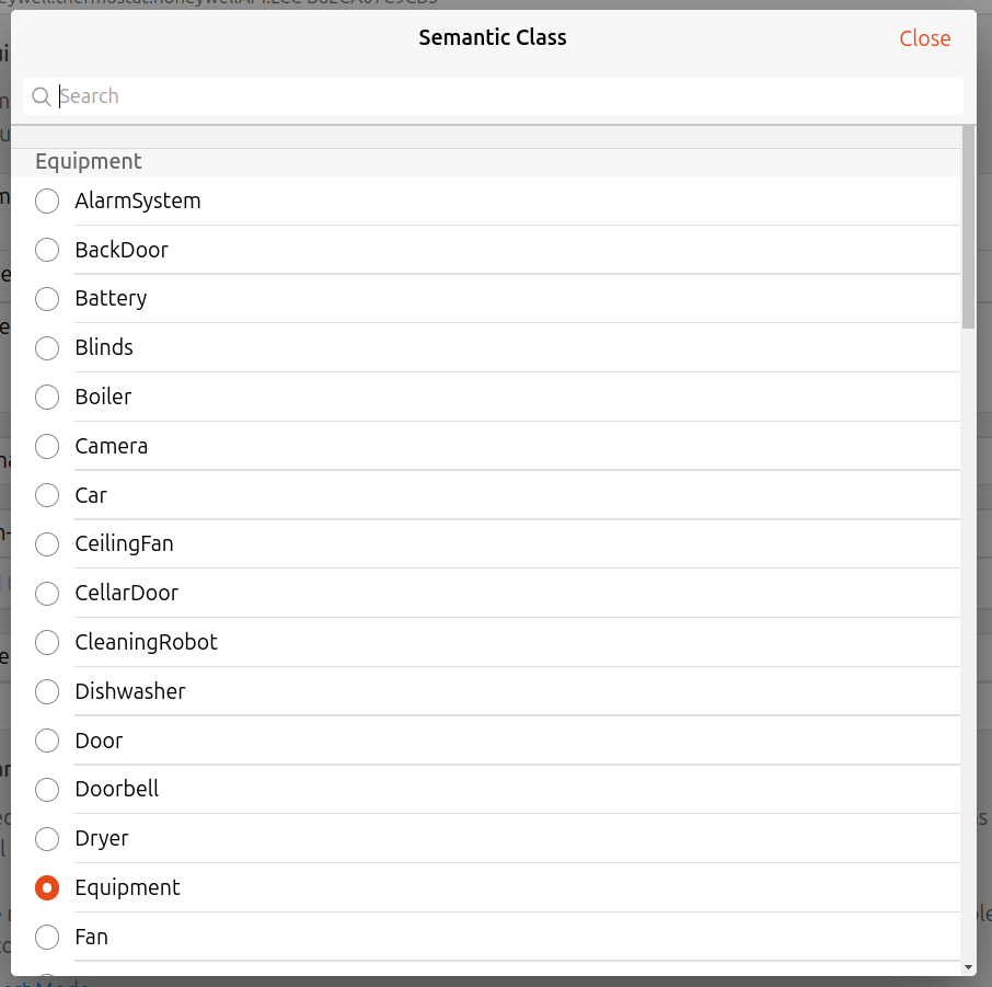

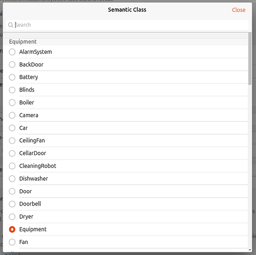

Select the appropriate semantic tag:
Notice only Equipment tags can be selected here.
Potential Improvement 6: Let the user create a new semant tag from here.

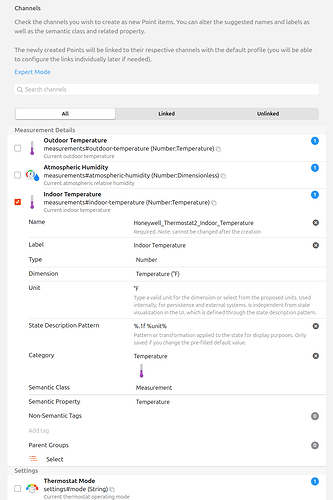

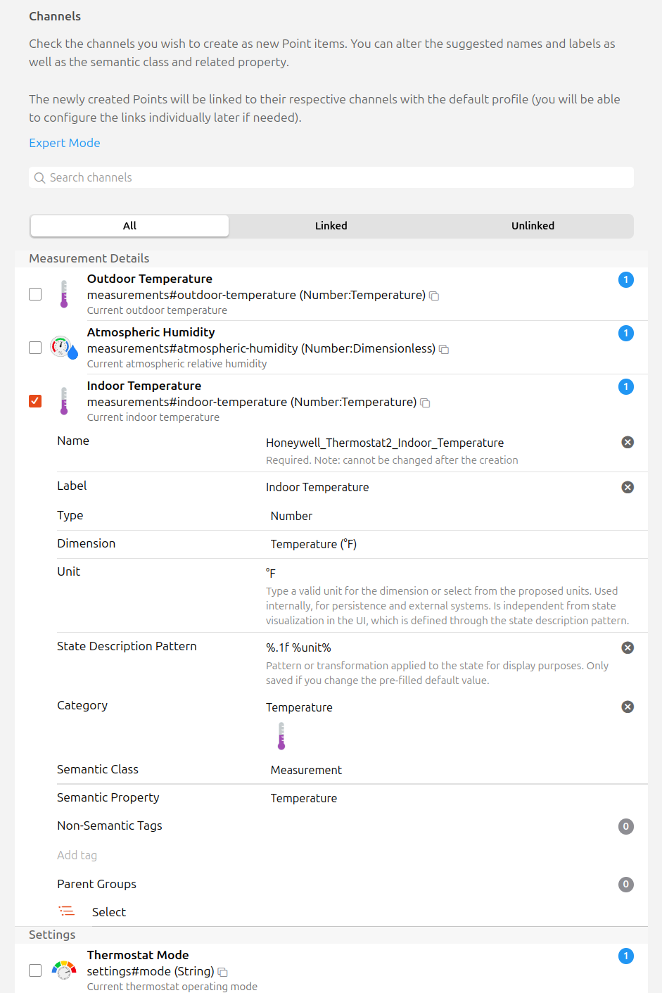

Now select those Channels you want to include in this Equipment. Often there will be more Channels here than one wants, in cases like Astro or OWM there can be many more Channels than wanted.
For each selected Channel you’ll get a form to override the configuration for the Items that will be created. Obviously you have the option to just accept the defaults.
Potential Improvement 7: Let the user select and modify already existing Items and not just the option to create new Items.
Most of the time, the defaults for the Item are reasonable. The name of the Item will be <Equipment Name>_<Channel Name>.
Potential Improvement 8: In an advanced area let the user apply a Profile to the link that will be created.

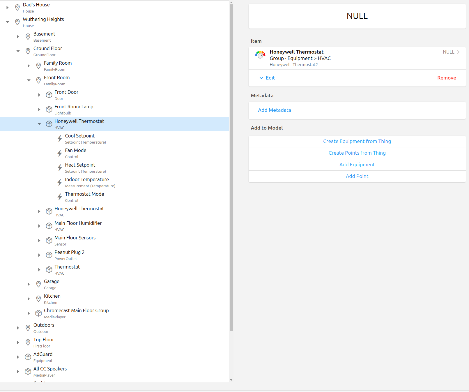

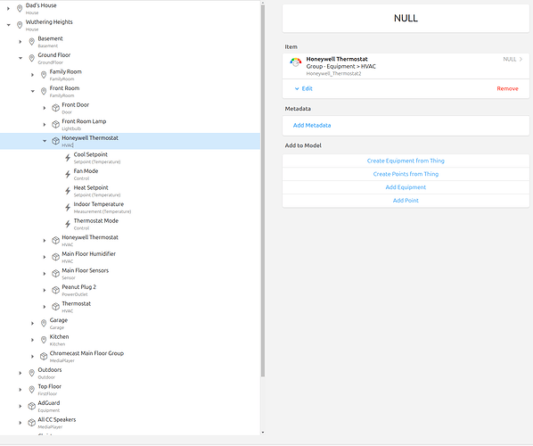

At the bottom there’s an “Add to Model” button. Clicking that and the Equipment Item is created, made a member of the selected Location, and new Items will be created for the selected Channels and made members of the Equipment.
On the model view it’ll look like this when you are done:
Potential Improvement 9: Go to the Model view when done with the newly created Equiopment selected.
It’s definitely more manual than it needs to be but all the steps are there.
