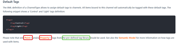

That seems straightforward enough - you define what the default tag the channel should have.
I did some more digging. Core already provides such tags for system channel types.

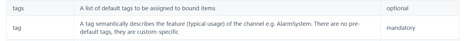

I am struggling with your “you define” phrase versus what little the doc says “pre defined” versus “custom specific”. At the moment it implies either of the following .. but not both
  1. Binding authors can put in any ‘s**t’ that they desire
  2. Binding authors can put in tags from a predefined list
Or??

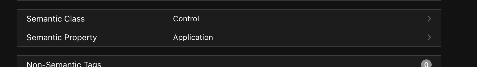

IMO that’s not necessary. Yes you can enter anything, and if you do, it won’t be automatically recognised as semantic tags, just plain tag. Here’s an example for lgwebos, I set the tags for the “Application” channel to: Control, and Application. Since Application isn’t a valid tag, it showed up as:

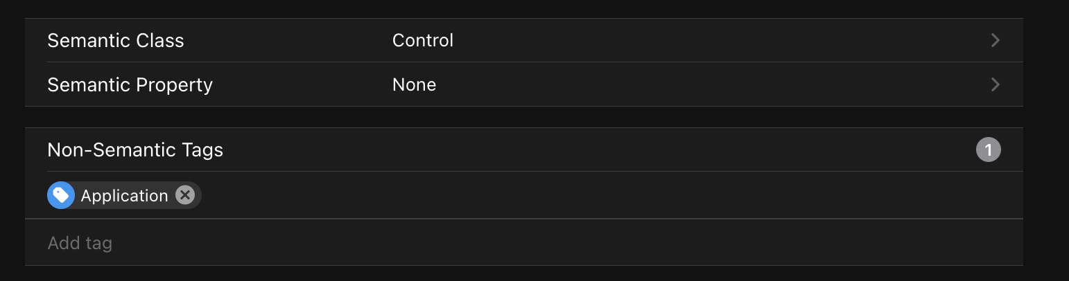

Then when I added a custom Property tag Application, the item became:
At the end of the day, they are simply added as Tags, because Semantic tags are also just plain old simple Tags.

I guess the message is that developers should add Equipment / Property and Point tags to their binding xml. (In general they probably cannot add location .. except perhaps for things like solar panels “roof” or “garage” door openers).
