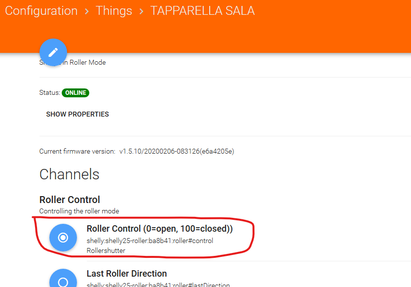

hello
i have openhab installed inside rasperry pi 4 and use device shelly 1 and 2.5
i see with shelly 2.5 shutters open close have inversion command
if i want close need put 100%
if i want open need put 0%
can i solve this problem and inversion open 100% and close 0% ?
can help me
thx

Take a screen shot from PaperUI of your Shelly Thing (the page with all linked channels) and post it.

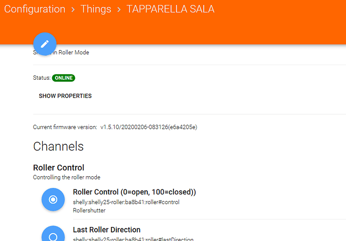

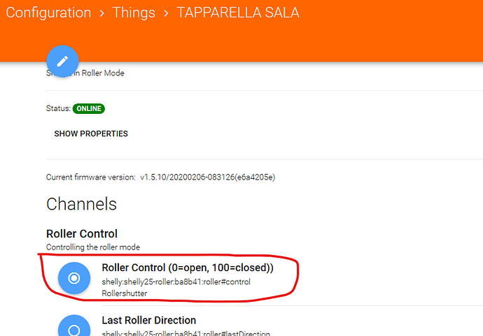

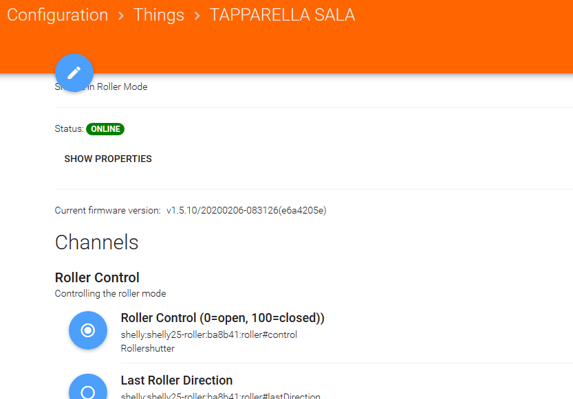

For the rollershutter, in PaperUI open the channel edit page and swap the 0% and 100% locations.
H102
(CM6.5 H102)
February 14, 2020, 5:16pm
14
Click show more ???
Or:
Create a proxy item for opening and closing the shutter. Name it whatever you like and replace it in the rule below.
rule "rollershutter"
Item Proxy changed
if(rollershutter.state as Number == 0){
rollershutter.sendCommand(100)
else if(rollershutter.state as Number == 100){
rollershutter.sendCommand(0)
dany83
(Danilo)
15
happy happy i solve , need click show more in things and use rolle control 100 open 0 closed
thx you
