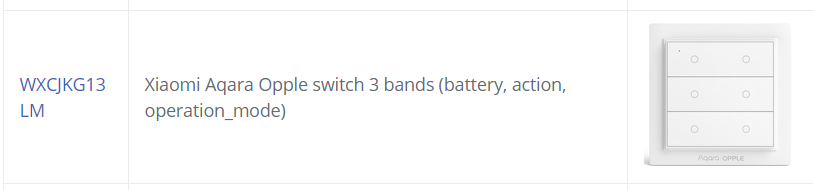

I was waiting for +6months that the Opple Swtich is added to the native zigbee binding.
In Z2M its there and many more. So I think I should finally move.

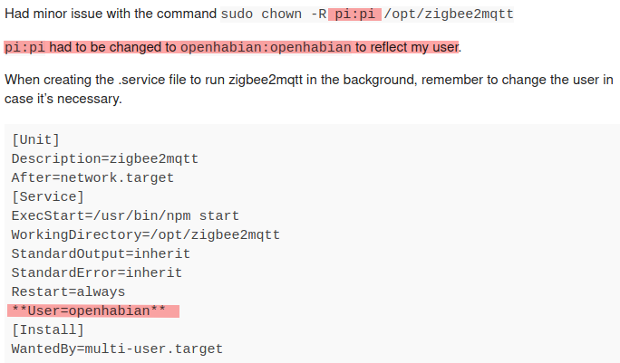

Make sure that you selected the correct user during installation
