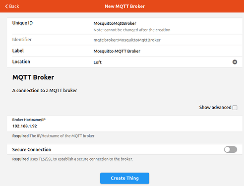

3. Connect openHAB3 to the MQTT broker
OpenHAB3 is connected to the MQTT broker through a Bridge Thing. To create a Bridge Thing:
  • Settings → Things → Blue + → MQTT Binding → MQTT Broker
ezgif-7-9033f770c9fd
Configure the Bridge to suit.
  • Unique ID: You can leave this default, or provide a more convenient ID. Once created, the ID cannot be changed.
  • Label: Friendly name for your MQTT Bridge Thing
  • Broker Hostname/IP: Enter the IP address of the device hosting the Mosquitto MQTT broker.
If you didn’t change any Mosquitto settings after install, you can leave the rest of the options as default.
Click Create Thing. Your Bridge Thing will be created and appear in your list of Things. After a couple of seconds, it will appear as ONLINE.

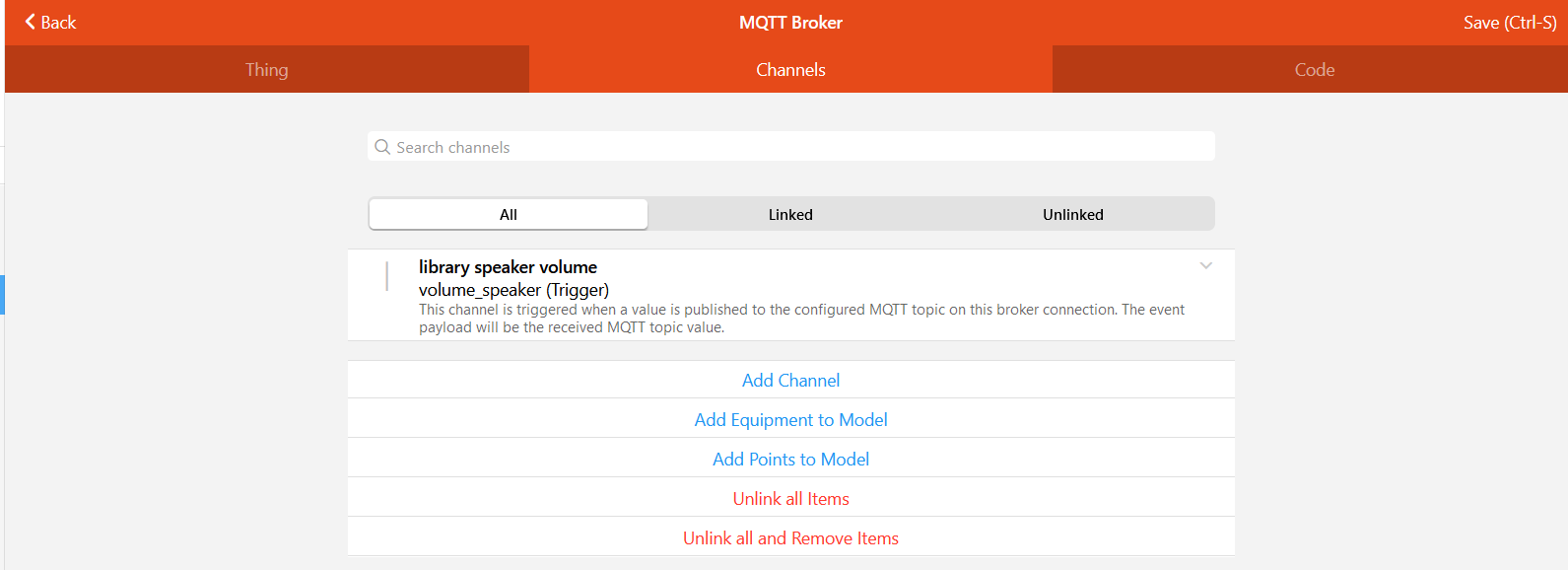

Thanks for the explanation. If you like, just a further one, which is the meaning of the channel at the broker level and at the generic mqtt thing level (in the tutorial, are used both, but it is not completely clear to me for which logical purpose)?
Which tutorial? MQTT Broker/Bridge Things do not have Channels.
Sorry, I, tried to use both, not in the tutorial.
I mean this broker channel
OK, so I wasn’t quite right - Bridge/Broker Things can have a Channel, but you likely don’t need it.
For each physical device that you have, setup a Generic MQTT Thing. Within that Thing, create Channels for each property that your device exposes: a switch, a temperature, a humidity etc.
