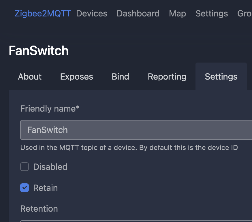

I remember seeing something like this in zigbee2mqtt in the device settings. I’ll try enabling it and doing a restart of the pi.

The retained flag will do the job. What that means is that broker will keep the message and when ever a client subscribes to that topic, the broker will immediately published the retained message. This ensures that the message gets delivered even if the subscriber wasn’t connected when the message was published. Note that the broker doesn’t keep track of whether it’s already sent that message to that client. So every time OH connects to the broker, it’ll get that same retained message again.
But usually that’s OK.

I had a problem with adding 0.0.0.0 to the listener, but I resolved it by updating the zigbee2mqtt config yaml file to look for the MQTT server at the IP vs localhost. Now i’m basically back to square one, except I have the “retain” checkbox clicked in zigbee2mqtt and the transformation pattern applied to the MQTT Thing in OpenHAB.

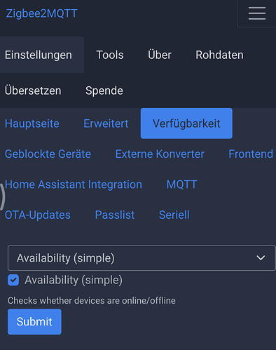

Hi, did you check you zigbee2mqtt settings?

Hey! Yes, I have this setting set to Availability(Simple) like yours. It does not fix the issue :frowning:
