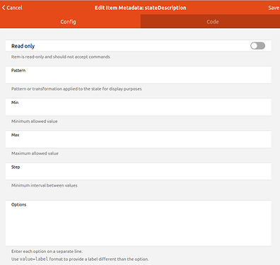

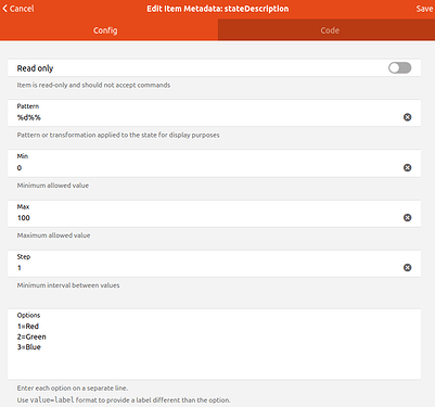

State Description
Via the UI, the following options are available:

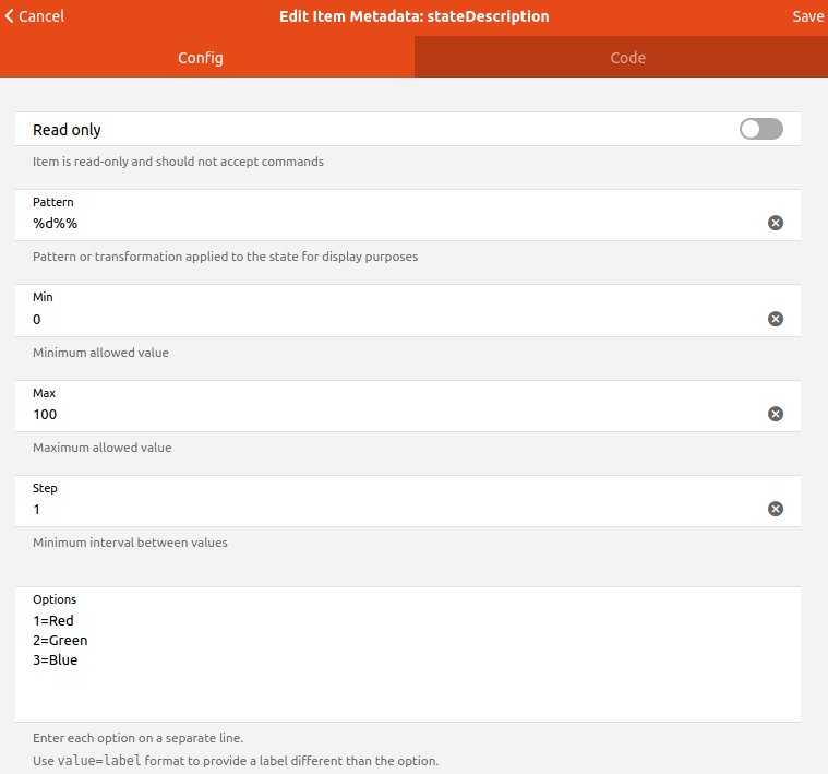

To populate these fields via configuration files (example values):
Number nTest "Test Number Item" {
	stateDescription=""[
		pattern="%d%%",
		min="0",
		max="100",
		step="1",
		options="1=Red, 2=Green, 3=Blue"

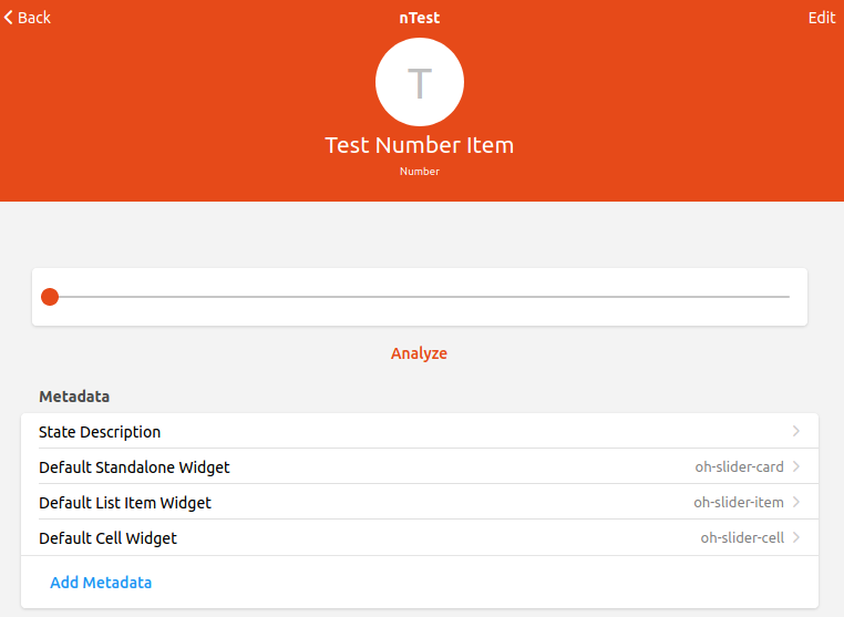

Default Widgets

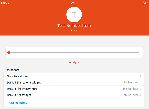

You can set the default widgets for standalone, list and cell presentation from the Item itself. Within configuration files, for example:
		pattern="%d%%",
		min="0",
		max="100",
		step="1",
	widget="oh-slider-card",
	listWidget="oh-slider-item",
	cellWidget="oh-slider-cell"

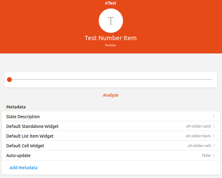

General
You can use the UI to work out what the main metadata namespace is. For example, selecting Auto-Update from the list presents a page with this title:
Therefore autoupdate is the namespace to use:

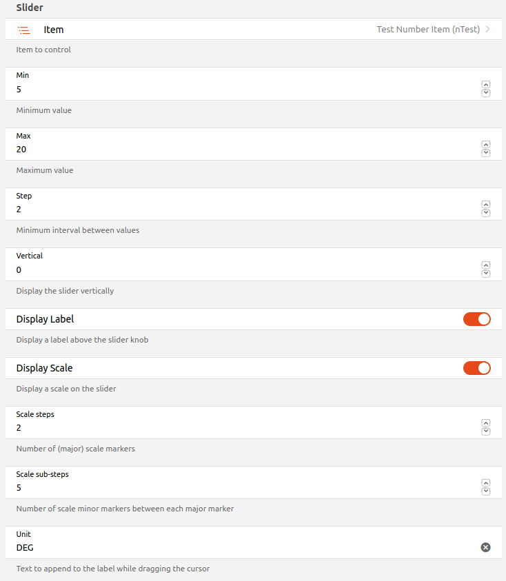

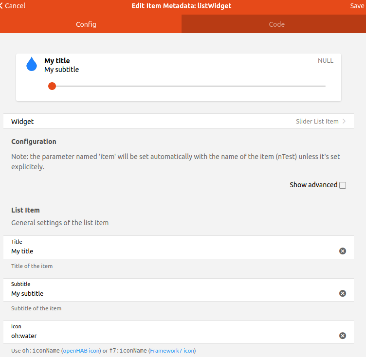

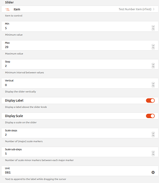

You can then use the code tab to work out what the extra metadata options are. For example, to expand the Default List Item Widget click on it and start entering nonsense data in to the fields:
Then move to the code tab:
value: oh-slider-item
  icon: oh:water
  title: My title
  subtitle: My subtitle
  min: 5
  max: 20
  step: 2
  vertical: 0
  label: true
  scale: true
  scaleSteps: 2
  scaleSubSteps: 5
  unit: DEG
Which would translate to:
		pattern="%d%%",
		min="0",
		max="100",
		step="1",
	listWidget="oh-slider-item"[
		title="My title",
		subtitle="My subtitle",
		icon="oh:water",
		min=5,
		max=20,
		step=2,
		vertical=0,
		label=true,
		scale=true,
		scaleSteps=2,
		scaleSubSteps=5,
		unit="DEG"
	cellWidget="oh-slider-cell",
	autoupdate="false"

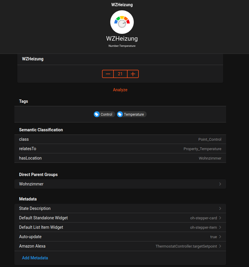

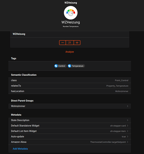

OK, but this entire topic is about metadata in configuration files! Either way, interesting that you get the WARN on a UI configured Item too.
2021-01-11 11:10:51.964 [WARN ] [dataStateDescriptionFragmentProvider] - Unable to parse the stateDescription from metadata for item WZHeizung, ignoring it
2021-01-11 11:10:51.991 [WARN ] [dataStateDescriptionFragmentProvider] - Unable to parse the stateDescription from metadata for item WZHeizung, ignoring it
2021-01-11 11:10:51.998 [INFO ] [.openhab.core.model.script.WZHeizung] - Neuer Wert 21.0
2021-01-11 11:11:22.980 [WARN ] [dataStateDescriptionFragmentProvider] - Unable to parse the stateDescription from metadata for item WZHeizung, ignoring it
2021-01-11 11:11:22.985 [WARN ] [dataStateDescriptionFragmentProvider] - Unable to parse the stateDescription from metadata for item WZHeizung, ignoring it
2021-01-11 11:11:22.990 [WARN ] [dataStateDescriptionFragmentProvider] - Unable to parse the stateDescription from metadata for item WZHeizung, ignoring it

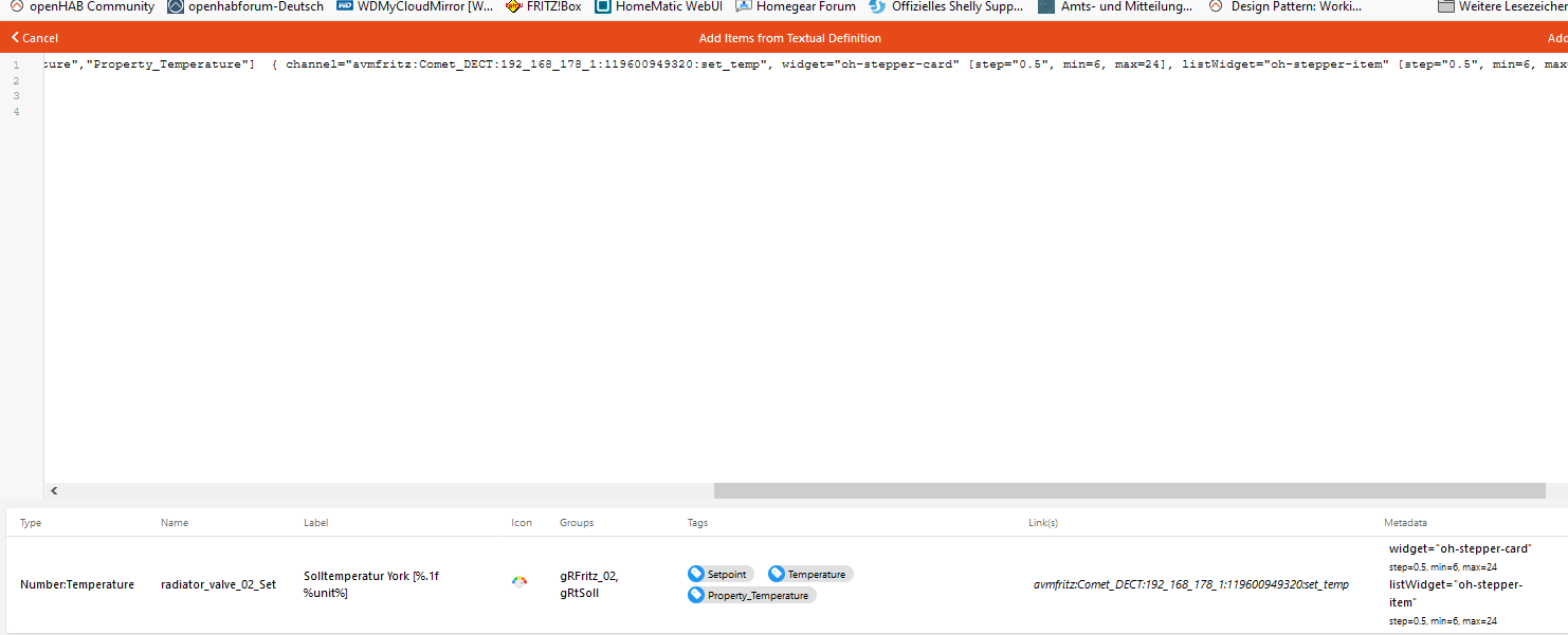

I trapped into a pit fall
 Via Sitemaps Editor you must use half steps with comma, but in item state it seems you must use point. That is silly

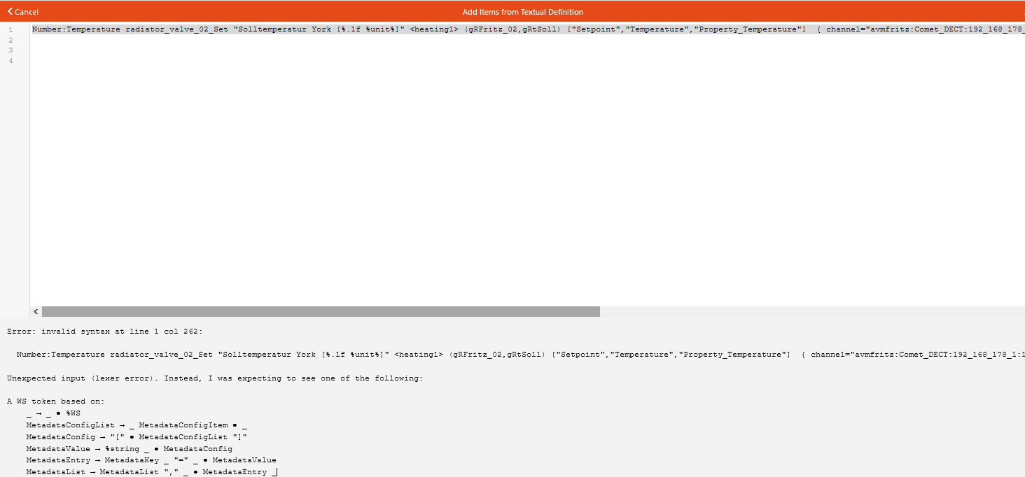

but if you try this(using “half-steps”:
Number:Temperature radiator_valve_02_Set "Solltemperatur York [%.1f %unit%]" <heating1> (gRFritz_02,gRtSoll) ["Setpoint","Temperature","Property_Temperature"]  { channel="avmfritz:Comet_DECT:192_168_178_1:119600949320:set_temp", widget="oh-stepper-card" [step=0.5, min=6, max=24], listWidget="oh-stepper-item" [step=0.5, min=6, max=24] }
and using the developer tool “Add Items from Textual Definition”, you will get an error:
but if one sets the “half-steps” in quotes, it will be accepted,
weird
Is that only for ‘half’ steps (<1), or all steps? My thermostat can only handle integers, so never tried
seems to be for every decimal/float.
