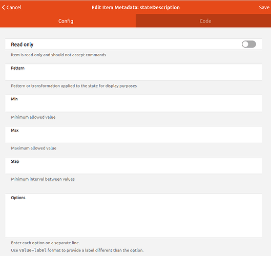

Hi folks,
how i can find out the syntax to populate the “read only” property of an item within the *.items conf-file? Options are working fine…
Thx, Sascha
Hi @shaselb, Hi Search User,
Summary
stateDescription=""[pattern="%d%%",min="0",max="100", readOnly=true]
I was looking for the same question because it is case sensive and I did not know that.
So the following stateDescription has to be configured for your item:
