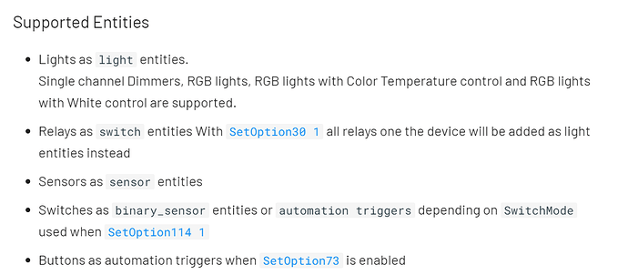

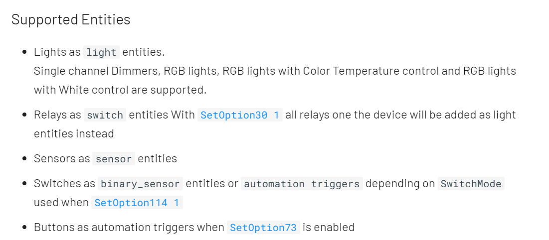

Automatic discovery is currently supported for: - Buttons - Lights - Relays - Sensors - Switches - Fans

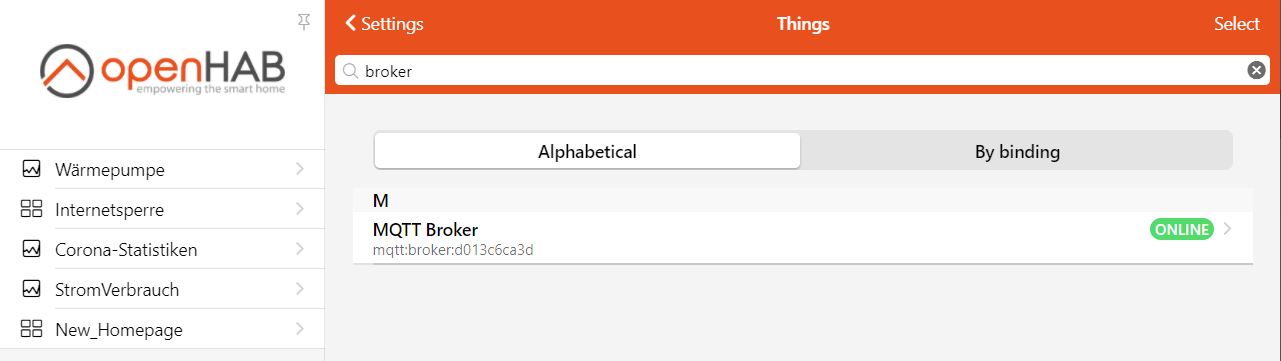

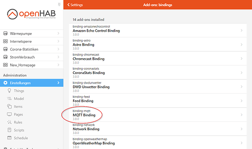

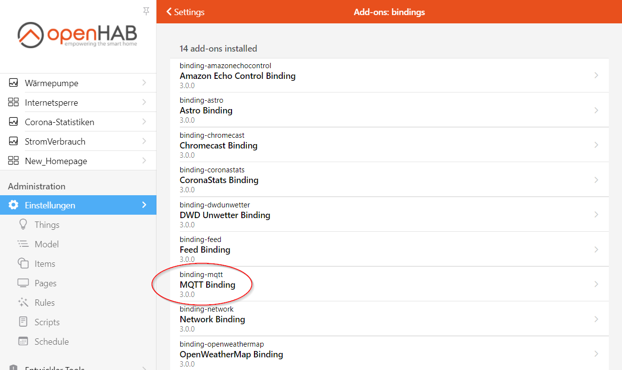

To be able to use MQTT-Autodiscovery, you need the MQTT-Binding
And a connected MQTT Broker

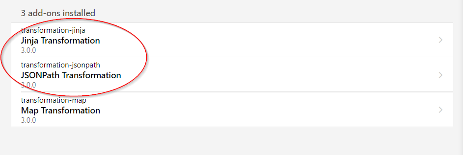

And you need at least two transformations from Settings → Transformations
JSONPath and Jinja

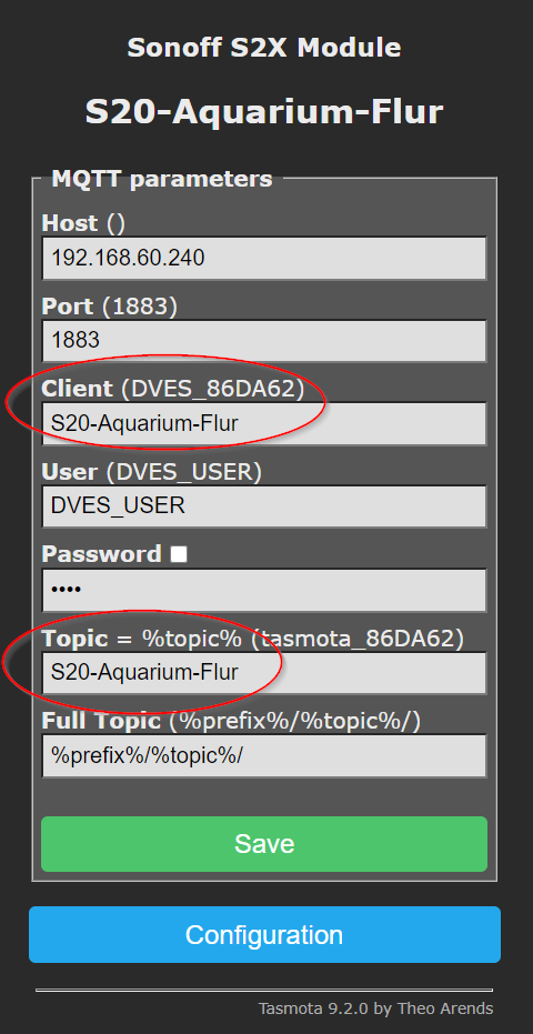

First go to Configuration → Configure MQTT and insert your broker-settings
Be sure you use a unique Client-Name and Topic, not used by another MQTT-Device in your network.

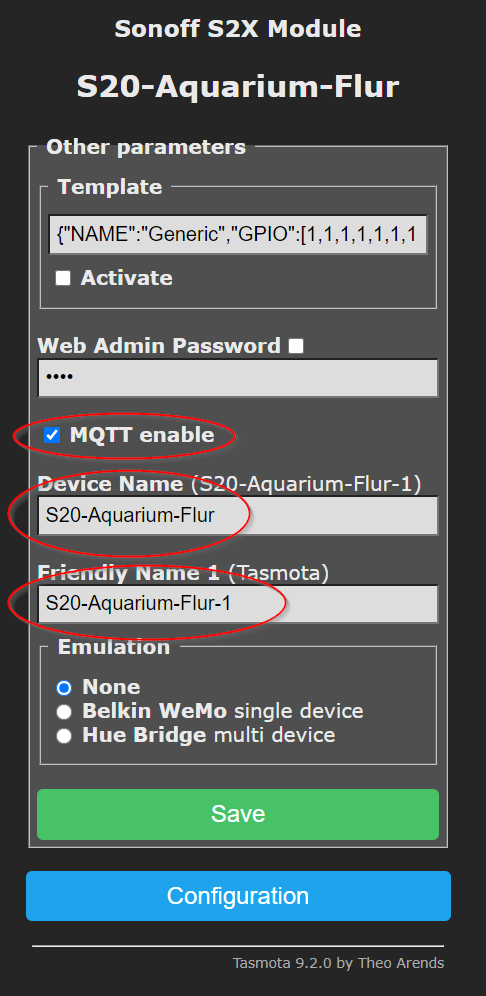

Second go to Configuration → Configure Other , set the DeviceName and enable MQTT

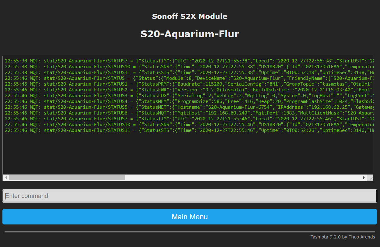

3. activate Tasmota HomeAssistant Autodiscovery Feature

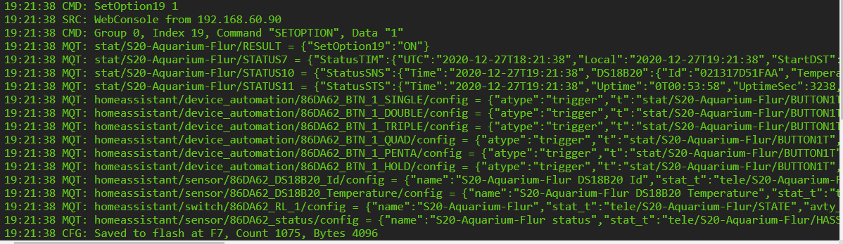

Autodiscovery-Activation has to be done via the Tasmota-Console, there is no WebUI for this
So please navigate back to you main-menu and select → Console
Now enter ‚SetOption19 1‘ and hit enter
Tasmota should respond with something like that

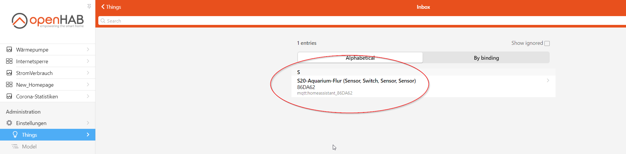

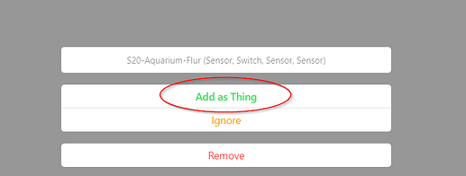

Back in openHAB you should get a new discovered device automatically in your inbox
If you click on the Inbox Label, you get directly in the Inbox with the new device

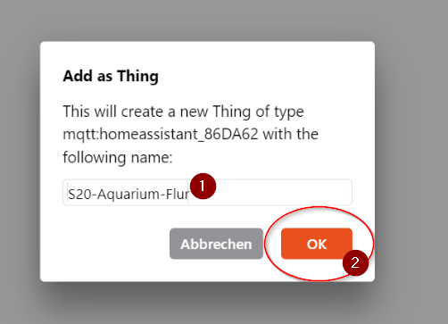

Then clicking on the new autodiscovered device will ask you to create a new thing
You can edit your new Thing-Name and then proceed by clicking OK

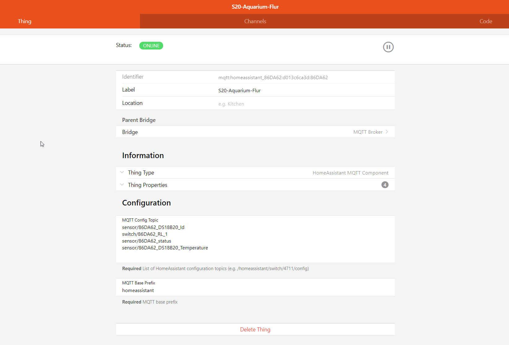

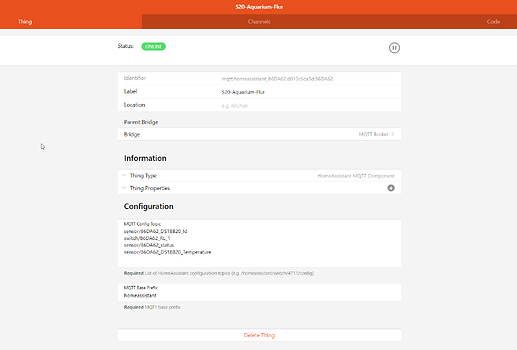

Now the new Thing is created and you can find it in the list of Things to have a look at the details
Thing-Details
Thing-Channels

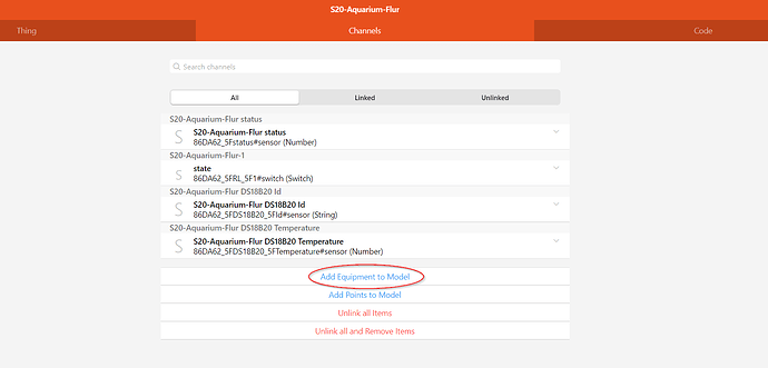

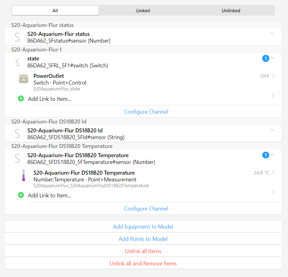

from this view, you can add the new thing to your semantic model and create corresponding items

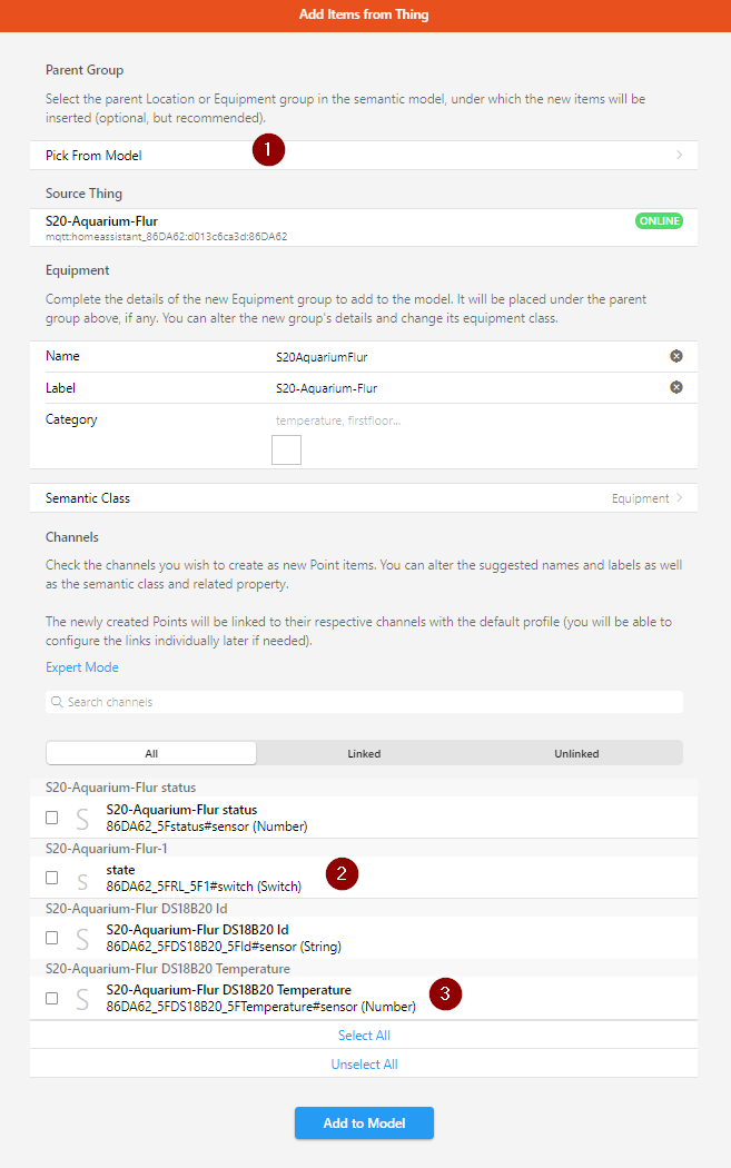

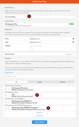

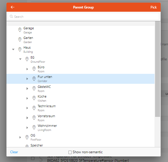

5. create Items from Thing and add to semantic model

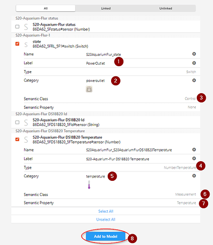

In the channel-view click on ‘Add Equipment to Model’

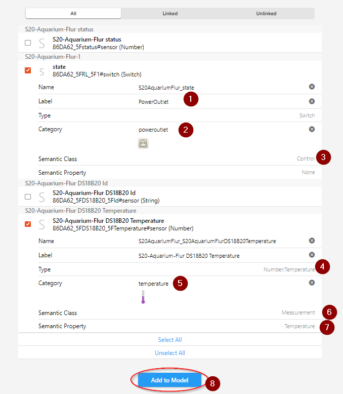

(1) select where in your model the new equipment should be located
(2) + (3) configure the Relais and the Temperature-Sensor

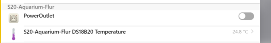

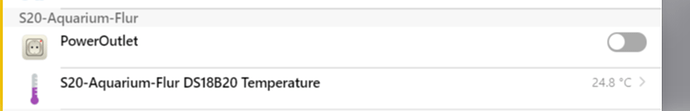

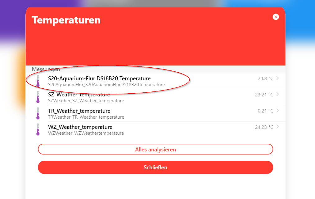

Now the new Device is completely integrated
and can be used in the semantic model, too

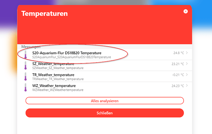

For example you will get the Temperatur of the sensor in the automatically created properties-tab on the homepage, along with other Temperature-Items
or you can control the relais from the Equipment-TAB → Equipment
