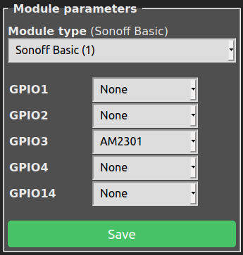

2. Setup device to read the DHT22 temperature sensor
In a browser navigate to the Tasmota Module parameters configuration page of your device, normally at:
  • http://<sonoff-ip-address>/md
  • device home → Configuration → Configure Module
I connected the DHT22 data pin to the Sonoff GPIO3 pin (Serial In). If you used a different sensor, or a different pin, make the required changes here.
Back on the device home page (http://<sonoff-ip-address>), check that the temperature and humidity are displayed (may take a little while to show real values).

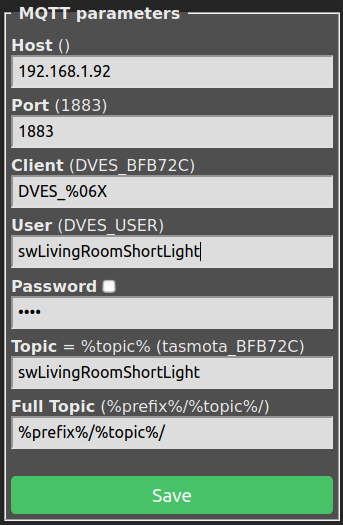

3. Setup device to connect to the MQTT broker

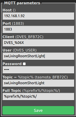

In a browser navigate to the Tasmota MQTT parameters configuration page of your device, normally at:
  • http://<sonoff-ip-address>/mq
  • device home → Configuration → Configure MQTT
Configure the following. Leave everything else as default:
  • Host: IP address of the device running the Mosquitto MQTT broker.
  • Port: Only change if you have changed the default port for the Mosquitto MQTT broker.
  • User: Give your device a unique name. Mine switches on a short light in the living room.
  • Topic: Give your device a unique topic. I match mine to the User.

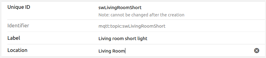

Enter the initial configuration information:
  • Unique ID: You can leave this default, or provide a more convenient ID. Once created, the ID cannot be changed. I usually use the same name as used for the Tasmota User.
  • Label: Friendly name for your device
  • Location: Physical location of your device

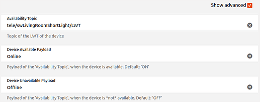

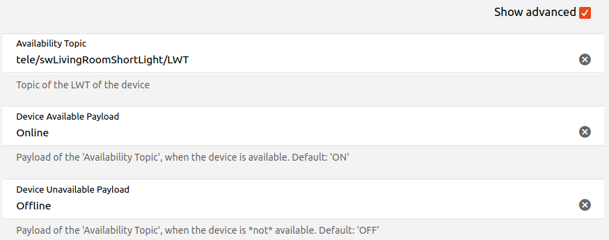

Configure the availability topics - this ensure that openHAB knows whether the device is online.
Click on Show advanced. For Tasmota devices, the Availability Topic is usually tele/<TOPIC>/LWT, where <TOPIC> is as configured in the Tasmota MQTT parameters page. Messages that are published are either Online or Offline.

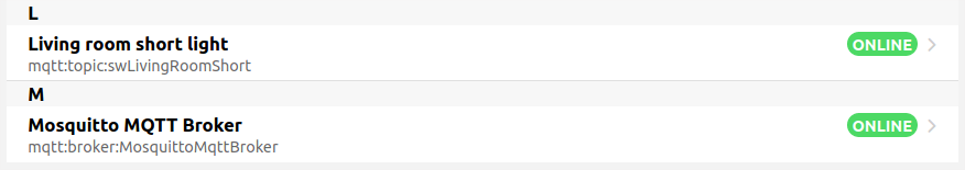

Click Create Thing. Your Generic MQTT Thing will be created and appear in your list of Things. After a couple of seconds, it will appear as ONLINE.

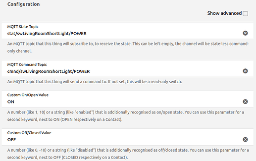

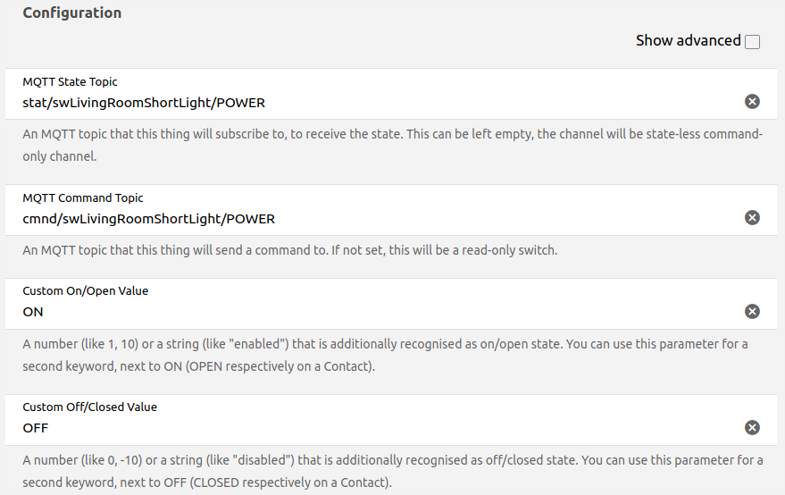

  • MQTT State Topic: If you left Full topic default in the Tasmota MQTT parameters, the State Topic will be stat/<TOPIC>/POWER.
  • MQTT Command Topic: If you left Full topic default in the Tasmota MQTT parameters, the State Topic will be cmnd/<TOPIC>/POWER.
  • Custom On/Open Value: ON
  • Custom Off/Closed Value: OFF
Click Create. The Channel will appear in the Channels tab of your Generic MQTT Thing.

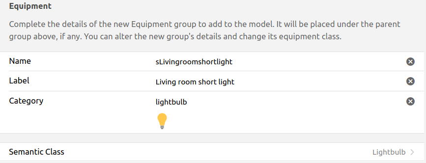

You are now creating an Item. If you have your Model setup, choose the Parent Group. Configure the Item:
  • Name: Item ID used internally by openHAB. No spaces allowed.
  • Label: Friendly name for the Item. Spaces allowed.
  • Category: lightbulb. This is used for the icon.
  • Semantic Class: Lightbulb
Link the previously created Power Channel to the Item by selecting it. Configure the link:
  • Name: Link ID used internally by openHAB. No spaces allowed.
  • Label: Friendly name for the Link. Spaces allowed.
  • Type: Switch
  • Category: Select the category to use for the icon.
  • Semantic Class: Switch
  • Semantic Property: Light
Click Add to Model. You can now control the switch from your Item.

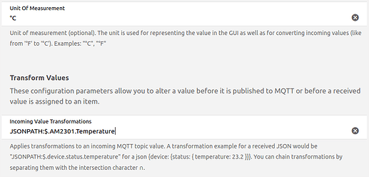

6.2 Create two new Number Channels
Click Add Channel within the Channels tab of your Generic MQTT Thing.
add_channel_to_thing

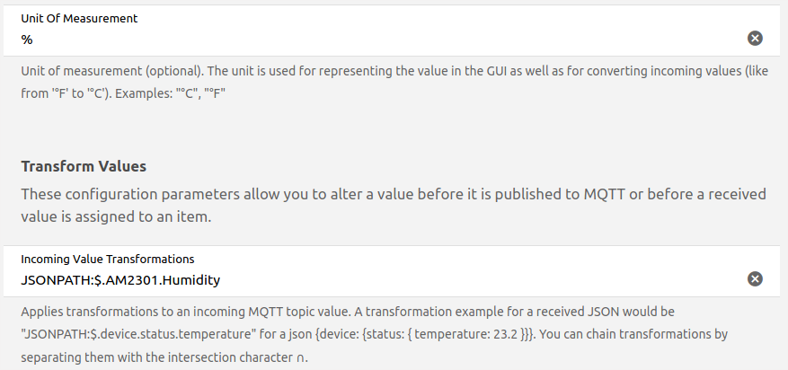

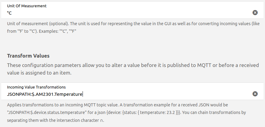

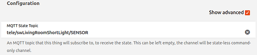

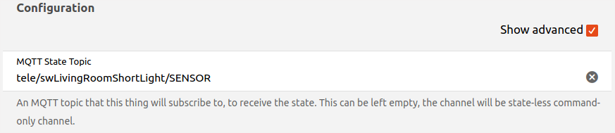

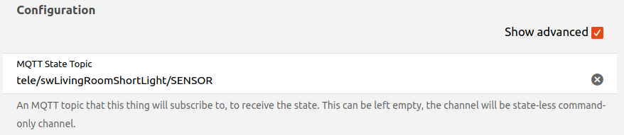

Configure as follows. YAML Code is below the images. Only fields which need modification are shown in the screenshots. Note that Show advanced is selected.
6.2.1 Temperature Channel
YAML Code
  - id: temperature
    channelTypeUID: mqtt:number
    label: Temperature
    description: ""
      stateTopic: tele/swLivingRoomShortLight/SENSOR
      transformationPattern: JSONPATH:$.AM2301.Temperature
      unit: °C
6.2.2 Humidity Channel
YAML Code
  - id: humidity
    label: Humidity
    description: ""
      transformationPattern: JSONPATH:$.AM2301.Humidity
      unit: "%"
