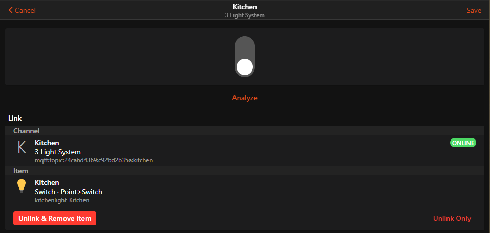

I have been working on getting my openHAB to connect to my mosquito broker and then connect my Arduino to the broker to receive the data. I have set up openHAB Thing Channel and Item with the help of this article, [OH3] Tasmota relay via MQTT (Sonoff Basic with optional DHT22) although I am unsure if I have done it correctly.

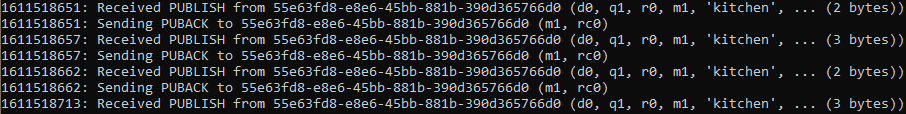

and when clicking the switch the broker responds I was wondering if when writing my Arduino code if I use the .subscribe(“kitchen”) function to subscribe to the topic of “kitchen” in my case. If that is the case how would I format the code to know if it is receive the ON or OFF command of the switch?
Unfortunately your log from Mosquitto is truncated, so we can’t actually see what the full entries are. Can you grab from the Mosquito log file and copy/paste into your OP inside code fences?
Another option is to install the 3rd party MQTT Explorer or mqtt.fx to monitor what’s being published.
