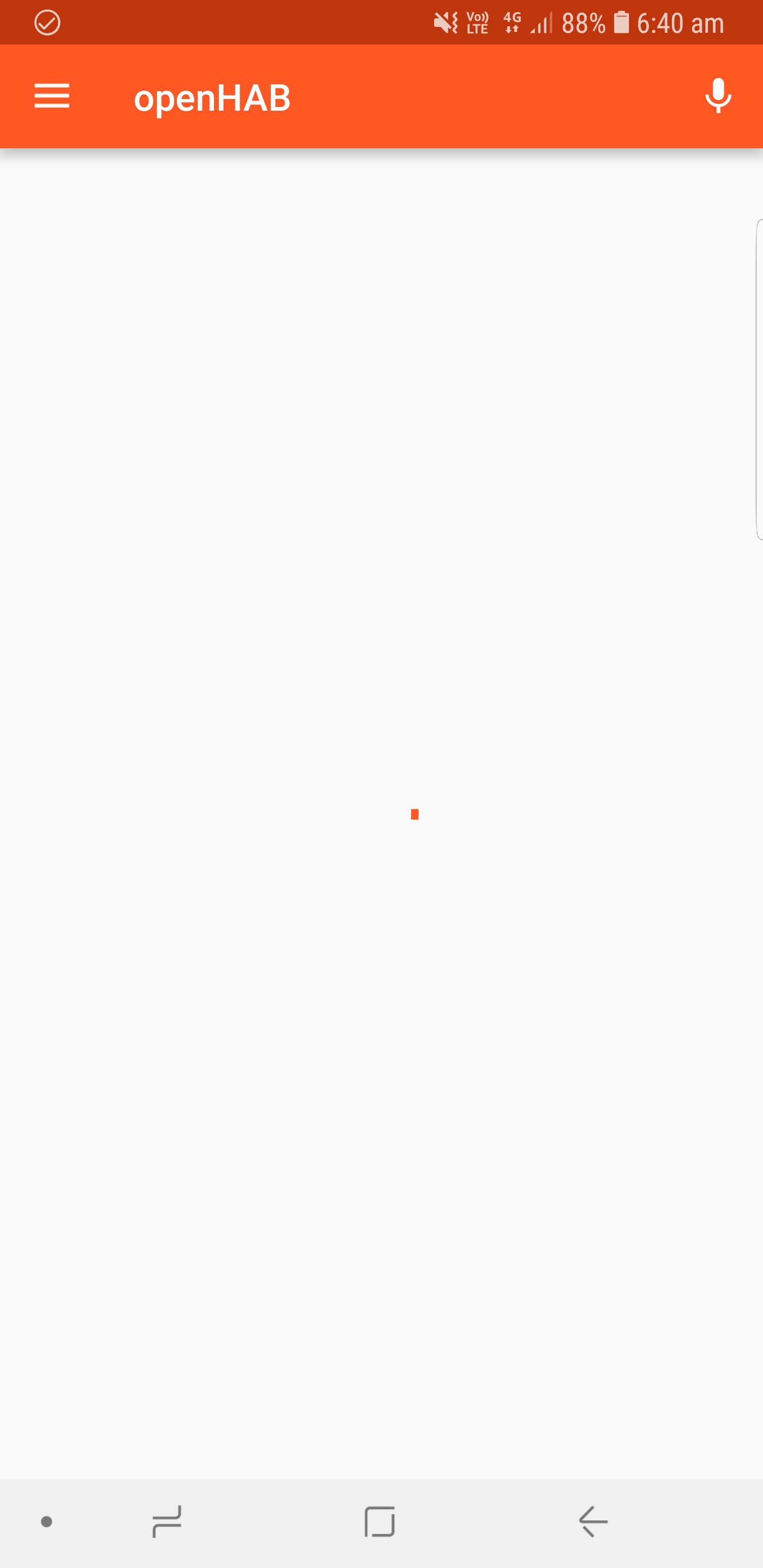

When I configure the OH2 Android App, for ‘REMOTE’, I enter https://serverurl with my OH2 username/password, the app just sits there with the egg timer.

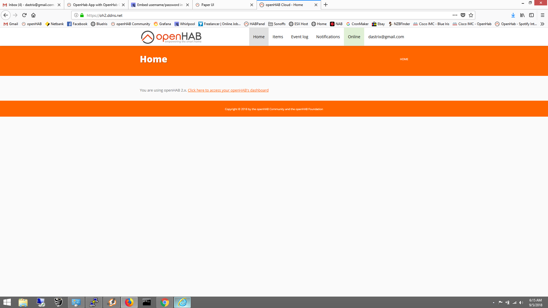

This is the link that doesnt work..
Yes, I did get a letsencyrpt cert. Accessing OH2 Cloud via https://domain name, successfully works to the Openhab cloud login page.
When I right click on that ‘CLICK HERE TO ACCESS’ link, and inspect the URL it shows: https://192.168.0.3:3000:443/start/index
So you cannot in fact access your OH through your installation of openHAB Cloud. When you click on the “click here to access your openHAB’s dashboard” if fails to bring up the dashboard page?

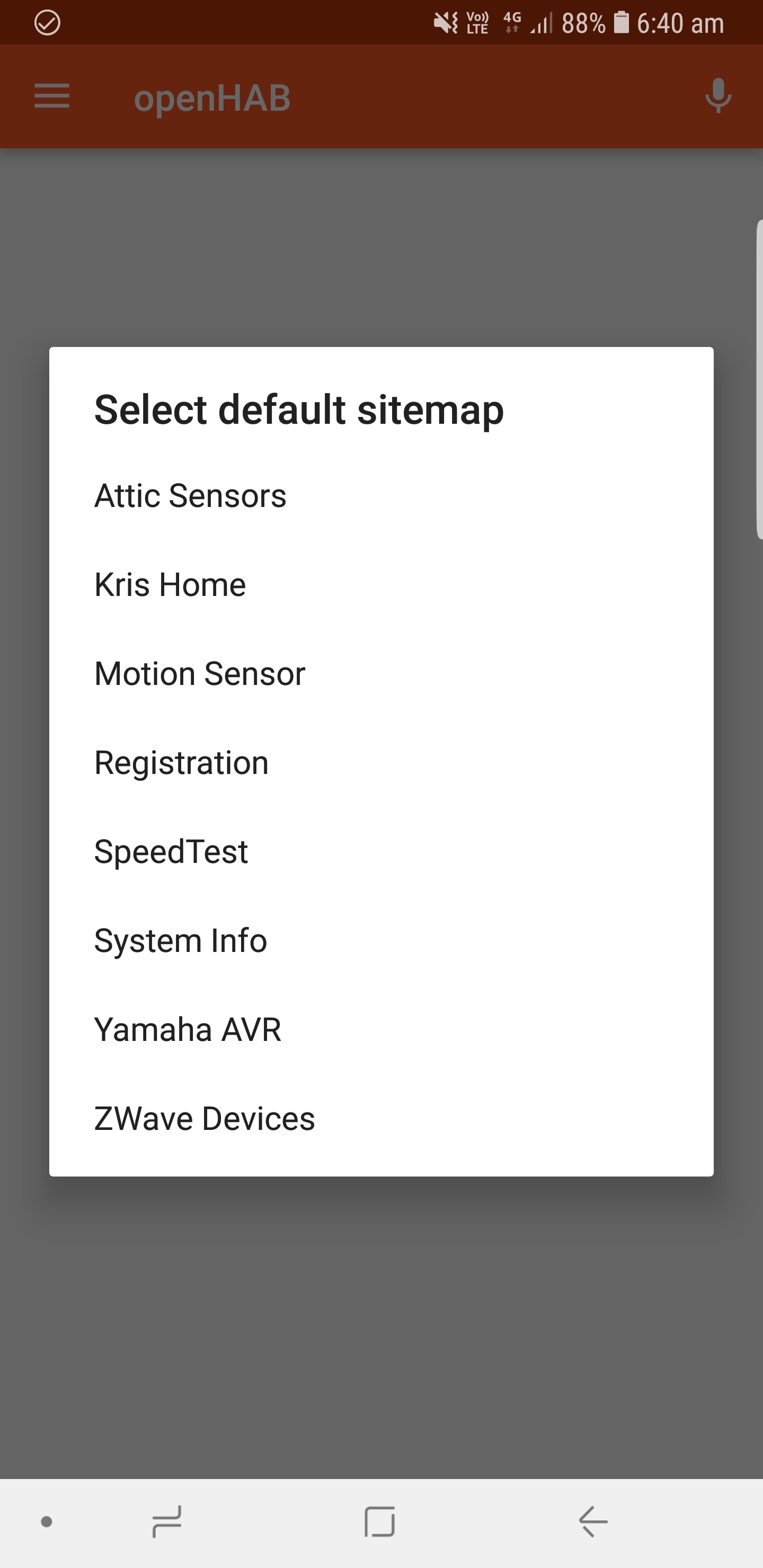

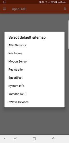

Unfortunately, the Android App still wont show the contents of the sitemaps (it shows the sitemap names!)
Select one of the names and it should bring that sitemap up. You can set the default sitemap in settings.
Ha im not that slow :wink: i do that but it wont display the contents of each sitemap im afraid. More digging…
So the dashboard link now works remotely in OH2 Cloud, but the Android App refuses to connect despite showing me the sitemaps! So odd
