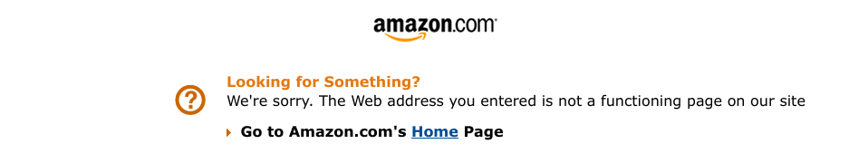

I tried setting this up here (I’m located in the US) and am unable to get past step 3b of First Steps. I tried logging in at the URL on my OH2 instance, but after successfully logging in per step 3b from the README, amazon complains as follows:
Bridge thing status is unchanged:
amazonechocontrol:account:account1 (Type=Bridge, Status=OFFLINE (CONFIGURATION_PENDING): Please login in through web site: http(s)://<YOUROPENHAB>:<YOURPORT>/amazonechocontrol/account1, Label=Karns Amazon Account, Bridge=null)
I am running openHAB 2.4.0~20181115123158-1 (Build #1425). I manually copied org.openhab.binding.amazonechocontrol_2.4.0.201811041600.jar to /usr/share/openhab2/addons. I enabled DEBUG logging for the binding, but no errors or warnings appear in the log when I sign on to my Amazon account.
