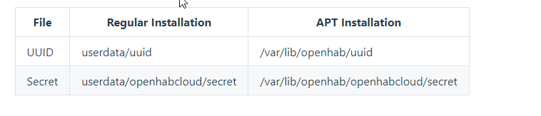

I don’t seem to have these files in these directories;
Even if i did; where would i enter them; i dont see a place to enter them

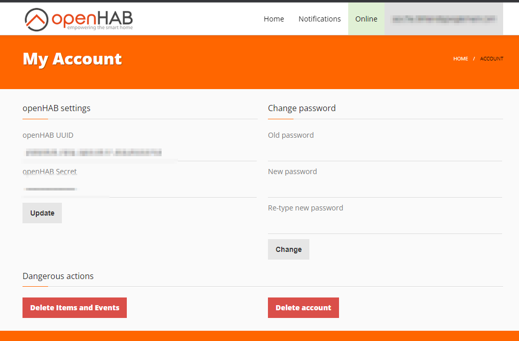

Well, you need to enter them on myopenhab.org:
And on openhab2, the directories might be /var/lib/openhab2…
If the directory structure is different in an ubuntu environment, you probably might want to search for the files
Thanks for that screenshot.
There are no var/lib/openhab2 directories that screenshot is all that exists on my OS under /var/lib
It appears I have those already in there; so it’s not that.

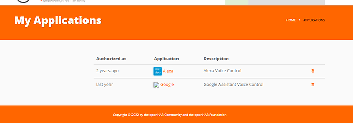

Is google home listed as a application on myopenhab:
Is you openhab installation based on a deb package, on a tar file or do you use a docker instance ?
Depending on the type of installation the location of UUID and secret is different.

They are not listed on openhab(which is why i think that is why google can’t find them)
Google home is not listed as an application; i would assume that happens the first time it successfully connects/gets items

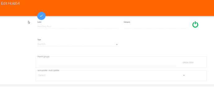

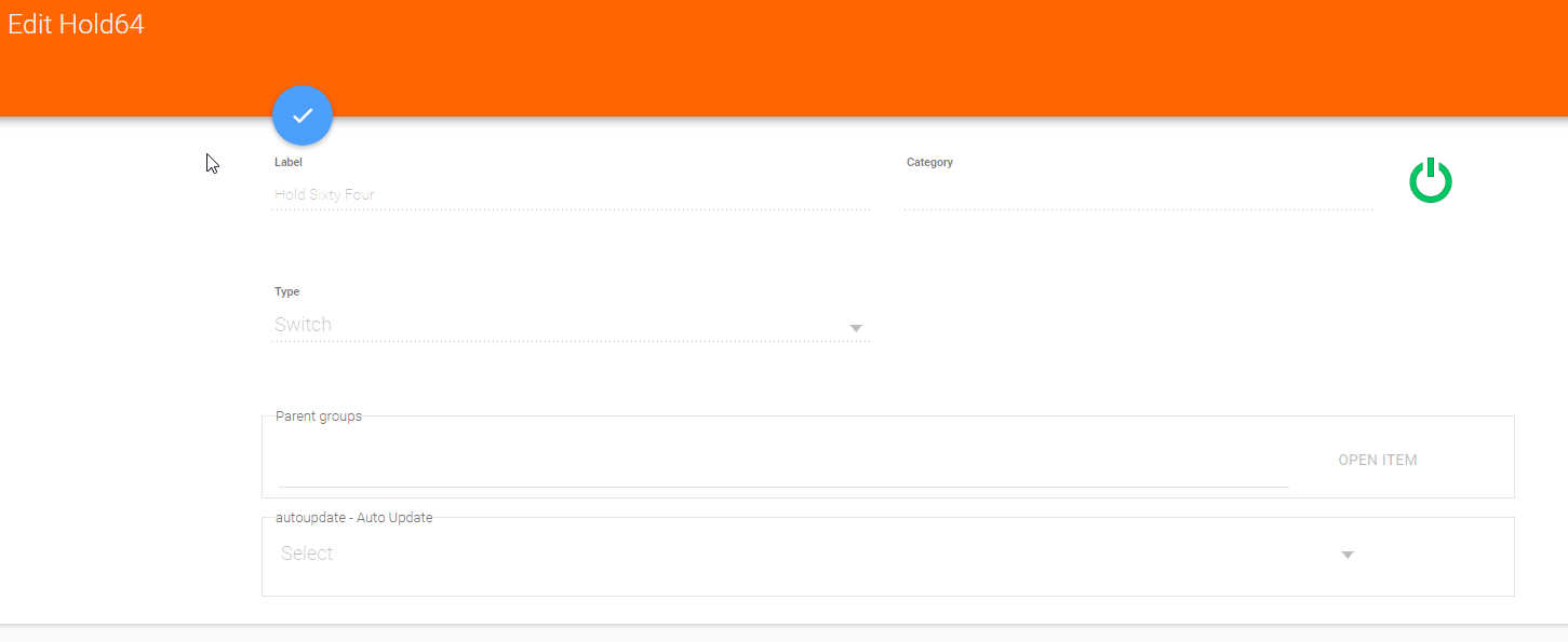

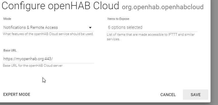

In PaperUI, here is what i have
So i see i can add that to the item in a text editor

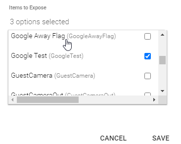

In Paper UI we can see it’s exposed:

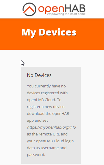

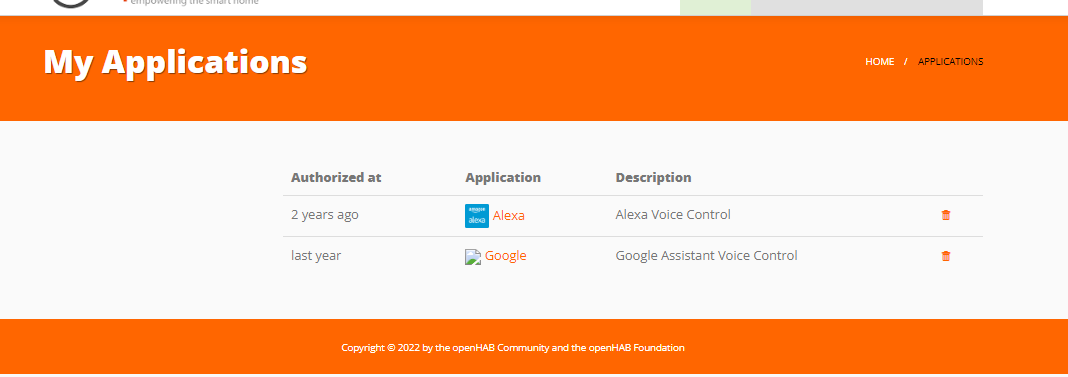

Back to openhab cloud; no devices:

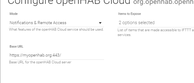

I have the right URL in the settings:

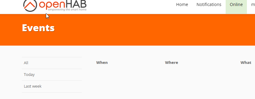

All you’ll ever see in the Events on myopenhab.org is your openHAB instance connecting and disconnecting. You won’t see your Items or anything else there. The only thing you’ll see that shows that connection was successful is under Applications which will show “Google Assistant Voice Control” and your Google Home app will list a device for each Item you’ve added valid ga metadata to.
FYI, you don’t need to worry about “Items to Expose” in PaperUI. That doesn’t have anything to do with Google Assistant. It’s actually there for integration with IFTTT, which was removed a couple of years ago due to issues it caused the cloud server.
Nothing you do with “Items to Expose” will have any impact on your system or cloud connection, and nothing you do in item configuration will be reflected on that screen. It’s all in the metadata now.

The Item metadata. There used to be support to expose Items through the Cloud Connector add-on (there probably still is on that old version of OH) but it has long since been turned off in the cloud server. It was only ever used by IFTTT.
It still exists in OH3’s MainUI, in case someone wants to run their own cloud server. But mostly it just causes confusion for people who assume (quite reasonably) that it’s required for Alexa and Google Assistant.
