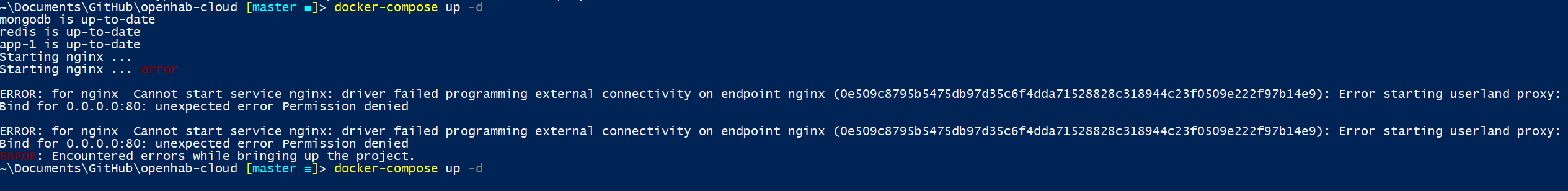

I “solve” this. There was a port conflict. I am already using port 80. So I map port 80 to port 85. Would that be any problem?

Anywho, I get errors from the mongodb container with the exit code 100.
Error while connecting from openHAB-cloud to mongodb: MongoError: getaddrinfo ENOTFOUND mongodb mongodb:27017
and
Error while connecting from openHAB-cloud to mongodb: MongoError: connect EHOSTUNREACH 172.22.0.4:27017
docker ps gives me: Knipsel
So, as you see, most probably it has to do with the config.json
Hope you can help to give me a nice containerized openhab-cloud expierence! Thanks
