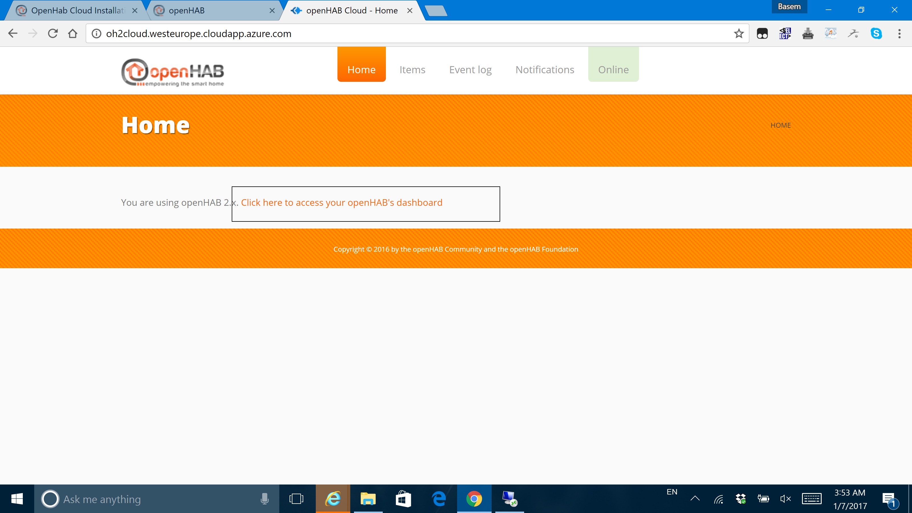

hello @MARZIMA, thanks for your support, apparently my cloud connector is configured with the right URL, this is why i can see my items status there and see my openhab online, only when i click to access my openhab it redirects me to https://home.myopenhab.org/start/index please check the attached screenshot, i just hided my personal email
thanks again for your help :slight_smile:
looks good! Yes that shouldnt be like that. Will open an issue at github. There it should redirect to “your cloud URL” to access the dashboard.
