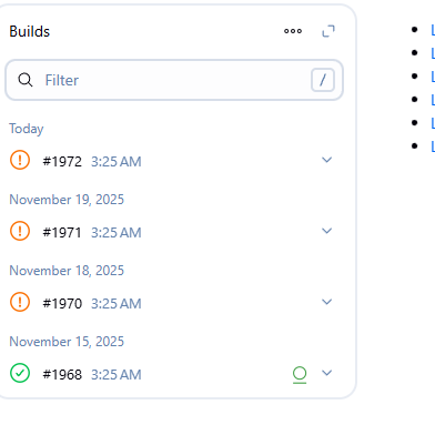

Hum, the explanation must be there.
openhab-addons repository is not currently building in Jenkins
Last ok build version is from November 15 :frowning:
Perhaps due to dynamoDb test failure that occurs since 18 November.
It could explains why the last build are all marked as unstable ?
Laurent.
